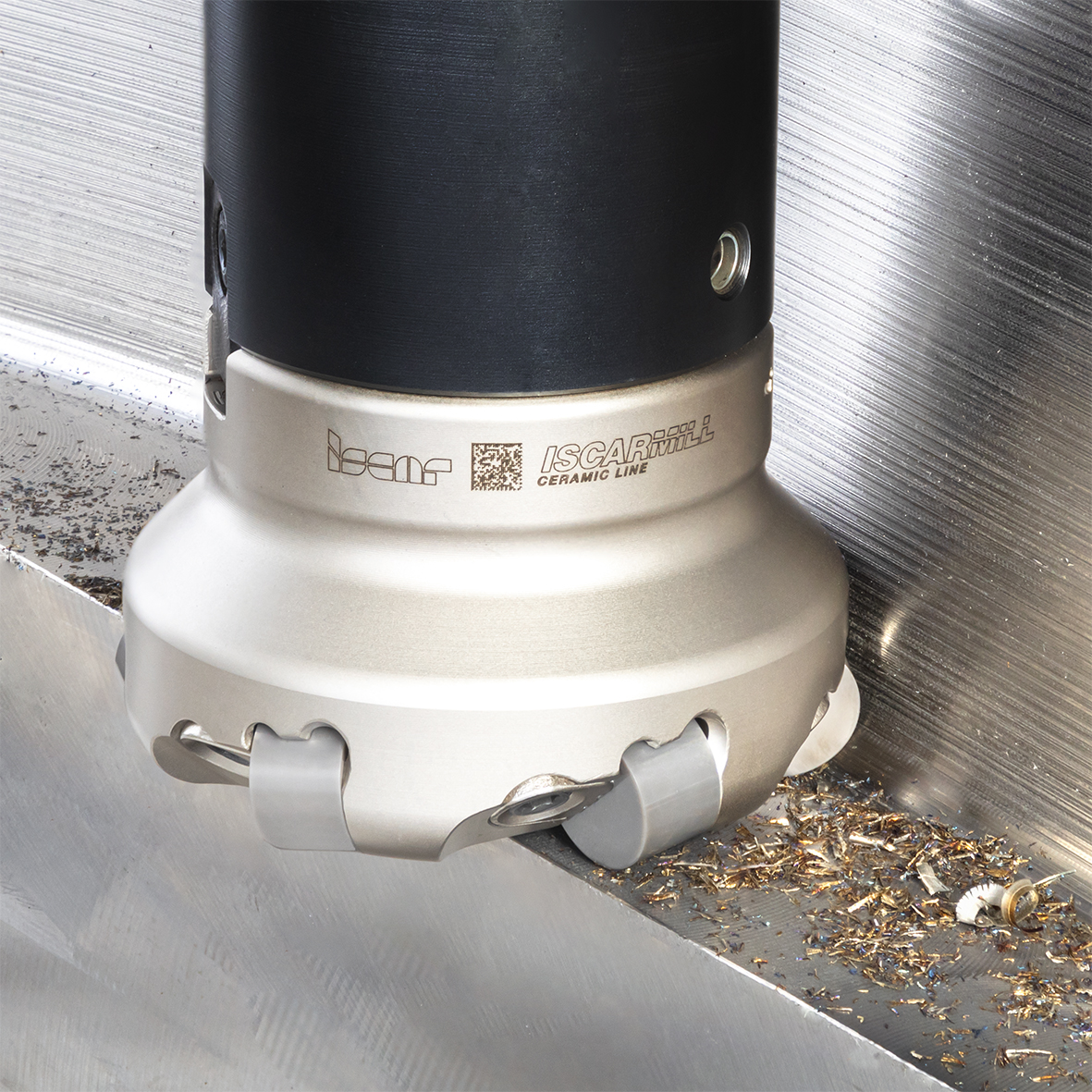

Recently, ISCAR developed a family of indexable shell mills carrying double-sided inserts made from ceramics (Fig. 1). The mills are intended mostly for rough and semi-finish machining of planes and 3D surfaces at extremely high cutting speeds. The economical double-sided insert design provides high ceramic utilisation. The inserts are made from several ceramic grades such as ‘black’ ceramics, whisker reinforced ceramics and SiAlON (a type of silicon-nitride-based ceramic). Applying the new mills is directed at maximising metal removal rate (MRR) and a dramatic reduction in cycle time.
One more example of successful usage of cutting ceramics is another of ISCAR’s latest products: a family of solid end mills from SiAlON. The end mills were designed specifically for productive rough machining of Ni-based superalloys such as various grades of inconel, incoloy and others in the aerospace industry. In comparison with typical solid carbide end mills, SiAlON end mills allow an increase in cutting speed by up to 50 times!
It should be noted that ceramic tools behave differently from carbide tools. Generally, the end of tool life is determined by the acceptable level of surface finish or generated burrs and not by tool wear.
