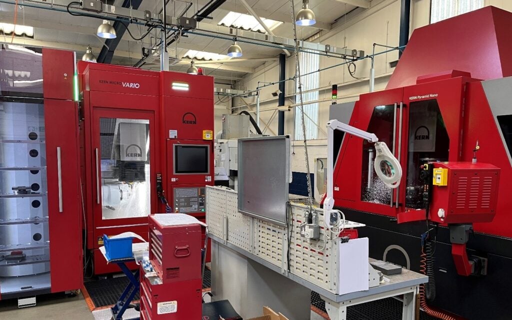

With a skills shortage in the manufacturing industry, WLR Precision Engineering Ltd. had a burning desire to automate its high-precision production while maintaining the skill levels of its highly qualified team of engineers. The opportunity to increase throughput, precision, quality and consistency prompted the Wilford-based subcontractor to purchase a 5-axis Kern Micro Vario machining centre with an Erowa Compact 80 automated pallet loading system from Rainford Precision.
Located just south of Nottingham, WLR undertakes everything from prototype work to small and medium batches for manufacturers in the oil exploration, medical and pharmaceutical sectors, to name a few. As a company ‘dedicated to precision’, the ISO: 9001:2015 certified manufacturer is already an existing Kern user, reaping the rewards of unparalleled precision and performance. In 2013, WLR installed a Pyramid Nano machining centre. Discussing why WLR invested in its second Kern machine, the automated Kern Micro Vario, Kevin Callon, Managing Director at WLR, said: “One of my regrets was not having some form of automation on the Pyramid Nano when we first bought it, despite having the option. There was no way we would have bought another Kern without some form of automated loading to maximise the running hours of the machine.”

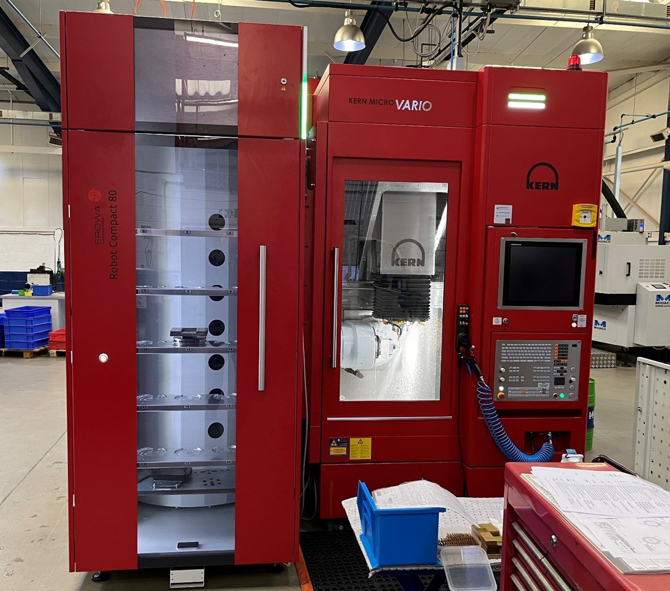

Based on the precision of the Pyramid Nano, this regret was founded upon the realisation that the company needed extremely precise machining capacity for a range of higher quantity runs of extremely accurate components. With an 80-component Erowa pallet loading system and a 90-position automatic tool change, the Kern Micro Vario was the perfect solution.
Installed in September 2022, the introduction of the automated Micro Vario now enables WLR to run production continuously ‘lights-out’ whilst utilising the existing Pyramid Nano for smaller batch runs and one-offs during daytime working hours.
Kevin explained: “The consistency of the components produced on the new Kern is amazing and repeatable to the micron. The precision is so impeccable that we now channel as much work as possible through the Kern Micro Vario. It’s not only doing the really demanding high-accuracy work that it was purchased for but also undertaking the less demanding work that would normally be done on less precise machining centres.”
The Kern Micro Vario precision and repeatability are built upon the foundations of its thermally stable Ultra-High-Performance Concrete (UHPC) base that yield precision and repeatability of <1.5µm and <1µm, respectively.
From a specification perspective, the Kern Micro Vario has a compact X, Y, and Z-axis work envelope of 350 by 220 by 250mm, a -110° to +110° swivelling B-axis, and a 360° continuous C-axis. The tool changeover is less than 3 seconds, and the chip-to-chip time is 4.5 seconds – all feeding a high-speed 42,000rpm HSK 40 spindle. Incorporating the powerful Heidenhain TNC640 CNC control, 30m/min rapid rates and acceleration of 10 m/s², the Micro Vario demonstrates astounding flexibility, speed and precision in a compact floor area.
