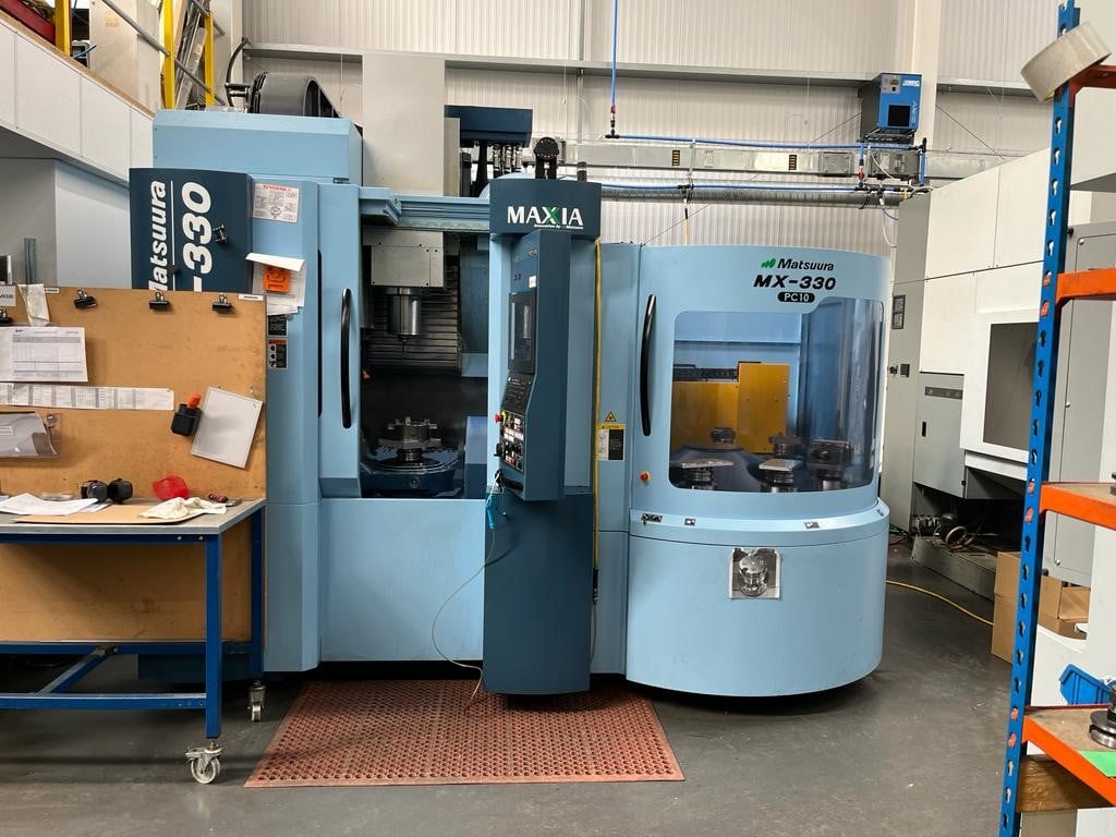

Working to ISO: 9001 and AS: 9100, Tml has invested in multi-pallet 5-axis machine tools from Matsuura and DMG MORI, mill/turn centres and turning centres from Nakamura-Tome (ETG). With extended unmanned machining, Tml was looking to improve tool life whilst reducing cycle times – an initial market review led to ITC being chosen to deliver the results based on service capability and technical support.

The most impressive result to date has been achieved on a large EN8 component for the entertainment industry that requires 77% material removal – taking the part from 9kg down to just 2kg. On the rough facing of the component, Tml was previously applying a face mill, which was yielding a roughing cycle time of 1.5 hours. The ITC engineer swapped out the face mill for an ITC 16mm diameter 6054-16 Series 6-flute end mill with a chipbreaker. With a 50mm flute length, the 6054-16 Series cut at a full 50mm flute depth with a 0.8mm stepover and a cutting speed of 4777rpm. Cutting with such aggressive material removal rates on a Matsuura MAM72, the stability of the end mill was further enhanced by a BIG KAISER HMC chuck that demonstrates complete face and taper contact for maximum rigidity. The combination of the BIG KAISER chuck and the 6054-16 Series end mill cut the roughing cycle from 1.5 hours to just 15 minutes – and with a quantity of 60 parts, the cycle time reduction is equal to more than 3 days of machining.
