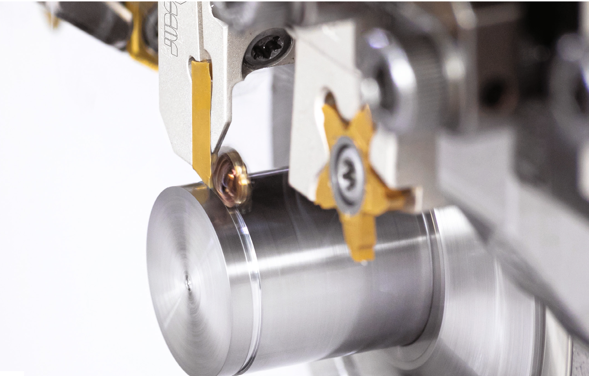

The LOGIQ-6-TURN (Fig. 3) is a newly designed triangular insert that offers a cost-effective solution for semi-finish and finish turning with a focus on achieving high surface quality. This double-sided insert features a 55° corner angle and positive rake cutting geometry, providing 6 indexable cutting edges. It presents a significant alternative to the standard ISO-type rhombic insert of DCMT type, which only offers 2 cutting edges. One key advantage is the ease with which LOGIQ-6-TURN inserts can be mounted on turning tools designed for triangular TNMG inserts.
Maximising profitability through the efficient use of raw materials during the parting process is crucial. ISCAR’s highly regarded DO-GRIP parting and grooving family has recently grown with the addition of three new sizes of double-sided inserts. This has been specifically designed for narrow parting operations (Fig. 4). These inserts are primarily targeted for Swiss-type lathes, enabling optimal material savings when parting small-diameter bars, tubes, and thin-walled workpieces.
