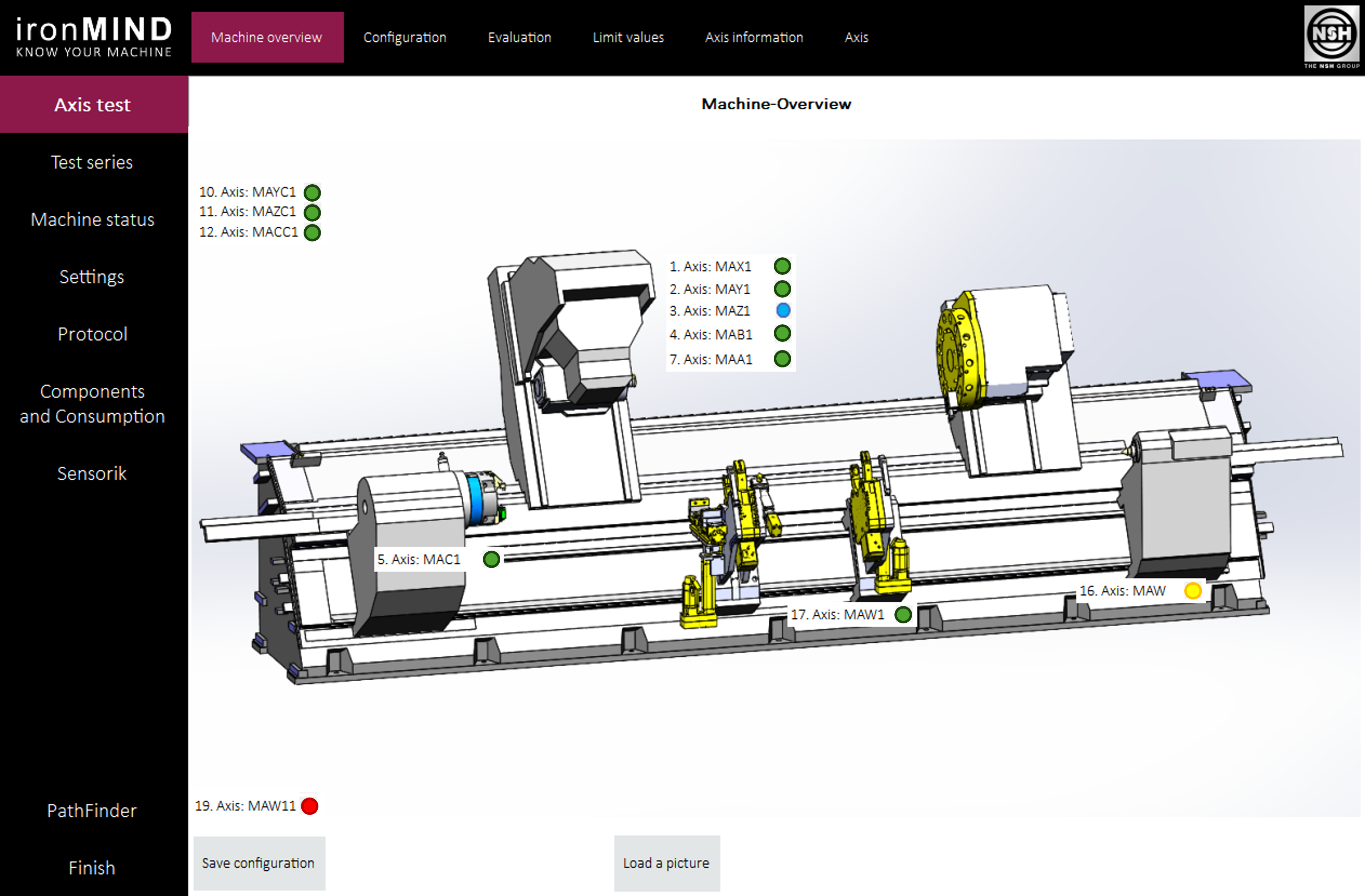

Monitoring is often interpreted differently. One way is to collect and analyse data. NSH goes further, monitoring operating resources, consumption, drive temperatures or control status, it also undertakes regular tests on axes to examine axes condition. For each axis test, one axis is subjected to a specific motion profile. Drive data is recorded during these defined motions and is followed with the structured evaluation of the data. How does potential damage manifest itself in the data? What parameters need to be calculated for condition-based evaluation? How to define the limits that characterise the condition?
Answering these questions requires information about the parts installed, the control system, and the machine data set – in-depth knowledge that the manufacturer can provide. It also requires knowledge of the test results and experience in identifying damage. ironMIND supports users in performing condition-related data and tests themselves. This diagnosis can be made with regular automated test execution and successful condition-based maintenance.

The machine operator can use ‘ironMIND – Monitoring’ on the control panel, supported by an intuitive app and multi-window technology. All other departments can use the ‘ironMIND – Cockpit’ to log into the web front end with access from any device.
