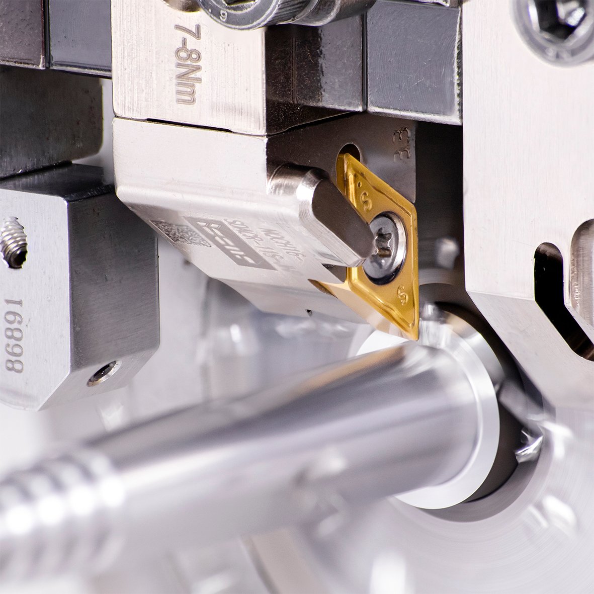

A modular tool concept is the way to reach high versatility. NEOSWISS is a new tool system with quick-change heads that follows this concept. The system is suitable for turning, parting, grooving, and threading applications. By use of a high-clamping-force mechanism, the heads are mounted on a toolholder. The mechanism provides an accurate cutting-edge position each time and utilises high-position repeatability. The system intended mainly for Swiss-type machines enables the removal of heads and replacement inserts within the tight confines of CNC machining centres.
