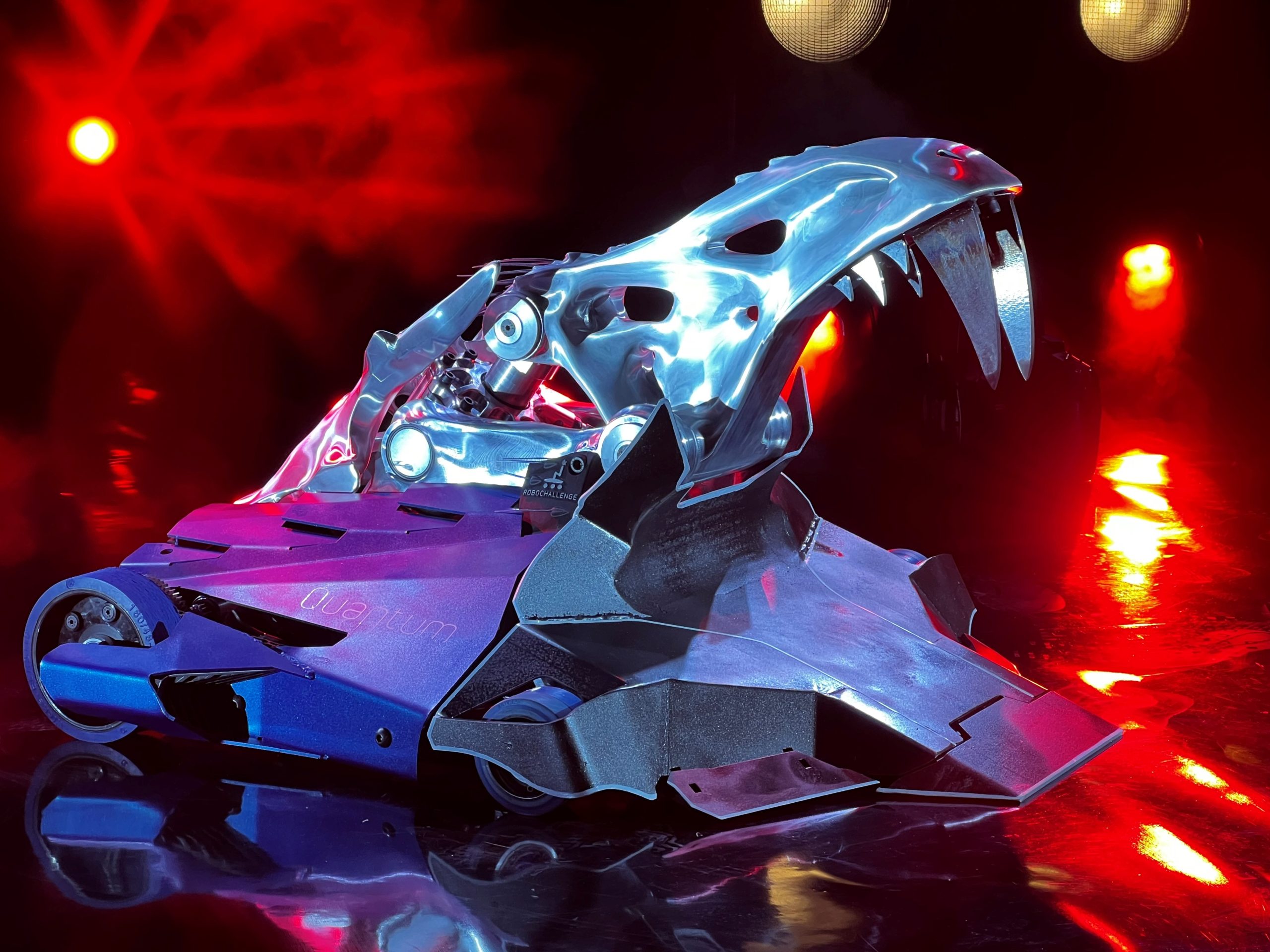

Looking at a crushing jaw part being machined on the Quaser MV184EH machining centre for a new fighting robot, Guhring UK’s Chris Bush says: “To get an impressive surface finish on this 7075 aluminium component, we are applying a PCD ball nose cutter that is manufactured at our facility in Birmingham. This HPC tool holder provides high runout accuracy and deals extremely well with the radial forces during machining.”
Adding to this, Grant Cooper says: “For this robot, we need at least two custom tools. One is a 6mm ball nose PCD. As we are running this with a 4th-axis rotary unit, we are running 3+1 toolpaths, so we are cutting a lot of the part with the centre of the tool. The tool is custom-made, so we do not get swarf clogging on the tip of the tool. We have through coolant on the tool to make sure the cutting edge is clear at all times – this gives us stunning surface finishes. Another critical factor that we found, is the toolholders. We found a massive difference between running ER holders and side locks. Our favourite is the Guhring HPC toolholder, the versatility is excellent. We use a lot of shrink fit in various areas. However, this gives us amazing versatility of different collet sizes, so we don’t need to have 20 or 30 of these toolholders. We can have just five or six and we can still run most of our tooling. Most importantly, the runout is very low – it’s around 3µm on these toolholders. They have excellent repeatability and the clamping force is exceptional. They are better than anything we have ever had, and that includes hydraulic holders. That is why they are used for virtually every milling process.”
