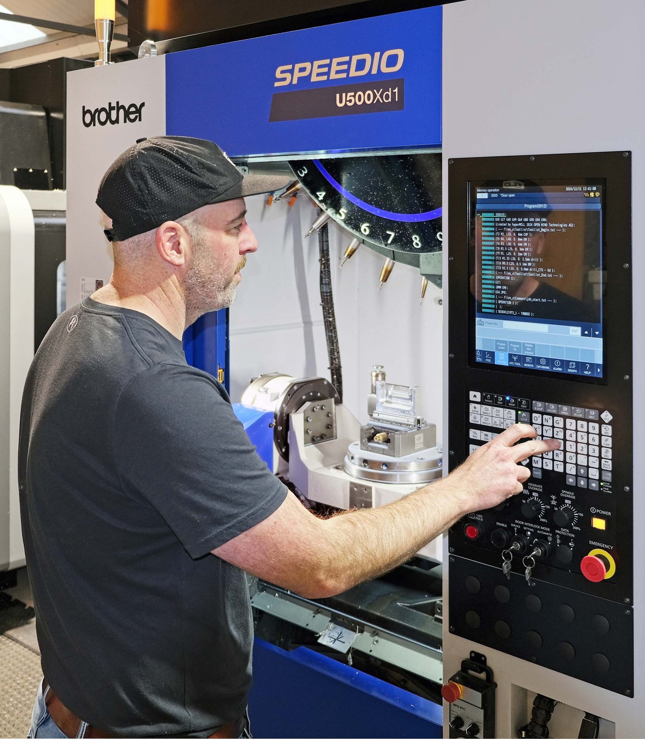

Michael Phillips, joint owner with partner Wayne Robins of contract machining firm Atomic Precision, describes their recently purchased, Japanese-built Brother Speedio U500Xd1 as ‘a Swiss army knife of 5-axis machining centres.’ His comment is due to the 30-taper machine’s high quality, versatile functionality, compactness, and ability to complete an extensive range of jobs quickly and efficiently. Brother machines are sold and serviced in the UK and Ireland by Whitehouse Machine Tools, Kenilworth.

As a first step to raising productivity, Whitehouse Machine Tools installed and commissioned the high-speed Brother U500Xd1 in September 2024. The partners learned of the machine at the Southern Manufacturing exhibition in Farnborough in early 2023. The order was placed after early hesitation regarding the smaller spindle interface, which later proved to be a non-issue and benchmarking a couple of other 30-taper machines on the market.

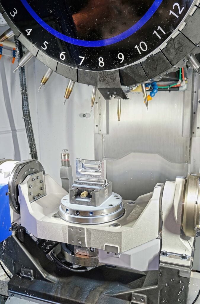

Mr Phillips commented: “The area taken up on our shop floor by the U500Xd1 is half of the space that one of our 40-taper 5-axis machines occupies, yet the 30-taper VMC produces larger parts. Not only that, but the Speedio finishes an identical component in two-thirds of the time, as the non-cutting elements of cycles are incredibly short, so tools are in-cut for typically 90% of the time during a cycle.”
“The linear axes accelerate at 2.2 g up to 56m/min, and chip-to-chip time is 1.3 seconds. Rotary positioning by the trunnion and table is similarly fast, and parts come off complete, resulting in rapid floor-to-floor times.”
The machine installed in East Hendred is a well-specified version of the Speedio model, with a 16,000rpm 15kW spindle, 28-position tool turret, high-pressure coolant, and Blum tool and part probing. Axis strokes are 500 by 400 by 300mm, but multi-face machining of components up to 500mm in diameter by 270mm high and weighing up to 100kg is possible owing to the layout of the machining area.
As well as producing parts up to the maximum working envelope, the Speedio also machines tiny components requiring complex features cut with a 0.2 mm diameter end mill, hence the decision to opt for the highest speed spindle Brother offers. Towers are extensively used for fixturing multiple smaller parts to extend the walk-away time from the machine if individual cycle times are short. Batch size is usually up to 10-off, although often single prototypes are machined.
