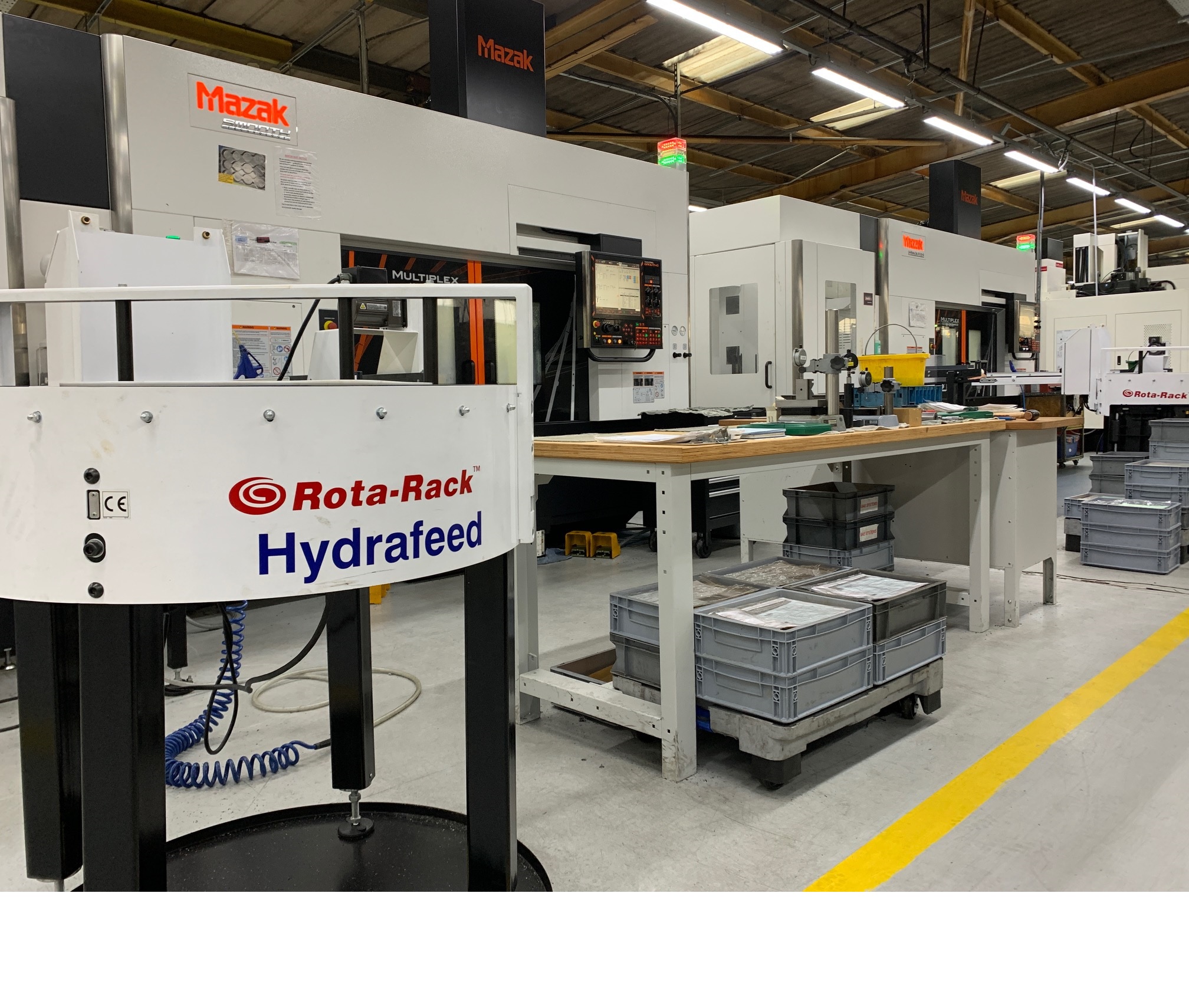

GW Martin in Eastleigh is a subcontract manufacturer that has invested heavily to fulfil its growth ambitions with two twin-spindle twin-turret Mazak Multiplex and two CMZ turning centres, all installed in the last two years. The four mill/turn machines are all highly automated with gantry loading, which emphasises the importance this Hampshire company places on providing the utmost in service, precision and quality. To support this level of investment, GW Martin has also invested in CAM software from Esprit CAM UK Ltd.
