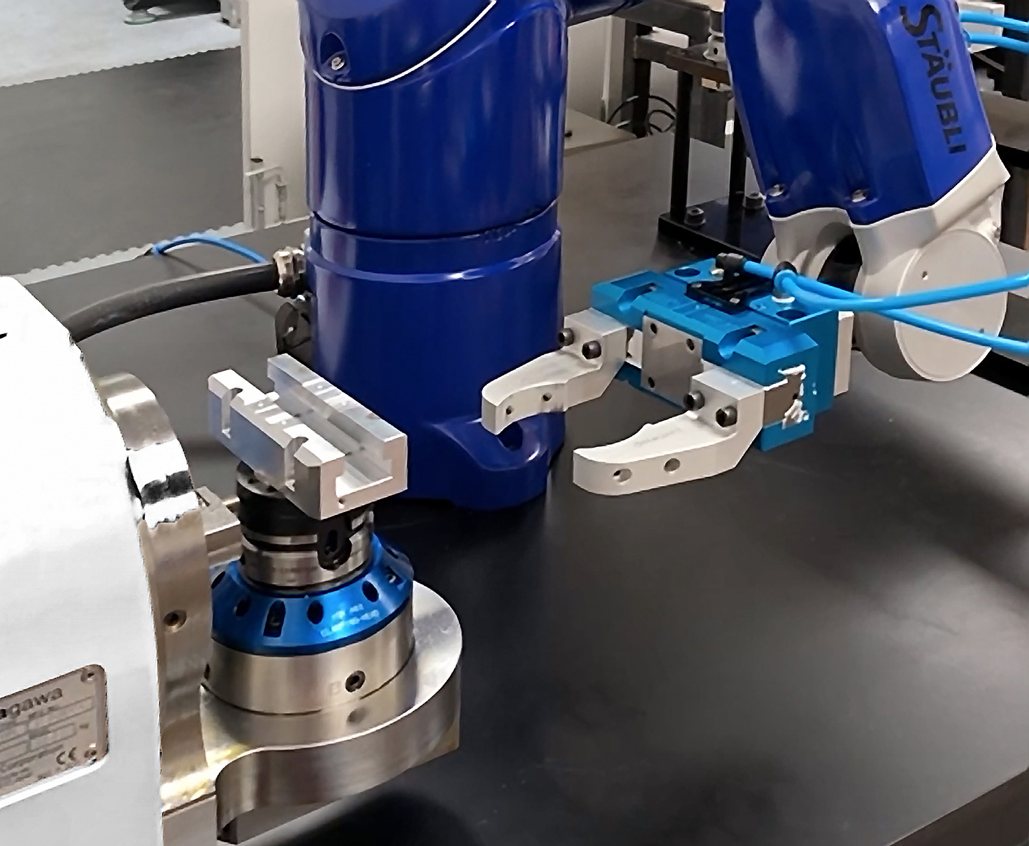

Rotary tables add extra CNC axes
As stated, manufacturers can produce parts cost-effectively with single-hit machining. An additional rotary axis is versatile and can be used horizontally or vertically to provide either a rotational motion or a tilt axis for positioning a part. Options include compound tables to turn a 3-axis VMC into a 5-axis machine, elevated clamping tables, small footprint and high-speed tables, and large through-bore models as well as multi-spindle rotary and tilting tables with accessories for automatic loading. Kitagawa offers all of these options.
The latest range to be introduced is the MK Series, it has two models that add a fourth CNC axis. The larger MK250 has 1,000Nm pneumatically actuated clamping and can support a component or tooling column to a maximum load of 250kg horizontally. If a Kitagawa tail spindle with integral clamp is added for securing the load between centres, clamping torque increases to 1,600Nm.
