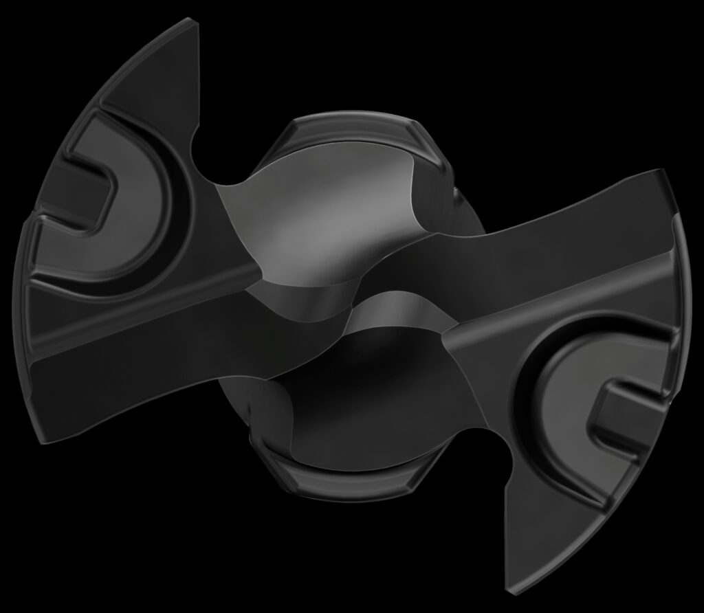

Sandvik Coromant launched the CoroDrill® DE10 in March, offering a universal M5 geometry for more versatile machining. Here, Mikael Carlsson, Global Product Specialist for Indexable Rotating Tools discusses what CoroDrill® DE10 can do.
The CoroDrill® DE10 was developed around three core goals. This was ease of use, robust performance and adaptability. It features a patented tip-to-body interface and a high-strength steel drill body that ensures maximum stability.
A defining innovation is its injection moulded solid carbide tip — a first for Sandvik Coromant. By adapting powder injection moulding, the team engineered a more refined and consistent tool geometry. This allowed for tighter control of the drill’s centre and reinforced corner design.
Another crucial feature of CoroDrill® DE10 is its patented pre-tension clamping interface, which combines familiar design with enhanced security. The interface enables fast and easy tip changes without spare parts, ensures reliable drilling at high feeds and speeds, delivers superior clamping strength and achieves straighter holes. But, benefits aside, a tool needs to prove its worth in real machining environments if it’s to transform how manufacturers approach drilling applications.
