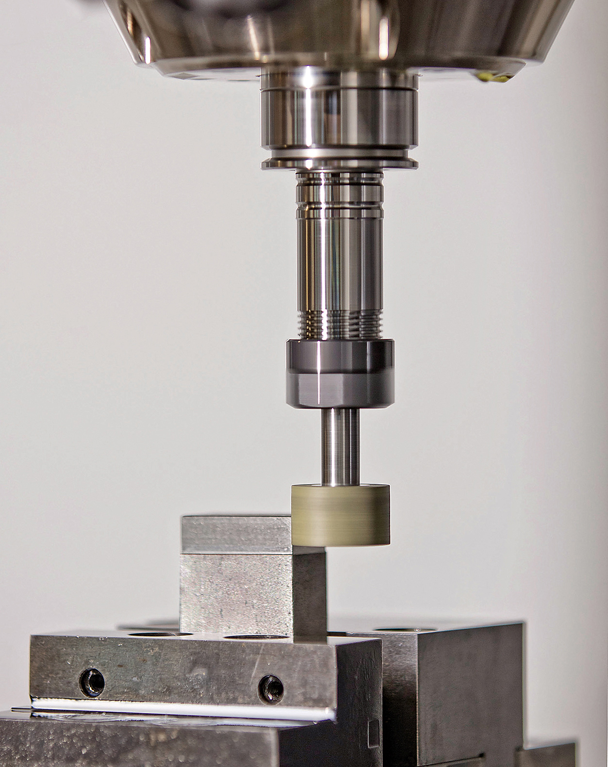

A sample part produced recently in Germany showed just how effective the new milling strategy is. OCM lowered the machining time and raised tool life by a factor of three compared with conventional milling strategies. Control of grinding in one-hit production New grinding control capabilities have also been added by HEIDENHAIN to the TNC640 to extend complete machining possibilities.
The CNC was already able to control milling and turning of components in a single set-up on prismatic machining platforms. However, the latter are increasingly adding grinding capability to extend the scope of one-hit production. At MACH 2020, HEIDENHAIN will show for the first time in the UK that this metalcutting process can also be programmed conversationally and controlled.
