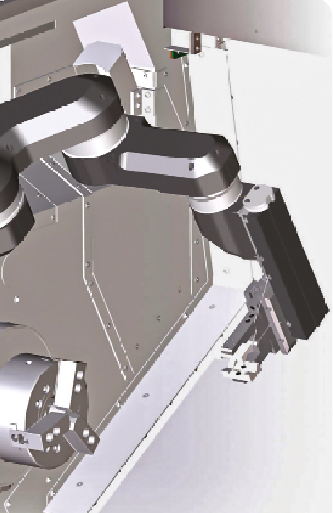

One of the first Okuma lathes to benefit from an internal Armroid (Arm Robot Intelligent Design) workpiece load / unload system is the LB 3000 EX II, one of which is available for demonstration in the agent’s Coventry showroom.
Three different end-of-arm effectors are available for performing different tasks. One is for blasting air or coolant within the cutting zone. It can be programmed to follow the cutting tool for breaking up stringy swarf or to clean down the whole working area, greatly improving chip management. A roller end effector provides support under a shaft component during cutting to minimise chatter.
In combination with a workpiece stacker, the third end effector is a two-finger gripper for automatically holding shaft-type workpieces around their circumference for loading and unloading, weight capacity being 5 kg. All three end effectors are stored within the machine and are exchanged automatically by the robot.
A longer, more powerful Armroid can be integrated into a second Okuma turning centre, a Multus B250II multi-tasking lathe. The robot arm handles workpieces up to 10 kg and possesses a fourth type of end effector with a 3-jaw gripper for holding billets around their end faces.
Armroid systems are ideal for high mix, small batch work. The extended periods of unattended running free the operator to carry out duties in other parts of the factory. The cells are not, however, intended for lights-out production of large quantities of the same part due to the limited number of workpieces that can be accommodated by the stocker.
While most conventional robotic systems require complex integration and special training for staff, Armroid needs neither. As the robot is part of the machine tool, expensive system integration is unnecessary. Using Okuma’s own OSP-P300A control, an operator enters the coordinates for the start and finish points and the robot moves through its motions unerringly. Roid Navi software simplifies programming using images and on-screen guides.
As the machine and robot operate seamlessly and always know where each other are, by enabling the control’s built-in collision avoidance system each cycle is automatically generated while avoiding unwanted interference between the moving elements. In addition to automated running under program control, manual operation is possible via a pulse handle that micro-positions the arm.
