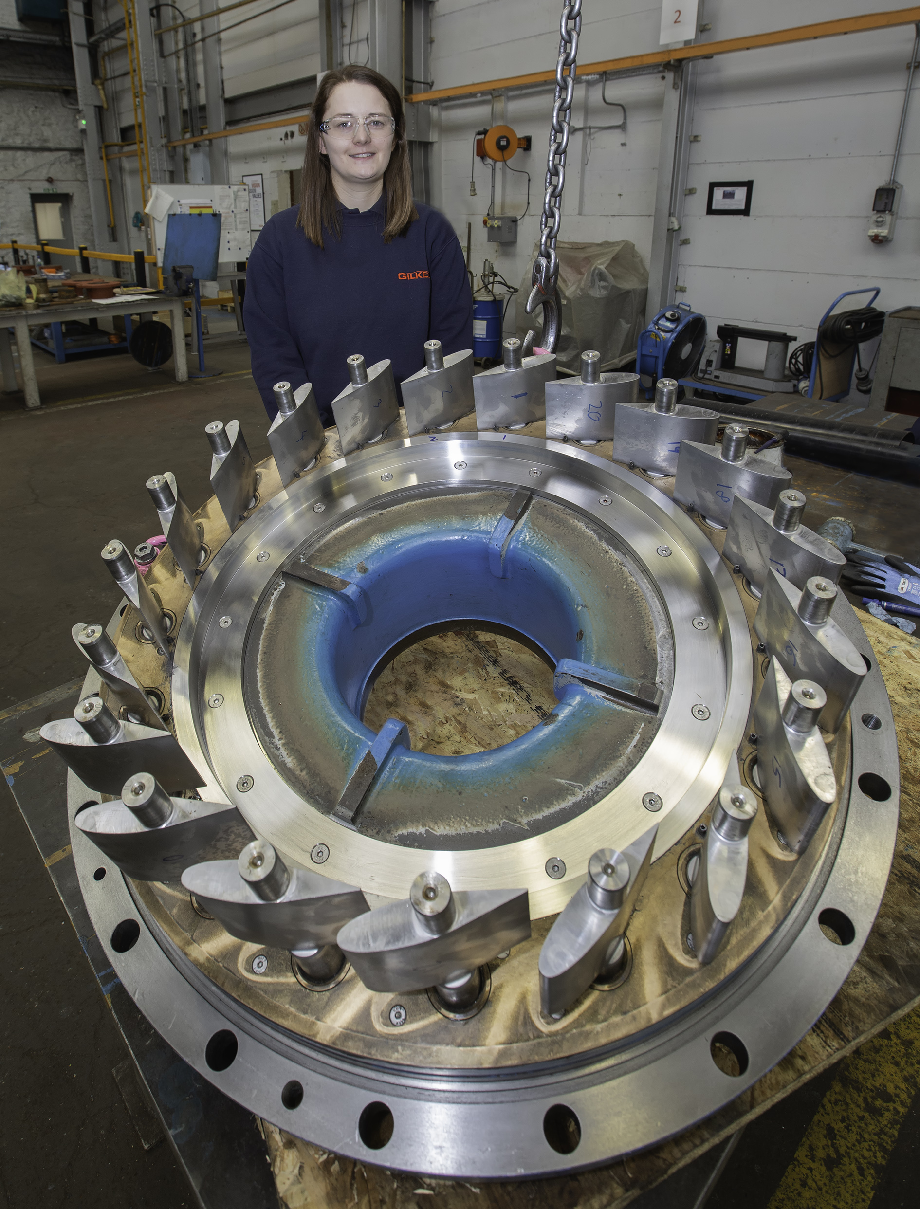

The part in question was a 600mm diameter F35 Super Duplex ring that was subject to abrasion from sediment. To overcome this, Gilkes added a Tungsten Carbide coating, the application of which caused out of roundness, which then had to be machined away. The challenge was how to remove this excess material. Matthew Darbyshire from Ceratizit suggested a new insert grade that would allow us to turn the part on the Mazak.”
The insert was a brand new CBN grade CTBH 40U, which had been developed for turning hardened materials where the intermittent cutting was an issue. Two inserts with cutting data of 210m/min surface speed and 0.12mm/rev feed rate with a 0.25mm depth of cut were suggested by Matt for testing. “The result was superb, just one insert was needed to complete the machining operation and the surface finish was excellent. The insert cut the tungsten carbide coating like a dream,” says Production Engineer Justine Marshall.
