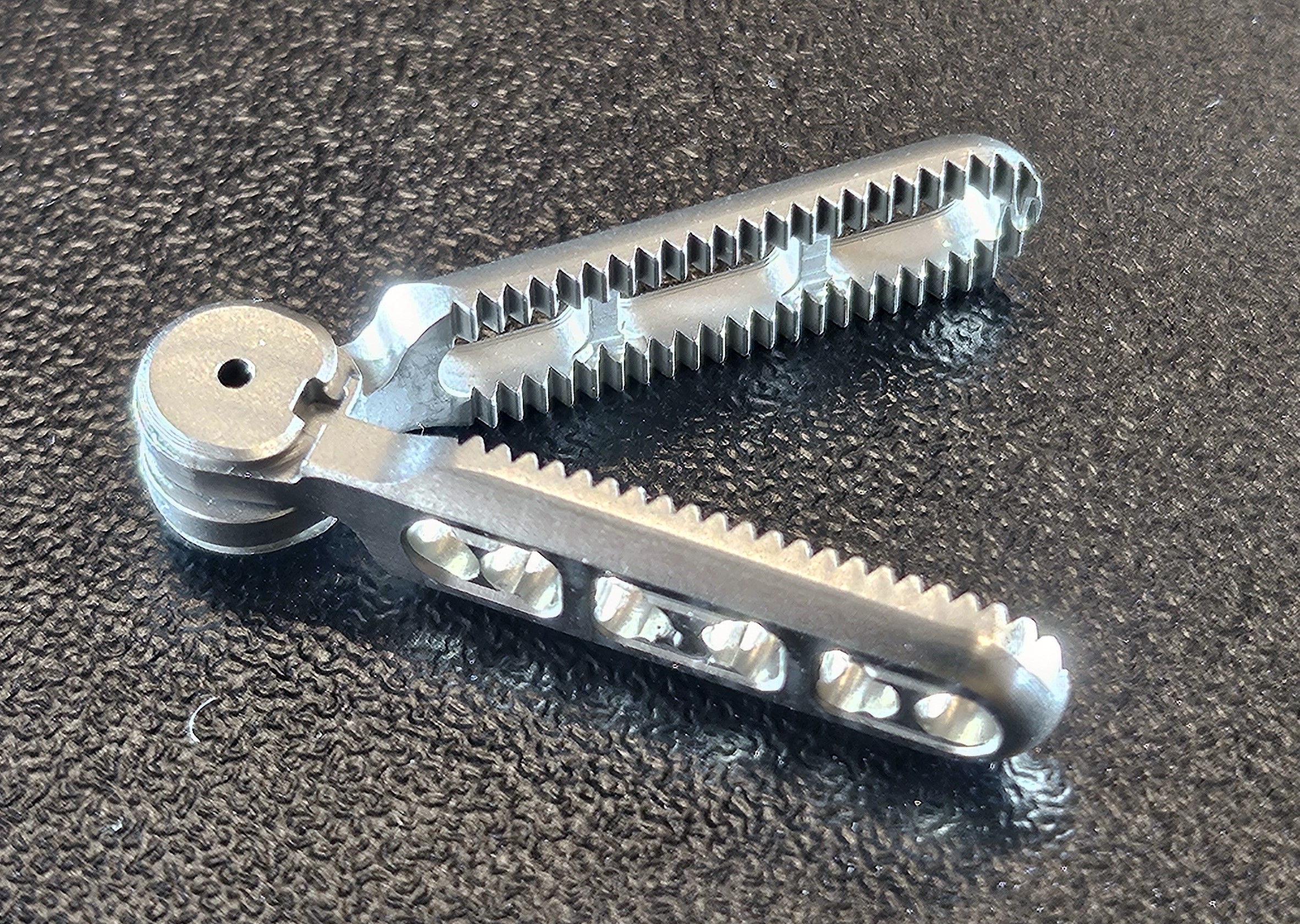

It is here that the search for a suitable machine led Dawnlough to purchase a Bumotec 191neo FTL-R in June 2022. Discussing the acquisition, Keith recalls: “We had several components we initially targeted for this type of machine.”
“We needed a machine with very high levels of accuracy, short cycle times and incredible efficiency because it’s a very competitive market. We visited many companies, reviewing high-accuracy machines, but it’s only as you look closer and purchase one of these machines for this type of work – you really see the ‘value-add’ they bring. We were looking for repeatability, flexibility, high spindle speeds, the ability to machine hard material and 2-3µm precision on production runs. We had very specific requirements and we were not sure if it was going to be achievable.”
“Some of our initial trial parts were 46HRc and we are using tools from 0.1 to 0.5mm. We needed repeatability of 2 to 3µm, but we needed to hold that overnight. Some of the functions of the Bumotec machine such as the software for monitoring the machine, the cutting load, the contact cutting time and the large 90 tool ATC in the machine are incredible.”
“It was a huge investment and an unknown risk, but the Bumotec ticked all of our boxes. The big thing about Bumotec was the flexibility. It offered everything we wanted. It’s an exceptional machine with accuracy that takes our business to a different level.”
As well as machining 46HRc parts, there was also a need for specific RAS parts that were a key driver to the first Bumotec installation, Keith says: “We were machining these parts in batches of 200-off up to six times a year and there are 6 different parts in the family with a projected ramp-up of 200-300% a year. So, we wouldn’t have been able to support the customer with our existing method. There was also a fallout due to accuracy, as we couldn’t 100% meet the GDT accuracy.”
“We needed to put a bar diameter in the machine up to 1.5 inches whilst also running high precision production runs of small instrumentation parts. The Bumotec also had the sub-spindle and a robotic unit which was important, as we need traceability for every part we make. We took demonstration parts to Bumotec in Switzerland in April 2022 and we received the machine in June.”
Success Brings Machine Number 2…
Following the success of the Bumotec 191neo with FTL-R configuration, the Galway company then added a second Bumotec 191neo in March 2023. Supplied with an FTL-PRM configuration, the second Bumotec 191neo was introduced with complete automation and a 20-position pallet station for lights-out production. As Keith continues: “What they offered us with the second machine was a complete turnkey solution for our instrumentation components. We had given them a target for extreme levels of precision and production volume with the flexibility to produce families of parts.”
“We needed to machine materials from 46 to 52HRc such as 17-4 and 420 stainless steel as well as titanium. The instrument parts for use in invasive robotic surgery include tools like grippers, cutting instruments and scissors. We are producing the parts in medium to high volume runs across two different parts in various quantities per month.”
Some of the parts had very long cycle times on the 5-axis machines and this needed to be reduced to below 30 minutes with 48HRc material. Not only was the cycle time a challenge, but Dawnlough had to attain precision levels in a production environment with the flexibility to produce upwards of 30 different components. Initially machining 20 to 50 parts a month, the schedule was set to rise rapidly to 200 parts per month before reaching production volumes – numbers not possible on a 5-axis machining centre.
“With the second machine, we knew exactly what Bumotec could offer, so we worked with them remotely. What Bumotec offer is exceptional and way beyond anything we had anticipated. With the original Bumotec 191neo FTL-R, we had the sub-spindle, but with the next set of parts we needed the Bumotec 191neo FTL-PRM. With this machine, we had the option of the vice, a 3m bar feed and also a robot loader. We needed the robot loader for traceability. It also expanded the capacity of the machine where we could go from 50mm barfed stock to 80mm billet loading.”
“The sub-spindle option we had on the FTL-R wasn’t feasible for the parts we needed, whereas the FTL-PRM gave us two vices. Without the vices, we would have needed to undertake secondary machining, so to be able to pick up the component in the vice and conduct the second operation in a single cycle was key to finishing the parts.”
Contributing to the conversation, Dawnlough’s General Manager, Mr Eddie McHugh adds: “We were machining parts on our 5-axis machining centres and we needed to increase output by 400%. We were machining around 400 parts a month on two different products with a cycle time of 45 minutes. This was tying up two machines and one man permanently every month. On second and third shifts with fewer staff, we had concerns about machine tolerance drift, so output was reduced and it also made inspection labour intensive.”
Looking at additional savings with the arrival of the Bumotec 191neo FTL-PRM, Eddie adds: “There is a labour saving with one man running two machines around the clock. Additionally, with the pallet loader, the parts are loaded into the machine and back to the pallet loader in a specific order which made huge savings on inspection. We have also made considerable savings on tool costs and changeovers and this is a credit to the 40,000rpm spindle.”
With machine tools from 10 different manufacturers, Dawnlough has one machine alongside the two Bumotec 191neo that is commonly used in the medical industry. Comparing this machine to the Bumotec, Keith continues: “In comparison, the Bumotec has increased capacity, it has a larger tool library, higher spindle speeds, a larger diameter bar capacity and a lot of other features that just offers so much more flexibility. It’s not only a better and more flexible option, it’s a more robust machine.”
The Future
Looking to the future, Dawnlough has plans for more Bumotec machines and continued expansion, which will certainly continue with the ambition of the Acrotec Group. “The machines are extremely flexible and this means we can just change the programmes over, the jaws and collets and it is ready to go in less than 2 hours. For our high-precision mid to high volumes with a high mix of complexity – the Bumotec is the perfect machine for our business.”
