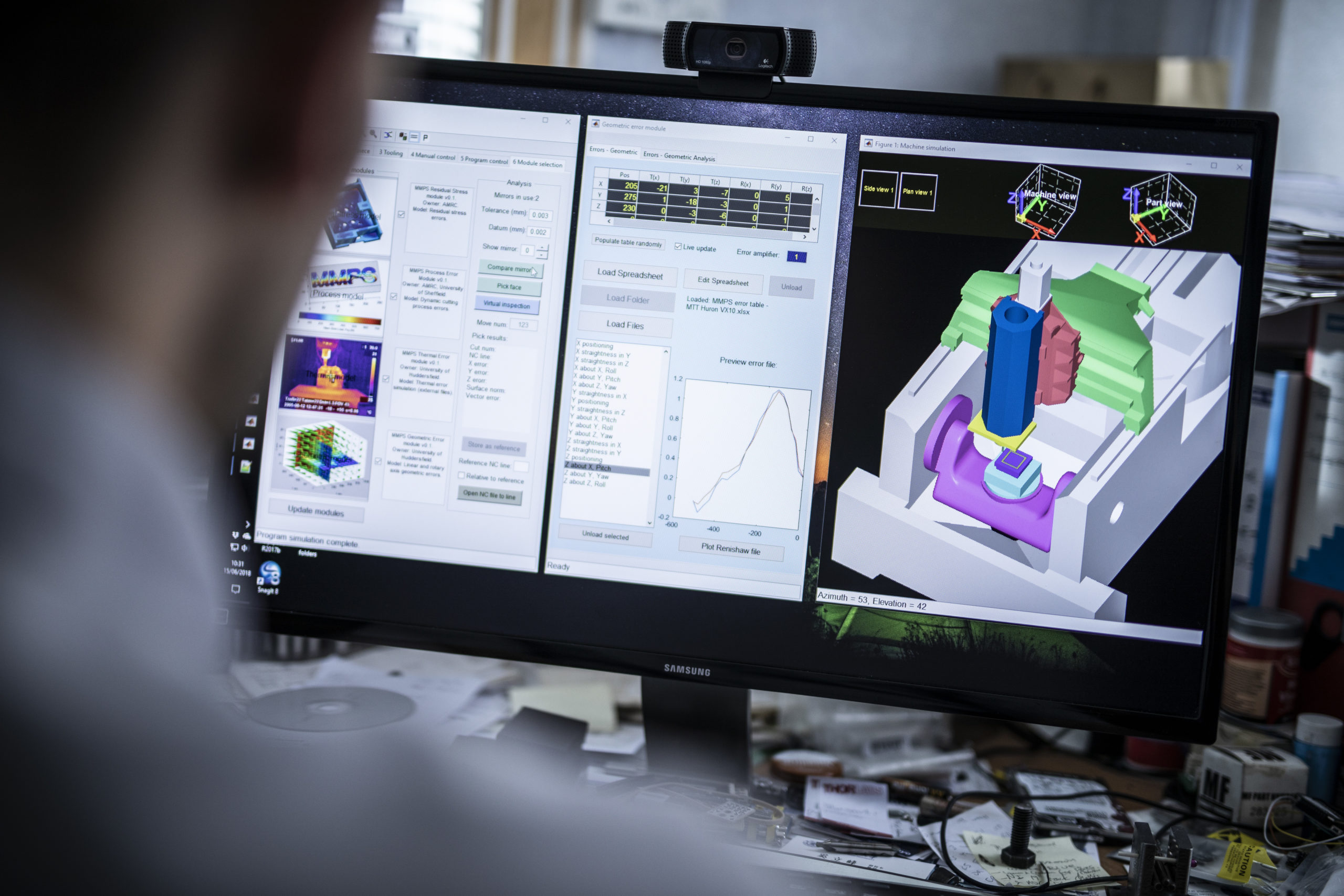

The ability to autonomously control manufacturing in real-time, as a result of an in-process measurement can offer the potential for further efficiency gains. This is because processes can be kept in their optimum range throughout changing manufacturing conditions. The energy efficiency of any manufacturing process is directly linked to the operating efficiency of that process. If a process can be completed more quickly or with fewer stages, less energy will be used overall.
Additionally, gathering comprehensive data about the manufacturing process is an important first stage in developing an accurate simulation model and ultimately enabling the creation of a true digital twin. This allows a process to be optimised in advance of machining and is fundamental in facilitating agile manufacture, optimally choosing the right machine and process within a set of given performance constraints. This is especially attractive to companies engaged in the low volume or even one-off manufacture of extremely high-value components. In these scenarios, there is little opportunity to observe the manufacturing process and make incremental improvements; efficiency must be present from the outset.
