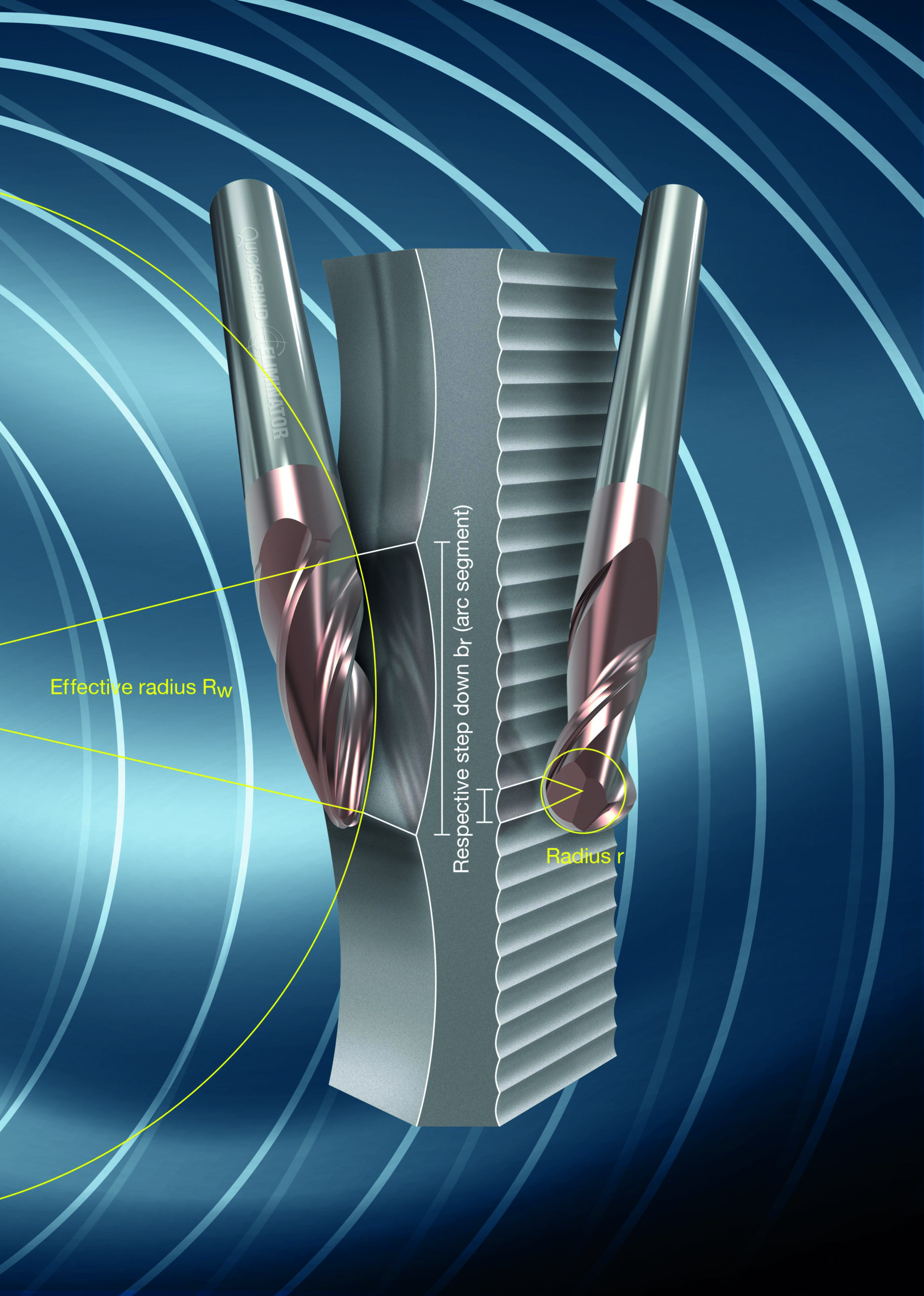

Understanding the concept
The ball nose endmill is based on a circle with the step down being limited to the contact area of the cut. This is generally calculated as the step-down rate (ap) = 0.02XD1. For example, a 10mm diameter ball nose can achieve a step-down rate (ap) of 0.20mm. Therefore, to increase the step down by 3 times, the tool diameter would need to be 30mm, which would be expensive and impractical in most applications.
However, by taking the segment of that 30mm diameter and adapting the arc to form the flute of the cutting tool known as the effective radius (Rw), the result would be a probable step down of 3 times that of the ball nose (ie 0.6mm instead of 0.2mm).
