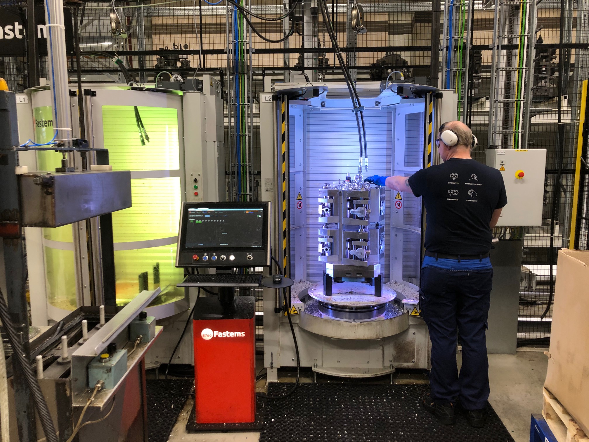

The operators at Kongsberg Automotive have been satisfied with the user-friendliness of the Fastems’ MMS control software. Operated primarily via a large touch screen and with intuitive user friendly controls, the MMS is easy to use and is much like using everyday technology such as a smartphone. The work ergonomics have also increased significantly and this is down to improved operator access to the pallets in the loading stations.
The Fastems MMS stores information on workpieces, fixturing and pallets. This means that re-running parts is very easy and can be done in a couple of minutes and doesn’t require lengthy manual preparations. Today, all pallets and fixtures can be stored inside the system, making workflow easier and more efficient. Unused pallet capacity also enables future growth.
