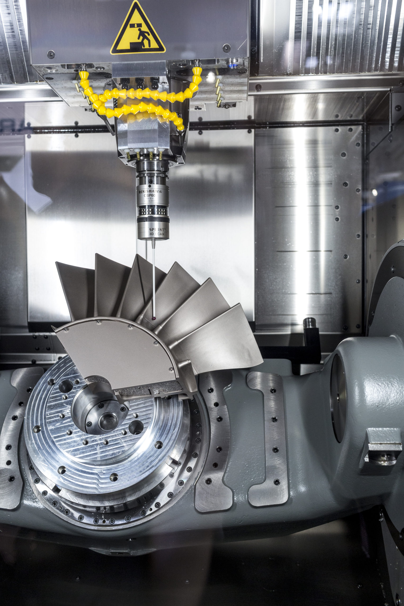

The OSP60 probe can continuously measure up to 1,000 points per second in XYZ simultaneously. So, depending on the resolution that you want, it can measure as fast as preferred; even at G0 speeds in some cases. SPRINT technology can give the machinist the necessary confidence that a workpiece has been machined within tolerance extremely quickly and accurately. Similar to a coordinate measuring machine (CMM), it reads the encoder or linear scale values from the CNC and compensates for any potential errors. It can even scan rough surfaces like castings. Thanks to numerous innovations, it can achieve real-world repeatability better than ±1µm.

  • Scanning blades, bladed disks, impellers and other complicated forms.
