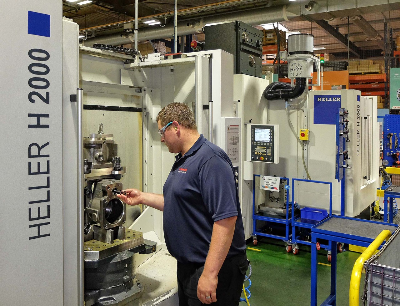

In its 25th anniversary year, the Plymouth plant of hydraulic motor, pump and valve manufacturer Kawasaki Precision Machinery has seen a far-reaching reorganisation of its K3VL axial piston pump machine shop. It follows the purchase in October 2018 of a pair of twin-pallet, horizontal-spindle machining centres (HMCs) from Heller Machine Tools to replace two ageing, double-pallet models on which it was becoming difficult to hold tolerance.

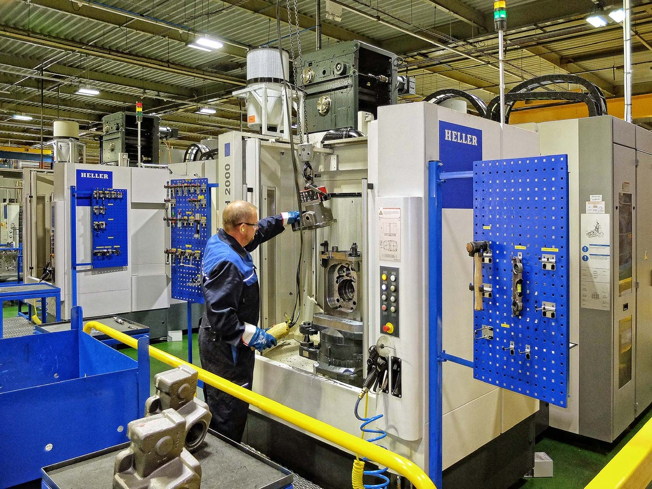

One of the new Heller H2000 HMCs, which are manufactured at the supplier’s factory in Redditch, is devoted to machining pump cases while the other HMC mills and drills valve covers. The components are produced from grey iron castings that have had their bores pre-turned on a lathe in preparation for two-operation prismatic machining. Around 20,000 of each component are produced per year.
Production engineer Mark Pellow advised, “In the case of the valve cover, the machining time of 50 minutes plus 10 minutes load / unload on the former production centre has been replaced by a 32-minute cycle on an H2000.
“For the pump case, the former machining time was 48 minutes plus 10 minutes for handling, while the current cycle takes just 30 minutes.
“As set-up is carried out on the other pallet during machining, the next component is presented to the spindle within seconds by automatic pallet change (APC), so productivity has been nearly doubled for both components.”

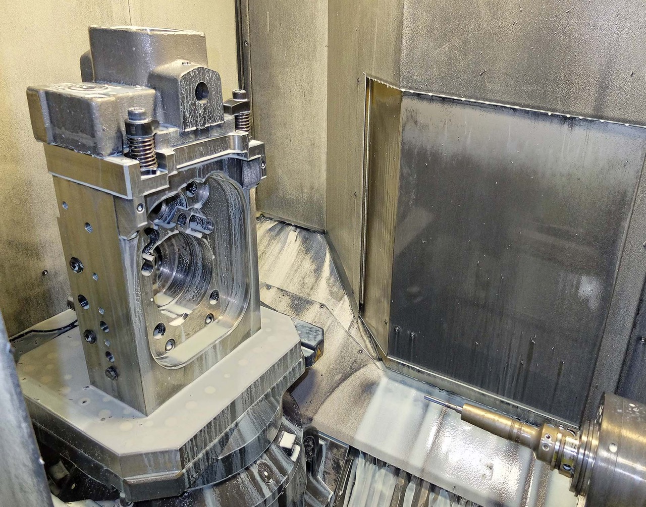

The two process routes have been changed to enable such a significant increase in output. Parts are still loaded two at a time on a tombstone for op 1 and op 2 machining. One difference now is that fixtures have been built into a suite of tombstones to accept the castings directly, rather than first having to mount the parts onto workholding plates. The latter double-handling procedure used to eat into much of the spindle uptime on the previous machines.
There is a second, even more important difference, however. When nearby Morris Engineering produced the workholding solutions for Kawasaki, it arranged the two fixtures so that one is on a tombstone face and the other is mounted across the top, improving tool access. The result is that any given tool can machine more features throughout the whole cycle, the program no longer being split into two, so fewer tool changes are needed leading to less idle time. Tool exchange itself is also faster at 2.8 seconds chip-to-chip, as are rapid traverses at up to 90 m/min around the 630 mm working cube.
