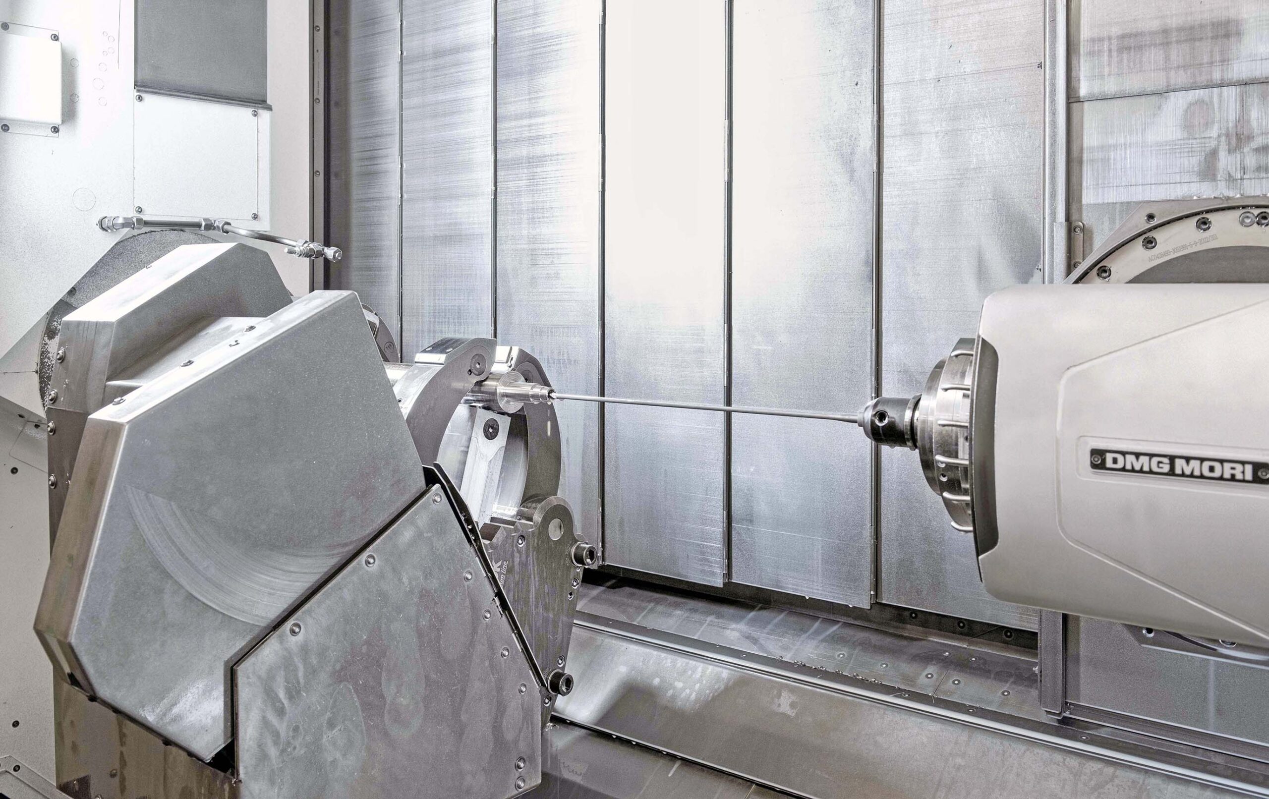

A variety of spindles is produced, requiring combinations of turning, gear milling, deep hole drilling, grinding and in-process measuring. The large capacity of the lathe, with its Z-axis stroke of more than three metres, was necessary to machine the spindles, which are up to 1,000 mm long, as sufficient travel is needed to allow deep hole drilling.

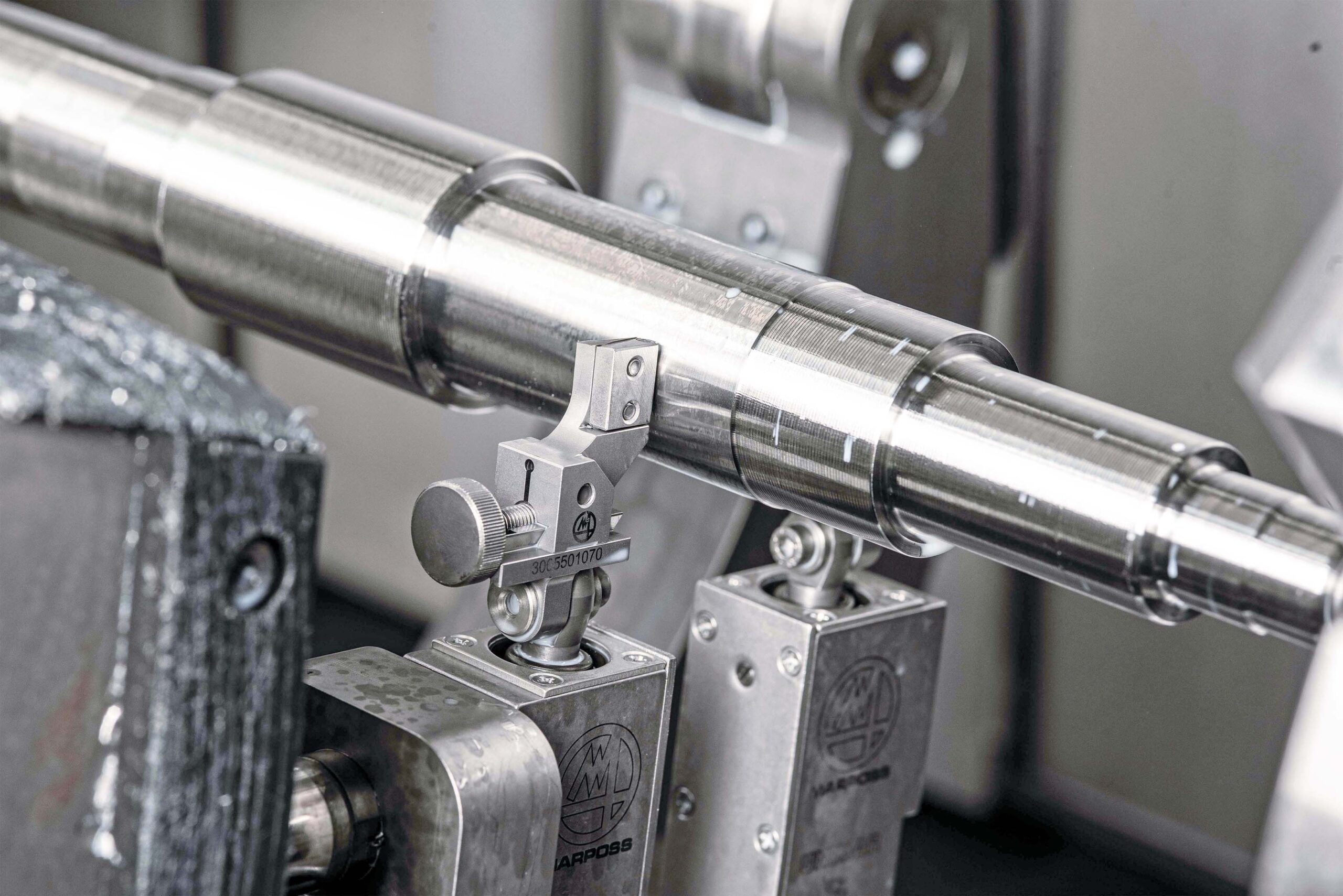

In-process measurement of surface quality makes life easier for the quality control department. Any drift towards a predetermined out-of-limit threshold is corrected by editing the program on the shop floor so that the Ra value remains consistent throughout the batch. Tool wear is determined using a measuring fixture and if the actual value exceeds the target value, the cutter is automatically replaced by a sister tool.

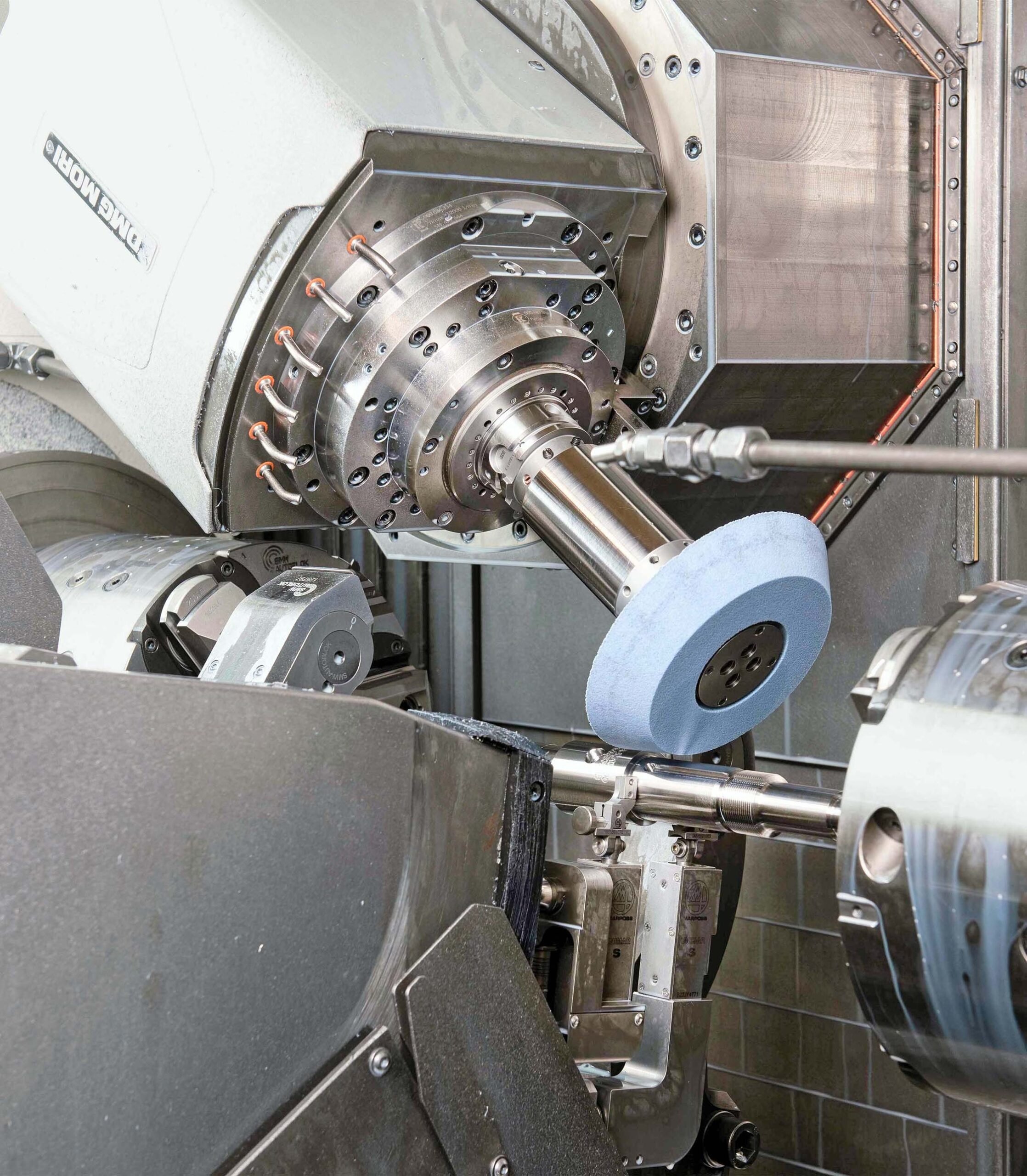

A powerful coolant pump prevents the accumulation of chips that would otherwise interrupt the process. Another special feature is a separate compartment in the right-hand section of the working area for oversize tools, which allows grinding with larger wheels than would otherwise be possible, saving production time and consumable cost.

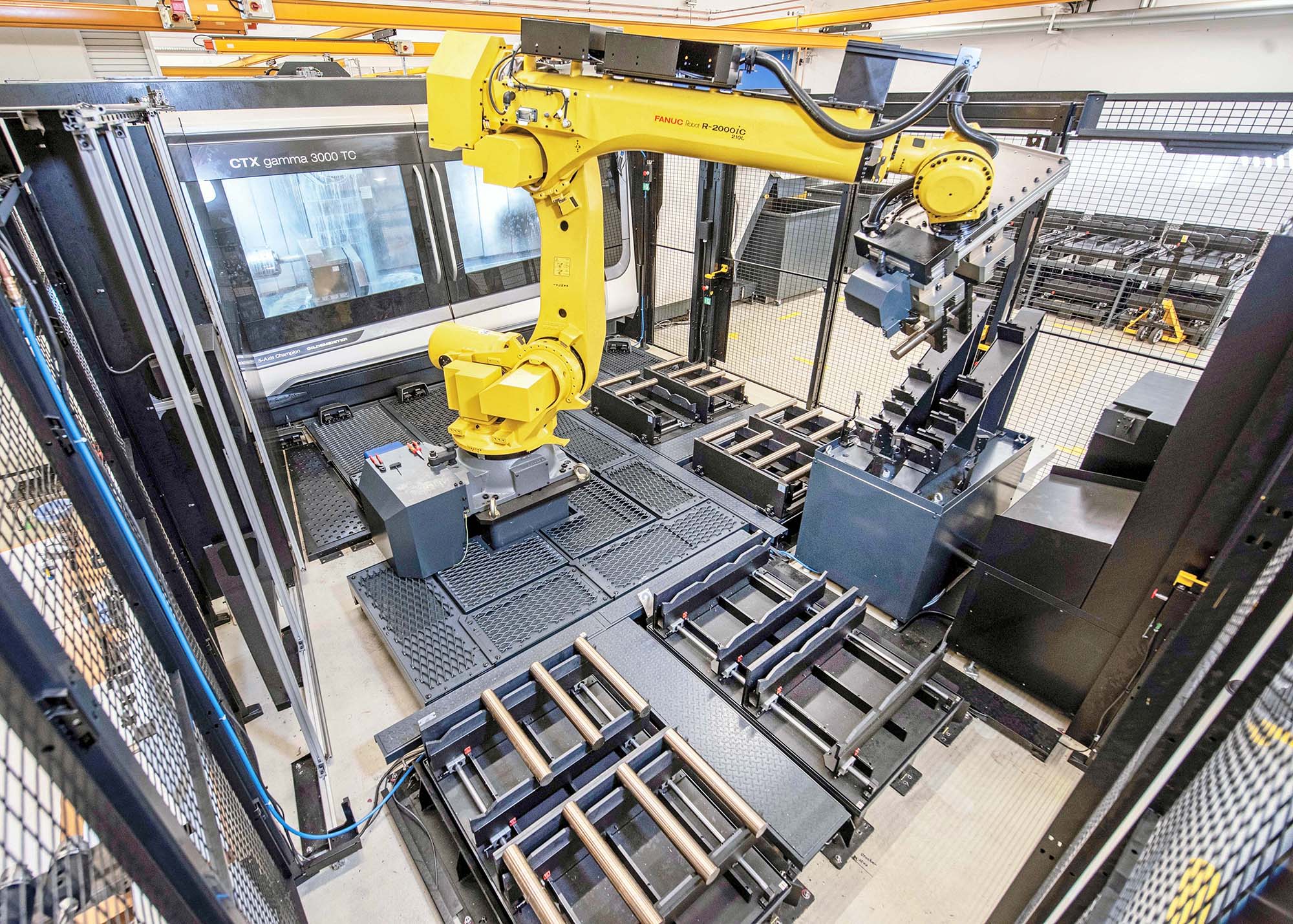

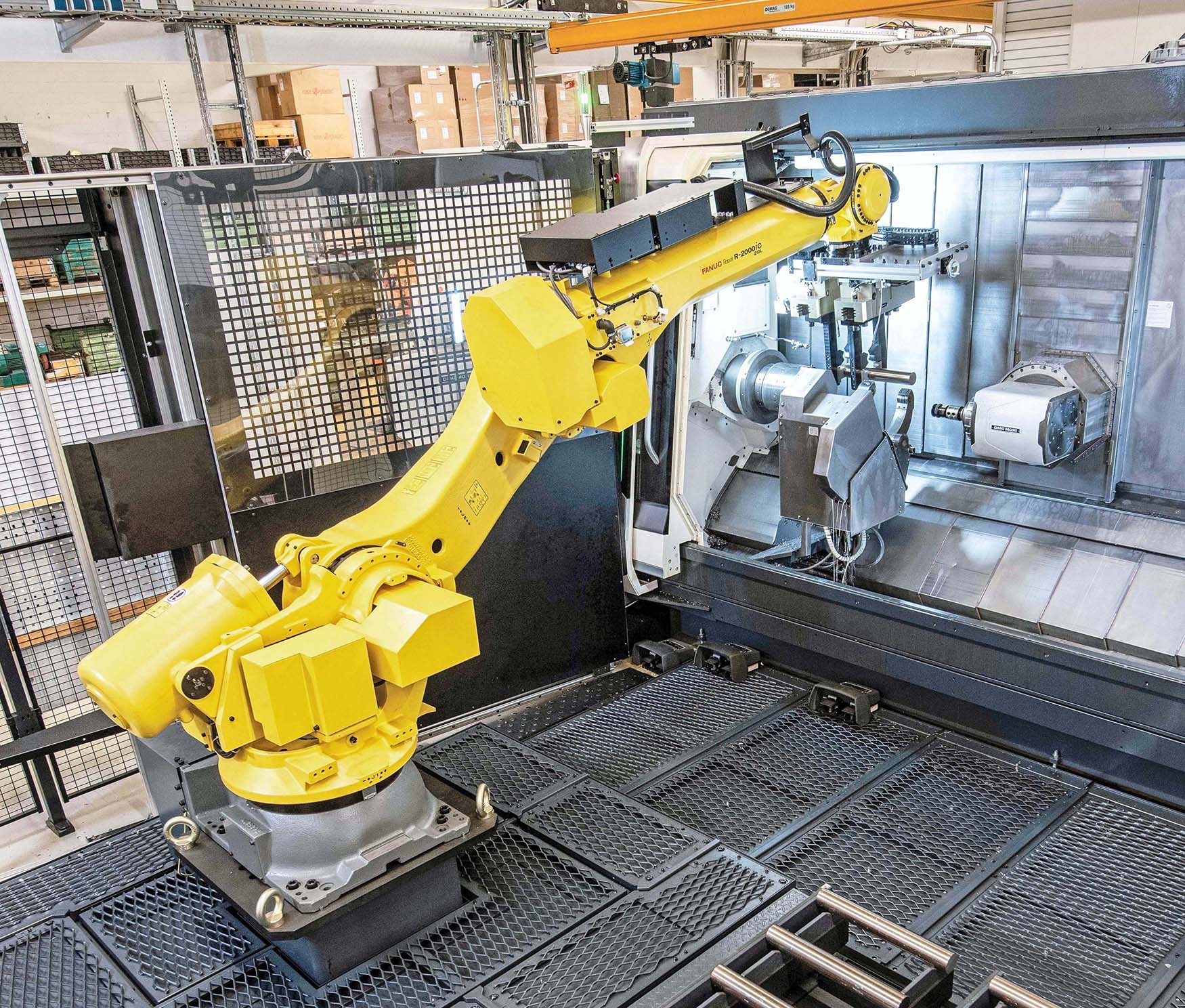

Mr Hartmann continued, “The biggest advantage is, of course, the fully automated production of entire batches. The MATRIS system is designed to be served via four component pallets that are wheeled by pallet truck in and out of the loading area. The robot takes the raw parts and aligns them so that they can be clamped correctly in the chuck and steady rest. The finished parts are then placed back on the pallet.”
