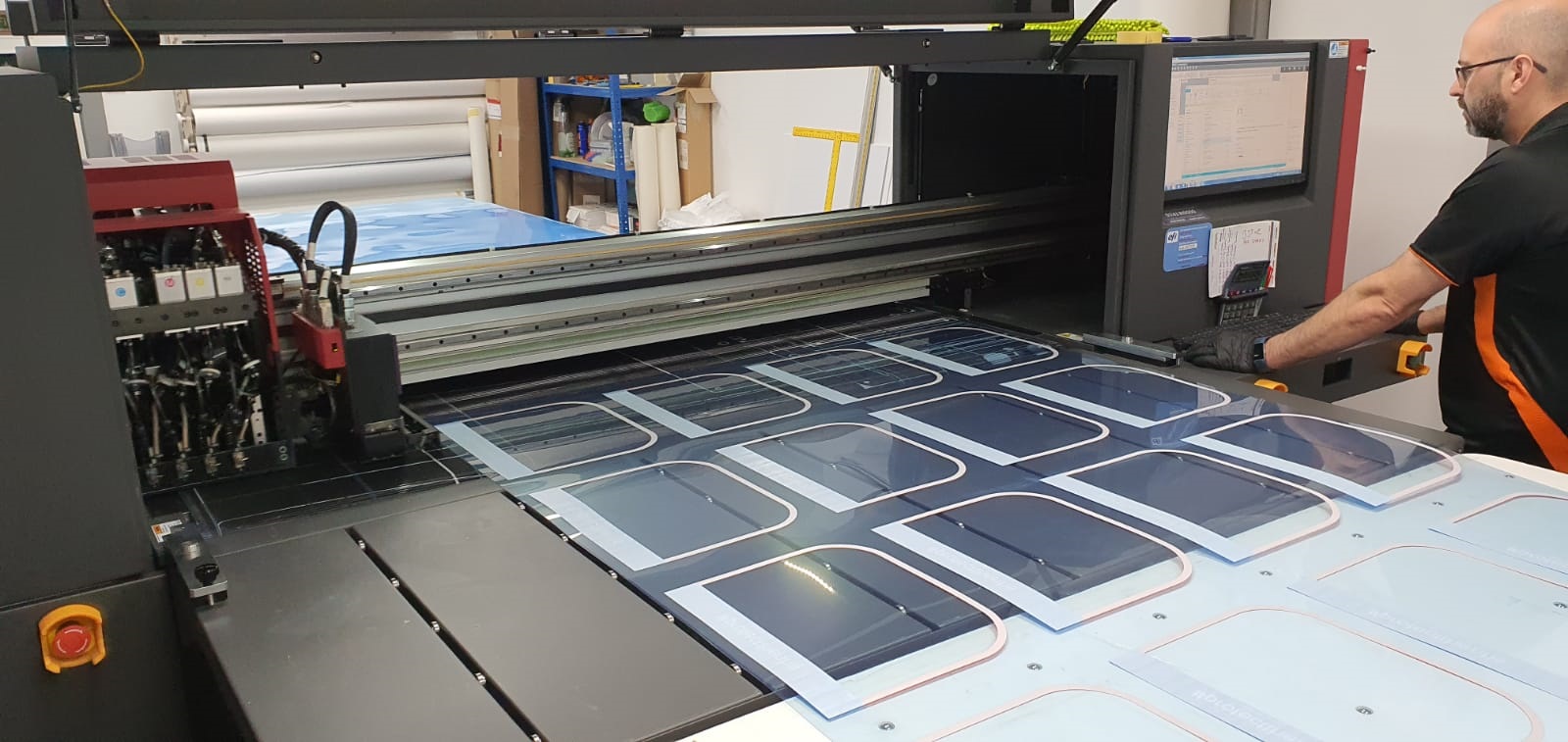

The facemask consists of a 0.5 mm PETG visor, an elasticated strap that is pre-cut to length and foam padding that is applied to the visor to create an element of comfort for the healthcare user. “The PETG sheets are 2050 by 1250mm and we can produce 20 face visors from each sheet. It takes 10 minutes to print 20 mask designs on our large format flatbed printer and simultaneously another 20 masks will be cut out on our Biesse routing machine. We are running this machine at 24,000rpm with a feed rate of 10m/min.”
