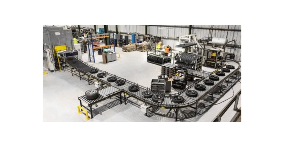

A large part of what Autarky Automation offers is in the area of modular conveyor technology. Here, Autarky offers a wide range of standardized components and accessories. The company thereby contributes to minimizing project planning times and assembly costs. A good example of this is the project for Tyre-Line: Since 1984 the company has been supplying the industry with wheel and tire assemblies – from wheelbarrows to high-performance sports cars.
The task: conveyor system for tire inflation.
For a long time, the tire line at Tyre-Line operated with a simple tire inflation device for standard steel wheel sets. The tires for high-end alloy wheels were inflated manually. Due to increasing growth in orders, a Hofmann tire filling machine was purchased that could handle the complete range of wheel and tire assemblies.
The entire process of storing and retrieving assemblies in the machine was now to be automated. Autarky won the tender to produce a suitable conveyor system and relied on Leuze.
The challenge: tires are round.
Attached to each wheel and tire assembly at Tyre-Line is a slightly adhesive bar code label. It would have been too complicated for Tyre-Line to affix the label at exactly the same location on each assembly. Autarky was therefore charged with developing a solution that could reliably read the bar code. And could do so at any location and at any position over the entire width of the conveyor belt.
“A round object that always looks the same independent of its position is a true challenge for a code reader.”
“Proper identification of the assemblies was, however, of decisive importance for the success of the line: the detection of the bar code information needed to tell the Hofmann machine which assembly is approaching and, thus, what air pressure is necessary. That´s why it was so important to select the best possible code reader for this task,” explains Brad North, managing director of Autarky. To solve this problem, Autarky turned to the Sensor People at Leuze.
The solution: the DCR 200i from Leuze.
After discussing the application with the Leuze experts, we selected the DCR 200i 2D-code reader,” explains North. Leuze, a leading manufacturer of bar code readers with more than 50 years of experience, developed this model especially for fast and omnidirectional reading of 1D- and 2D-codes.
»We mounted three devices on a strap arrangement at the optimum angle and height so that the bar code could be read at any position on the assembly and the conveyor belt.”
“In combination with the existing PROFINET communication network, the DCR 200i 2D-code readers from Leuze detect data on the bar code. This is then passed on to the Hofmann machine.” Autarky had already used hundreds of standard bar code readers and photoelectric sensors from Leuze. “Our longstanding cooperation with Leuze and the good service made the decision easy for us,” says Brad North.

“Today, a wheel and tire assembly passes through the inflation machine every seven seconds. In addition to the sheer speed, Tyre-Line also benefits from an increased inflation accuracy and repeatability. Because the automated system has eliminated any possibility for human error.”
The conclusion drawn by Autarky Managing Director Brad North is entirely positive:
“At Tyre-Line, the Leuze 2D-code readers now work daily from morning to evening and help the company achieve significantly higher throughputs rates.”
