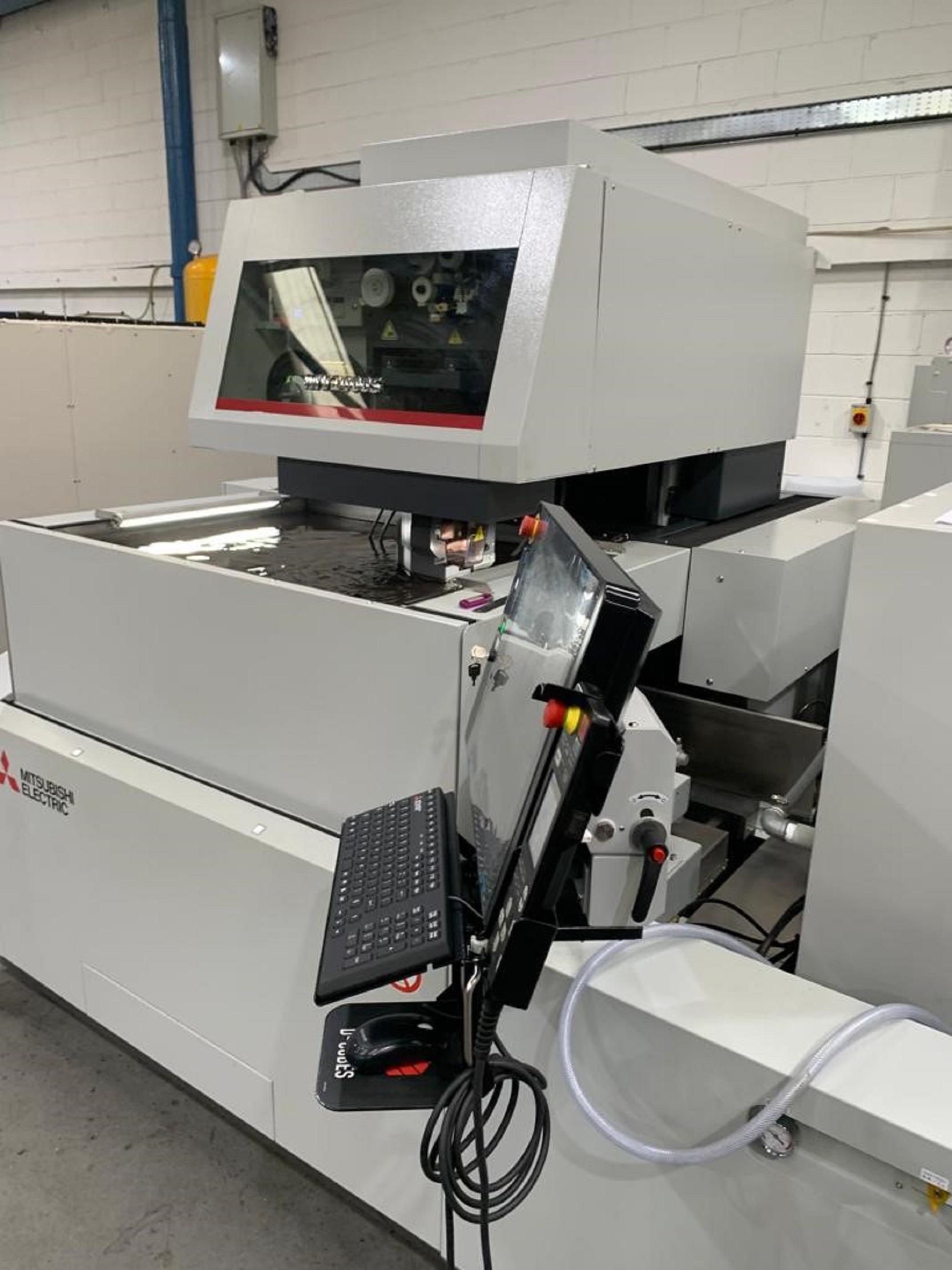

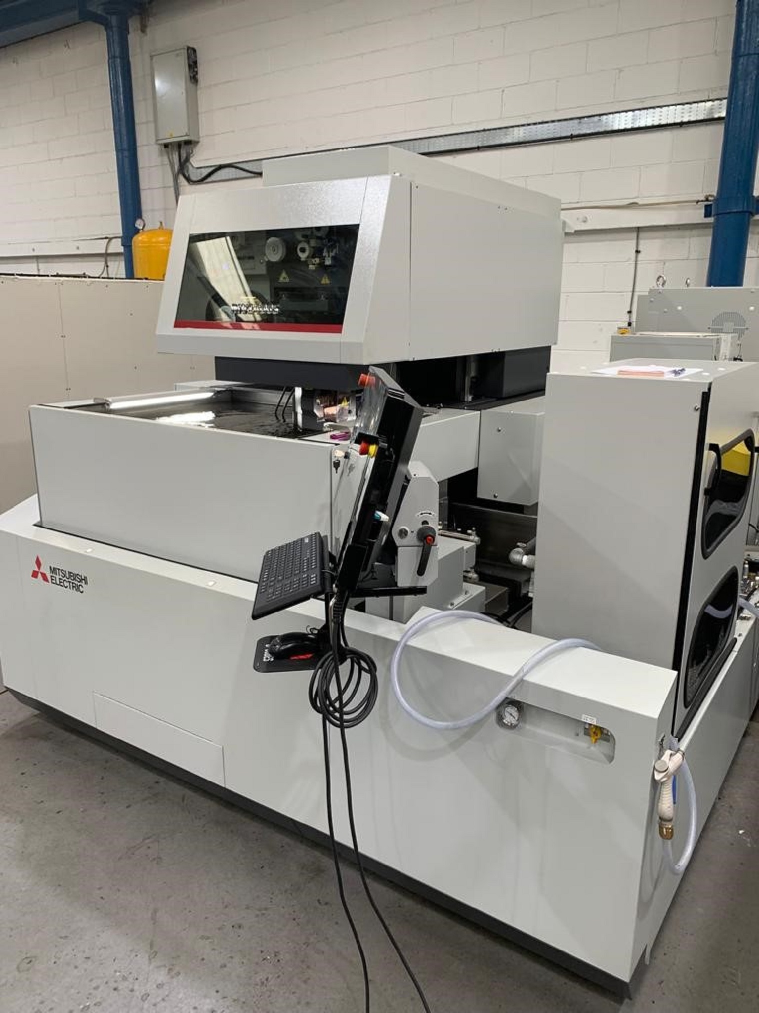

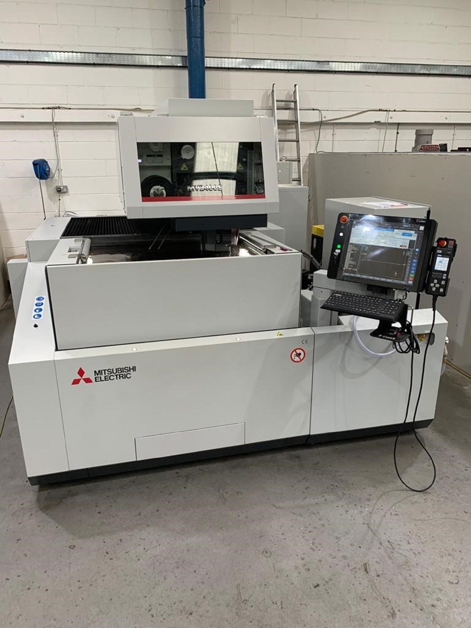

The new Mitsubishi MV2400S accommodates workpiece dimensions up to 1050 by 820 by 305mm in X, Y and Z axes with a maximum component capacity up to 1500kg that can fit on the 840 by 560mm table. The machine can utilise wire diameters from 0.1 to 0.3mm and it is supplied with tubular shaft drives with linear scales, the M800 control with 19” full-touch screen monitor, hand pilot with configurable LCD monitor, digital AE II generator and a filter switching system.
