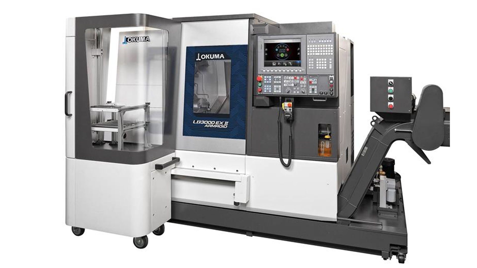

Okuma has recently addressed these drawbacks with the ARMROID, a zero-footprint robotic arm that can be programmed by anyone experienced with the Okuma OSP control.
A Completely Integrated Robotic Arm
The Okuma ARMROID is a robotic arm that mounts inside a compatible machine tool and is integrated into the machine’s controller. According to Okuma Product Specialist Wade Anderson, the ARMROID is designed for shops that don’t have the staff needed to program a full robotic cell.
Because the robot is integrated into the OSP machine control, any user familiar with using the machine tool is fully capable of programming the robot, and the robot and machine tool can be controlled using a single pendant. “There’s a conversational navigation window you use to tell the robot how to pick up a part,” Anderson says. “The user inputs the points the robot needs to reach, and the motion itself is generated automatically.” Additionally, during loading and unloading, the arm utilizes the machine’s own collision avoidance software to avoid damaging parts or equipment.
The ARMROID can be mounted inside both the Okuma LB3000EX II horizontal lathe and the MULTUS B250 II multitasking machine, where it is designed to be able to tuck itself out of the way during machining. Because it is designed only for use in these two machine tools, the company was able to integrate it more fully than most automation systems can achieve. In many ways, it functions as simply another part of the machine tool.

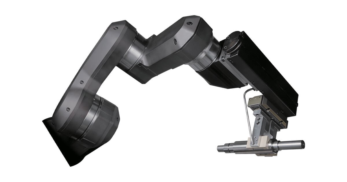

The gripper for the robot comes in a parallel-jaw formation for parts up to 5 kilograms (11 pounds), as well as in a three-jaw setup that can hold parts up to 10 kilograms (22 pounds). The latter jaw is available only for the MULTUS B250 II.
In addition to moving and positioning parts, the ARMROID can use different end effectors to accomplish other tasks such as spraying coolant and providing a cylindrical part with support. As with other aspects of the ARMROID, the three end effectors (workpiece gripper, workpiece support and coolant wand) can be exchanged automatically using the machine tool’s controller.
The workpiece-support end effector uses a dual-roller system to improve the rigidity of the part, providing damping and reducing chatter. This effect is especially apparent with longer parts. Additionally, the coolant wand’s directed spray can clear chips that other systems can miss. Even when other coolant systems are already in use, it can clear chips that gather in crevices. “Being at the end of a robotic arm makes it much easier to get into nooks that can gather chips during machining,” Anderson says.
The end effectors are stored in a drawer system located in the machine tool wall. Without a programmer needing to input any precise coordinates, the system can exchange any end effector mid-process. When the correct end effector is equipped, the drawer safely stows itself out of the way. During a single machining cycle, the ARMROID is able to move parts into and out of the machine clamping system, exchange the gripper for a coolant wand or workpiece-support end effector, and assist in machining.

The ARMROID can work with many kinds of part stockers, and it is reliable enough for lights-out machining. Because the potential setups are so flexible, it can even be used as a cell for both attended and unattended machining. “For example, there are stocker options with wheels,” Anderson says. “You can slide it out of place for a shift with an operator attending the machine, then slide the stocker back in for a couple shifts lights-out.”
