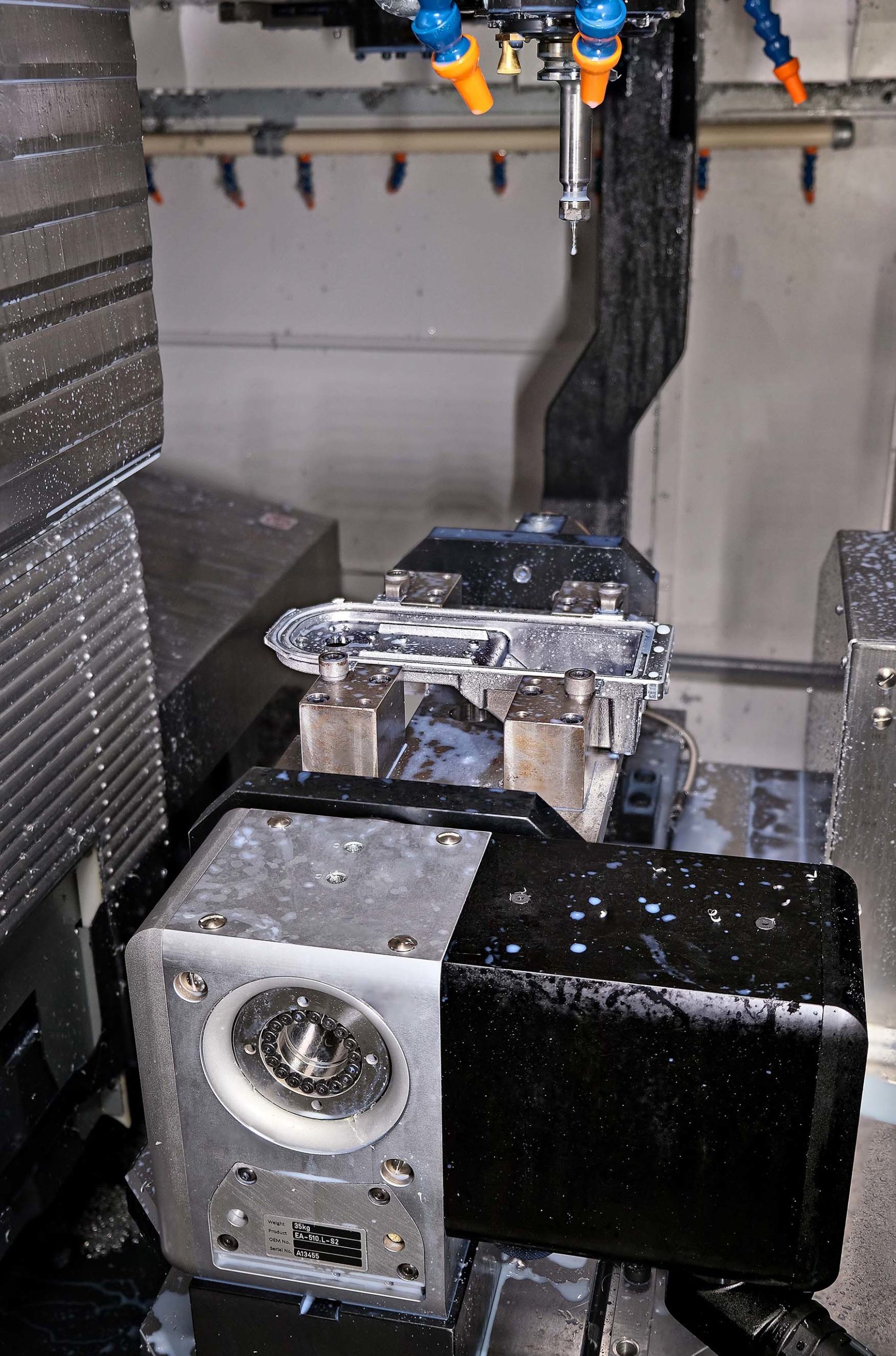

At the beginning of November 2019, Whitehouse Machine Tools delivered to the Andover facility of MRT Castings, an aluminium diecasting and machining specialist, the first Brother Speedio R650X2 machining centre to be installed in Europe. The 30-taper machine is equipped with twin pallets carrying 4th-axis trunnions as well as Blum workpiece and tool probing to ensure accuracy of machined parts.

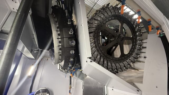

A sequel to Brother’s flagship model TC-32B QT, the latest 16,000 rpm-spindle machine has the largest number of tools available in the Speedio range, 40 as opposed to the former machine’s 21, as well as a larger X-axis stroke, up from 550 to 650 mm and an 800 mm long table instead of 600 mm. Z-axis travel is also slightly more. That the R650X2 has these characteristics is partly down to the closeness of Phil Rawnson, managing director of MRT Castings, to the Japanese machine builder.

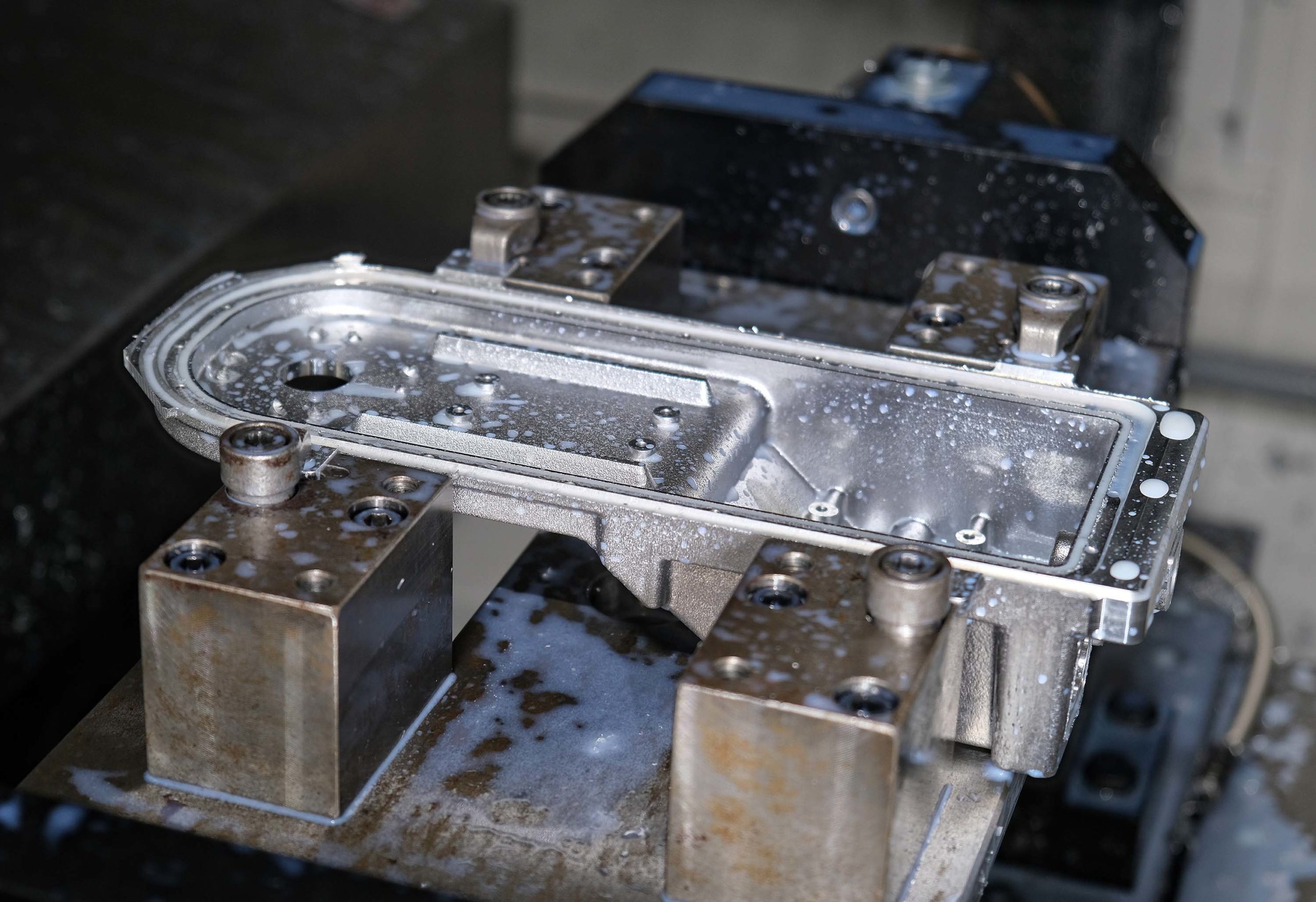

“If we need to hit several faces of a component, we can carry out a second machining operation sequentially by fixturing parts side by side on a single fixture.
“Or we can clamp a larger number of small parts to fill the table. By putting more castings under the spindle at the same time, fewer tool changes are needed per component and productivity is increased.
“Alternatively, we can use the three or four CNC axes to machine longer castings at the highly productive rates possible using a 30-taper machine.”

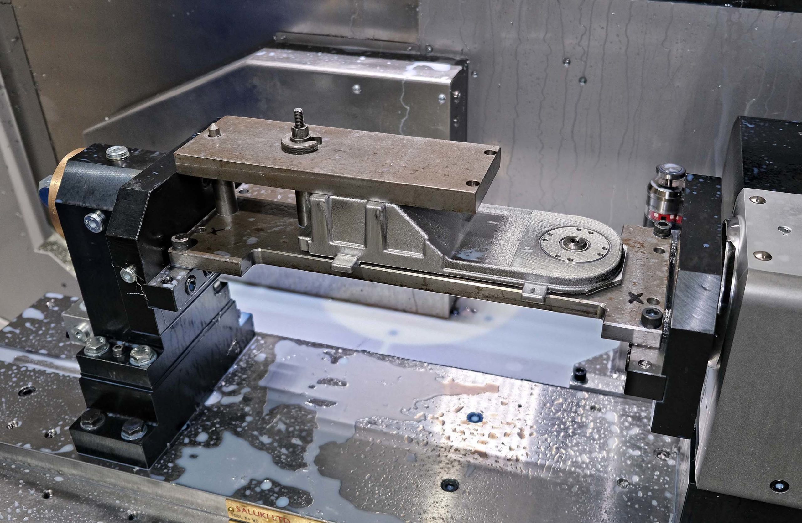

Pallet-change Brothers are generally employed at the Andover facility if cycle times are short, say less than five minutes, to minimise spindle idle time during sequential Op 1 and Op 2 machining on six sides of a casting. Fixed-table machines are more economical if cycles are longer, as one operator is able to load and unload a pair of machines to complete the two operations in tandem.
Accuracies achieved are impressive, down to a couple of microns for bearing bores. Some electrical assemblies comprise up to 20 individual castings and tolerance build-up can become a problem if such tight limits are not held. Other work for the electronics, defence and top-end lighting sectors also stipulate tolerances that are sometimes very tight. Parts coming off the Brothers are not only dimensionally accurate but also highly repeatable, according to Mr Rawnson.
