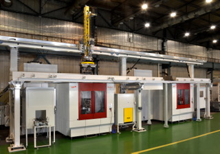

A major supplier of aerospace parts in Italy is depending on a Starrag-developed flexible manufacturing system (FMS) to deliver exceptional machining rewards and reduced piece part costs when it commissions a four-machine, minimally-manned automated solution which will operate around-the-clock to meet rising demand for certain aero-engine components.

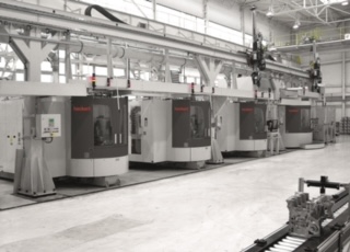

Based on a quartet of Heckert HEC 500 X5 multi-axis machining centres, each featuring a five-axis trunnion-type table, the FMS will be served by an integrated pallet system and a centralised tool storage facility that will house an amazing 2,000 tools to cover all eventualities in the single set-up, multi-task machining of the family of parts.
In addition to highly-efficient cutting and cycle times, the Heckert machining centres will also ensure consistently high-accurate cutting – to within two/three microns – of the titanium and high alloy steel workpieces which range in size up to 500 mm by 500 mm.
Such demanding requirements do not, however, daunt Starrag which has more than 40 years’ experience in delivering FMS of all sizes as turnkey solutions to minimise floor-to-floor times as well as to reduce component costs.
These systems may contain varying Starrag Group machines plus the integrated technologies of, for example, workpiece handling/holding and transport (for instance, robots, bespoke fixturing, pallet systems and automatic rail-guided as well as autonomous vehicles), cell control (including Starrag’s Integrated Production System and Industrie 4.0 philosophies), tool storage systems (chain and tower) as well as complementary processes such as grinding, deburring, component cleaning and finish inspection.
