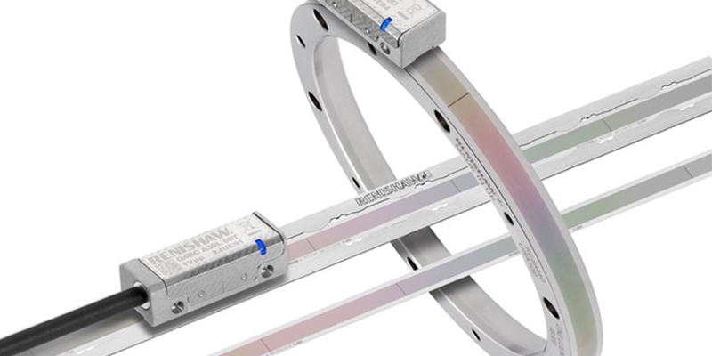

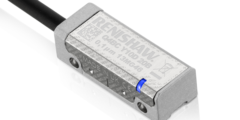

The QUANTiC encoder series combines leading-edge filtering optics and interpolation technology to create a high performance, super-compact, incremental, open optical encoder.
QUANTiC encoders feature exceptional installation tolerances and excellent dirt immunity due to an advanced photodetector design and coarser 40 µm-pitch scale. For instance, readhead installation rideheight and yaw tolerances are now ±0.2 mm and ±0.9⁰, respectively.

One benefit of the QUANTiC encoder design is the elimination of additional bulky external interfaces, which is particularly useful for space-constrained applications. This innovative approach was first used for Renishaw’s advanced VIONiC™ encoders.
QUANTiC readheads now offer digital or analogue outputs and are compatible with linear, partial arc and rotary scales. The choice of either a digital or analogue signal output enables direct manipulation of the signal inside the controller, which may be preferred for highly dynamic applications where refined velocity and acceleration control are required.
In rotary applications, customers can choose between either taper mount (A section) RESM40 rings for high accuracy applications or thin (B section) RESM40 rings for low inertia applications. The QUANTiC rotary encoder also addresses applications with wide through-bore requirements.
Available linear scale options include RTLC40 for mounting on FASTRACK carrier track and self-adhesive RTLC40-S: both simplify thermal error compensation by allowing independent scale expansion relative to the substrate.
QUANTiC encoders are also compatible with RKLC-40S encoder scale, which is highly flexible and can be used in both linear and partial arc applications. RKLC is a substrate mastered linear encoder scale that is designed to adopt the thermal behaviour of an underlying high thermal-mass substrate to enable passive thermal error compensation. It features a proven, robust stainless steel tape scale design with immunity to solvents, coilability for easy storage and cut-to-length convenience.
