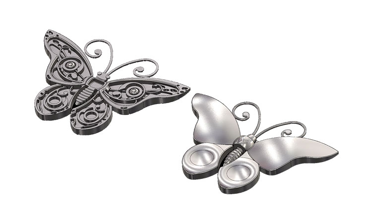

Illustrative Example: Challenging Assumptions A case in point is showcased with a sample part: a butterfly. While the butterfly on the left appears more intricate, it was actually 2D milled, whereas the one on the right underwent 3D milling. This example underscores the importance of letting the part’s complexity dictate the machining method.
