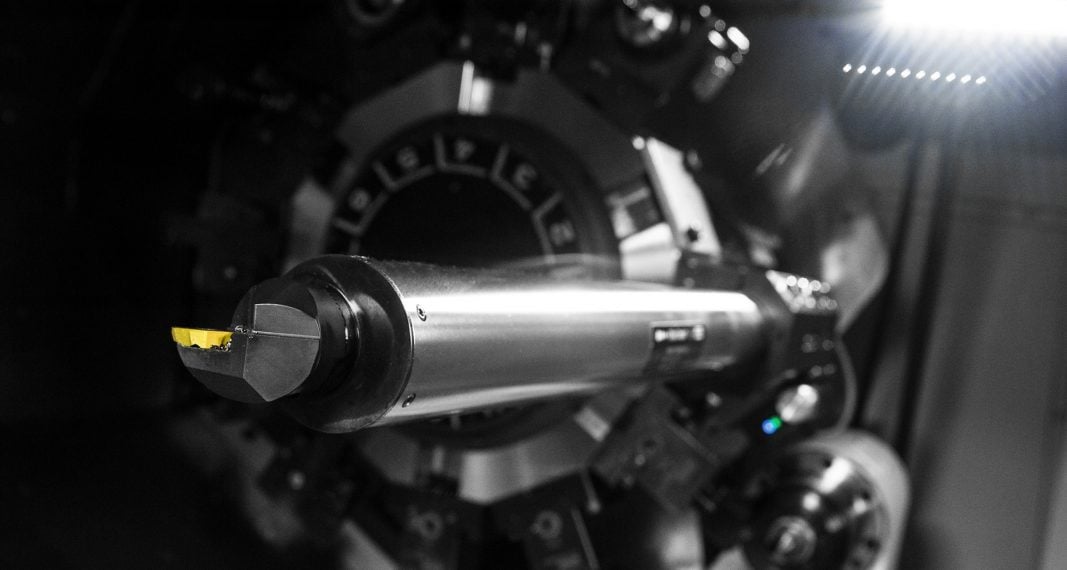

Silent Tools Plus adaptors are equipped with sensors which can measure important parameters such as height, temperature and load and transmit this data automatically to the machine, minimising tooling set up and improving operator control when the tool is in cut.
Ensuring that tools are correctly set up and working to appropriate loads and measurements can effectively minimize downtime and wastage of resources. This is particularly important in the aerospace industry, where accuracy is key in preventing the need to scrap partly machined components in exotic, costly materials.
