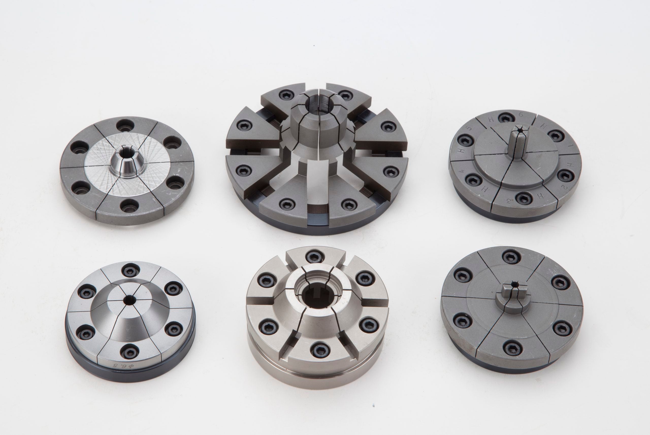

The workpiece specific clamping set – comprising jaws, workpiece location stops, maybe pneumatic part detection and coolant or air blast for clearing chips – can be changed in about one minute. The jaws and the part locator can be changed in about three minutes. There is an initial set-up of the chuck required to “dial in” the jaws with a master gear. Once this is accomplished upon installation of the chuck it will never need to be repeated.

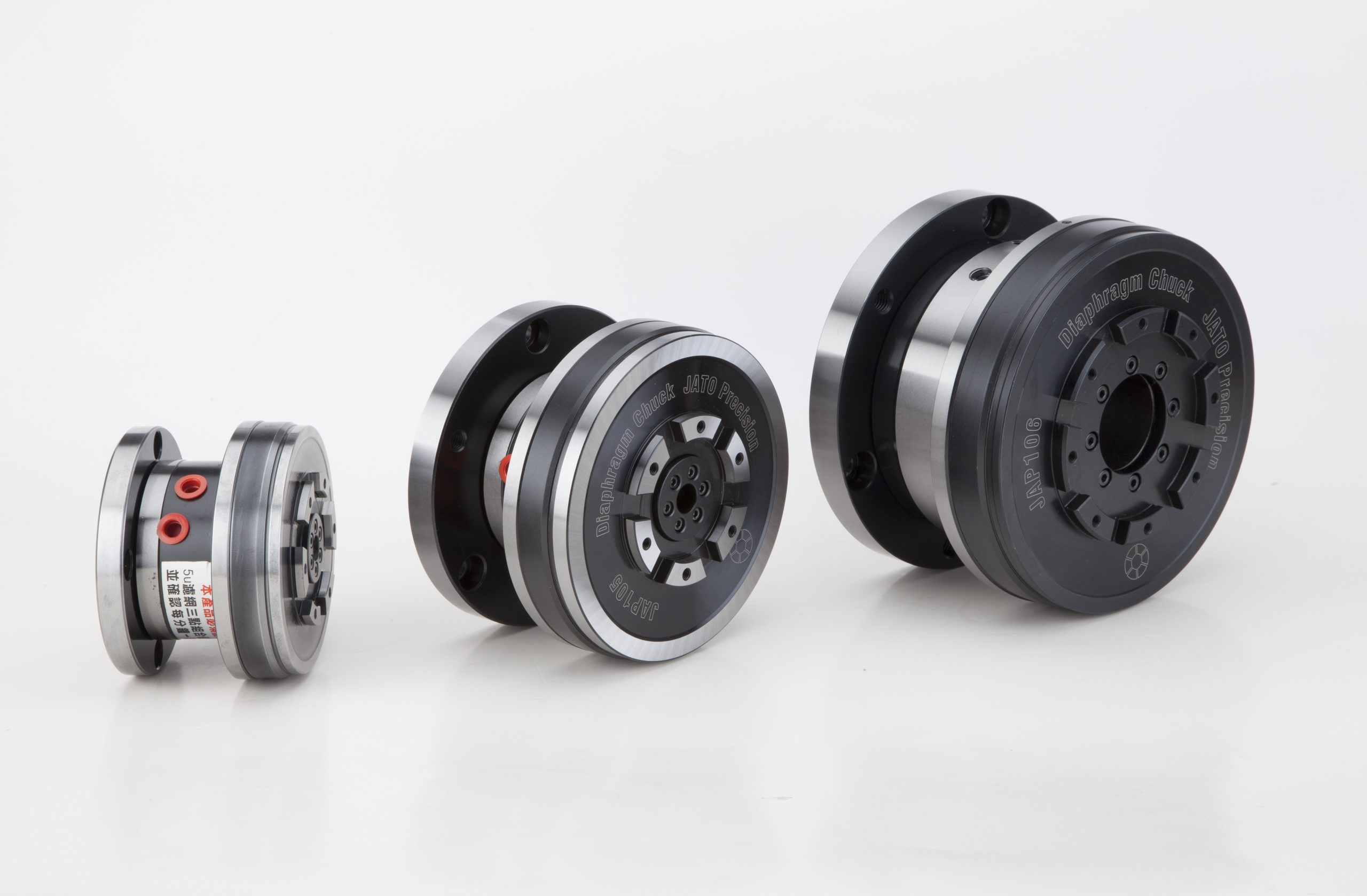

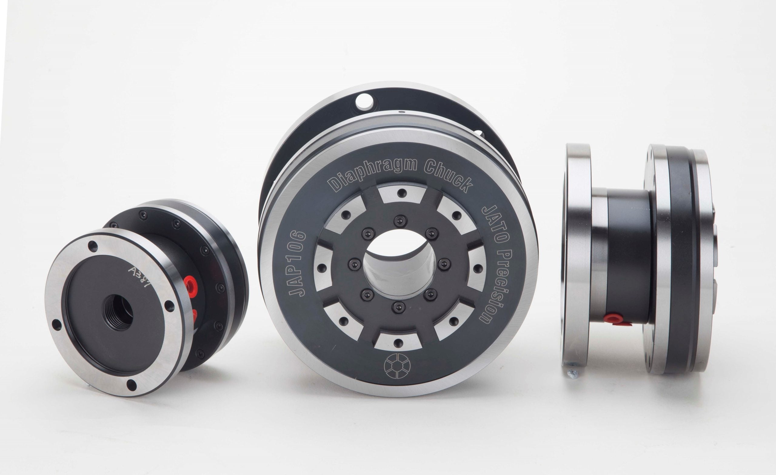

Why actuate the chuck with an external cylinder?
Most diaphragm chucks are self-contained front actuated, using a pneumatic cylinder for opening the chuck and releasing the workpiece. Clamping is accomplished by the spring action of the diaphragm. Among the features of the diaphragm chuck are relatively low gripping force and very small jaw movement. When using an external cylinder, it is a simple matter to apply a slight extra pull on the diaphragm to increase the gripping force when, for example, turning very hard materials where high tool forces are applied against the workpiece. This additional gripping force is not possible when using a self-contained chuck.
