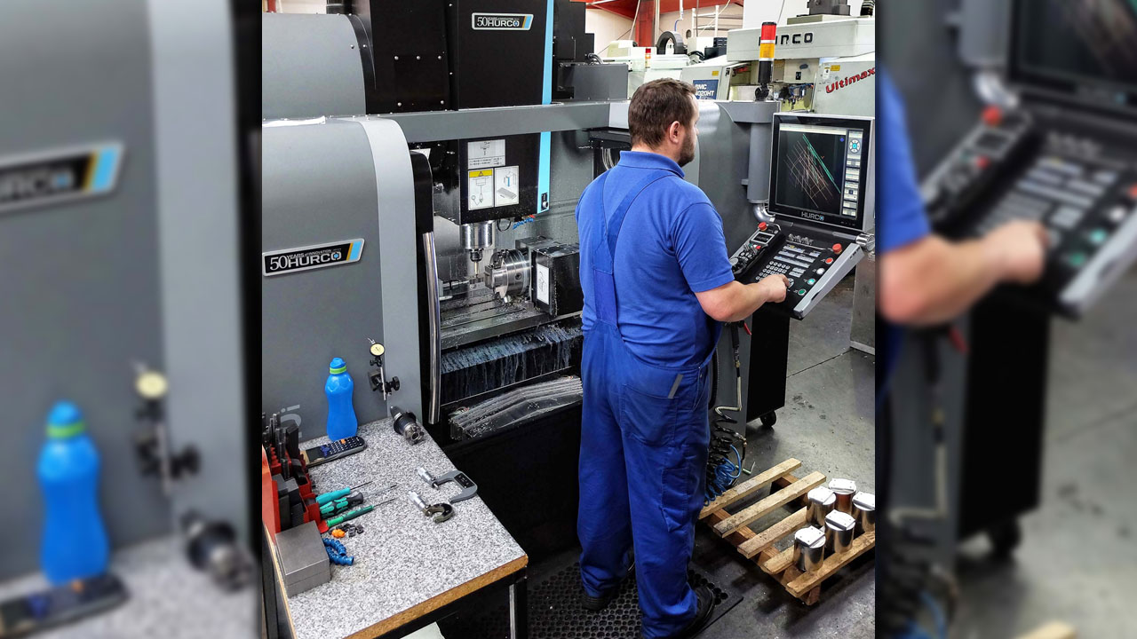

The latest Hurco addition was a VMX60SRTi 5-axis VMC with swivelling spindle head and flush rotary table, a design that is providing maximum working volume for single set-up machining of larger parts for the oil and gas industry.

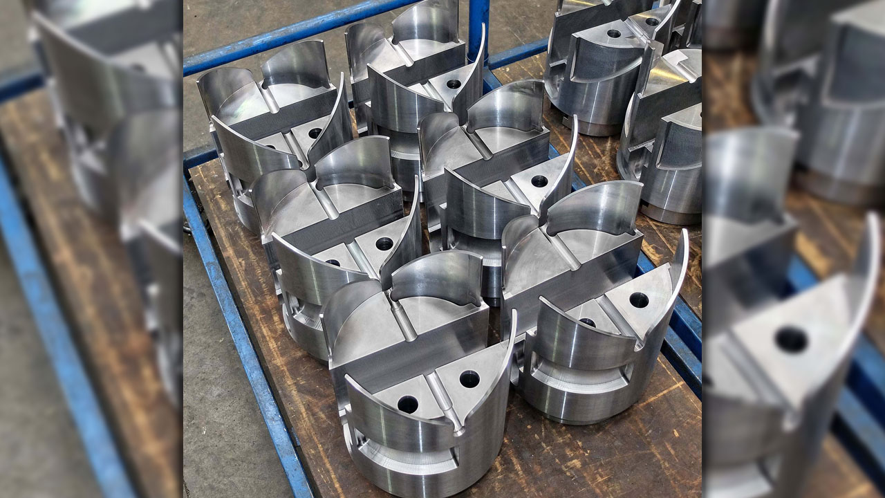

It is also allowing the subcontractor to gain extra contracts from the motorsport sector, particularly for the production of high tolerance components in one hit from materials ranging from stainless and other steels to aluminium and plastics. The use of linear scales rather than encoders for positional feedback from the linear axes, together with Renishaw part probing and tool length setting, provide the elevated levels of precision demanded in race car construction.
Tolerances held are from typically ± 0.05 mm down to 8 or 9 microns total. It has necessitated the installation of a new coordinate measuring machine, an Aberlink ‘Axiom too’, in a temperature-controlled room and a full-time inspector has been appointed to verify that F1 components coming off all the Hurcos and other machine tools are compliant.

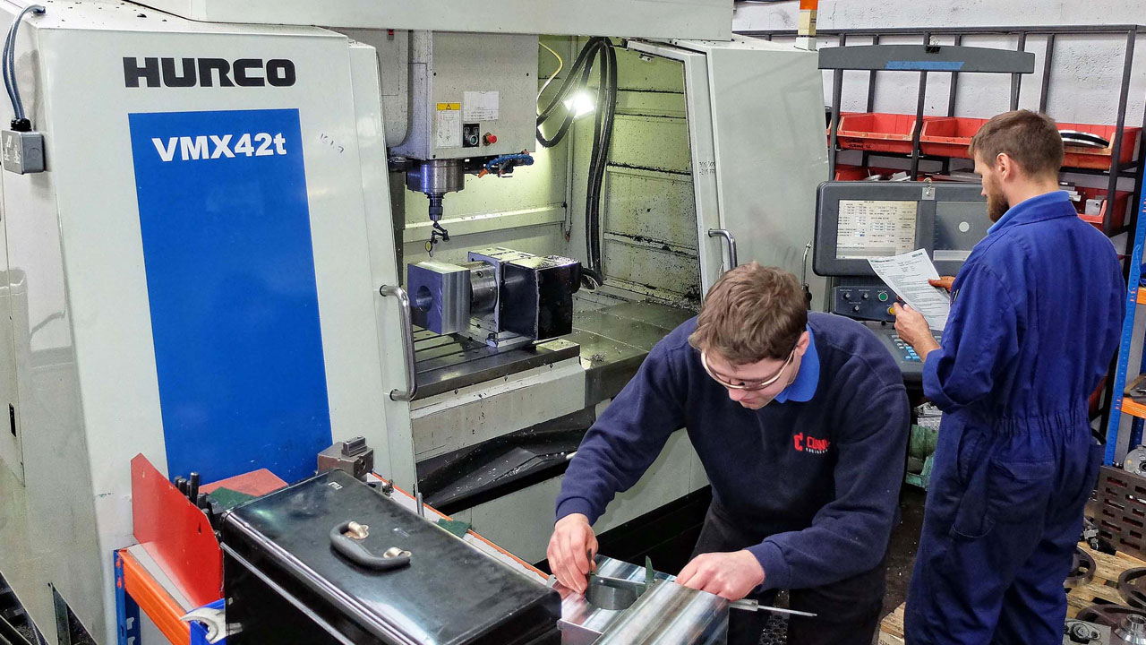

Prior to the VMX60SRTi, the most recent VMC additions in 2018 were two of the manufacturer’s latest generation VM10i machining centres, one of which has a 4th axis. They were preceded by the arrival of a VMX42t and a VM2, both of which were installed in 2016 equipped with Hurco 4th axis rotary tables. Other equipment in use includes seven more lathes and a Sodick CNC wire erosion machine.

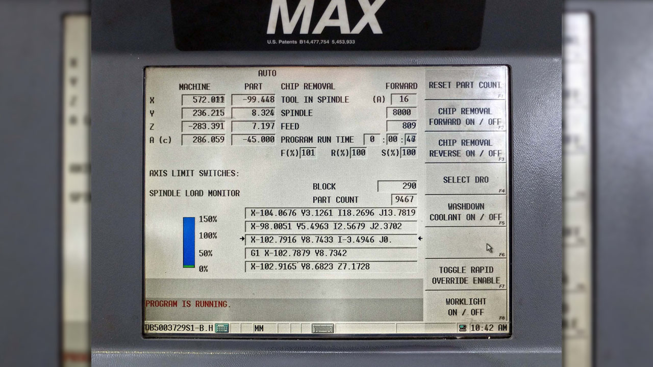

The North Lanarkshire company has standardised on this make of VMC ever since due to the reliability of that early model together with the speed and user-friendliness of the conversational control, originally Ultimax and now called WinMAX. It was and still is ideal for producing the subcontractor’s small batches of one-off up to 50-off.

New also in Cumbernauld in the last couple of years has been the installation of an off-line CADCAM system from OneCNC. Previously, all programs for the VMCs were created at the Ultimax / WinMAX controls using touch-screen conversational menus, sometimes with direct input of DXF data to describe more complex geometry.
Now, with the arrival of the CAD package, sections of ISO blocks can be extracted and inserted anywhere within a conversationally created cycle, any number of times, to stitch together a complete part program using the NC Merge feature within WinMAX. It considerably advances the subcontractor’s programming capability.
Further useful features within the latest version of the Windows-based WinMAX software exploited by Cowie Engineering include Mill Polygon, which facilitates milling a multi-sided contour with equal-length sides; and Mill Slot, which creates a slot defined by a line or an arc segment and a width, the slot ends being round or square. Swept Surface functionality built into the control also continues to be used frequently. It allows a 2D surface to be moved along a contour to create smooth 3D geometries within one conversational data block.
Company director Ross Cowie commented, “We have historically machined a lot of stainless steel, particularly for the food industry, and the material still accounts for around a fifth of throughput.
“Lately, new contracts have introduced diverse engineering steels as well as challenging alloys such as Duplex, Inconel and titanium, plus more aluminium and plastics.

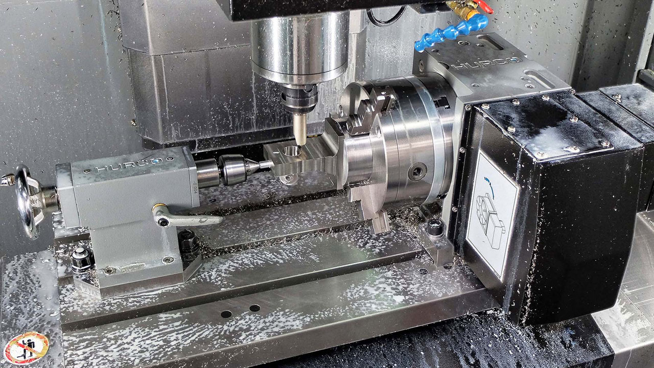

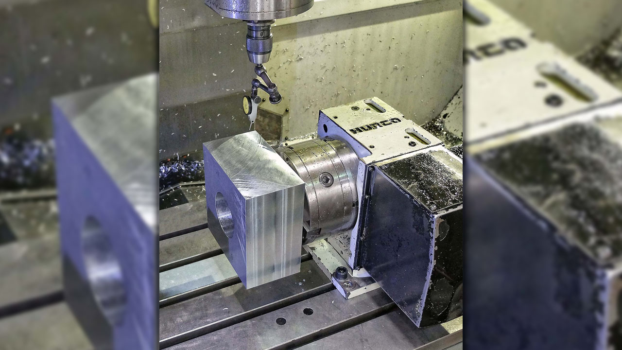

“We use our Hurco 4th axis tables regularly to gain access to parts for machining on multiple sides, hopefully in one hit. We position them individually with or without a tailstock, or alternatively mount multiple parts on a trunnion for indexing. Sometimes we machine components requiring full simultaneous 4-axis cycles.”
