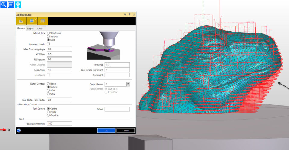

Additive Cycle:
EDGECAM 2020.1 enhances the Additive Lace cycle’s ‘Undercut’ function, by allowing the user to set a maximum overhang angle. Product Manager Manager John Buehler says: “This is necessary because different materials and processes require different negative material build-up, depending on the target shape. If the undercut angle is too big, it can be compensated for by using the maximum overhang angle, effectively over-ruling the angle on the part.”
Additionally, further ‘boundary control’ options have been included, which mimic the same functionality of other milling cycles, allowing for greater material displacement control.
