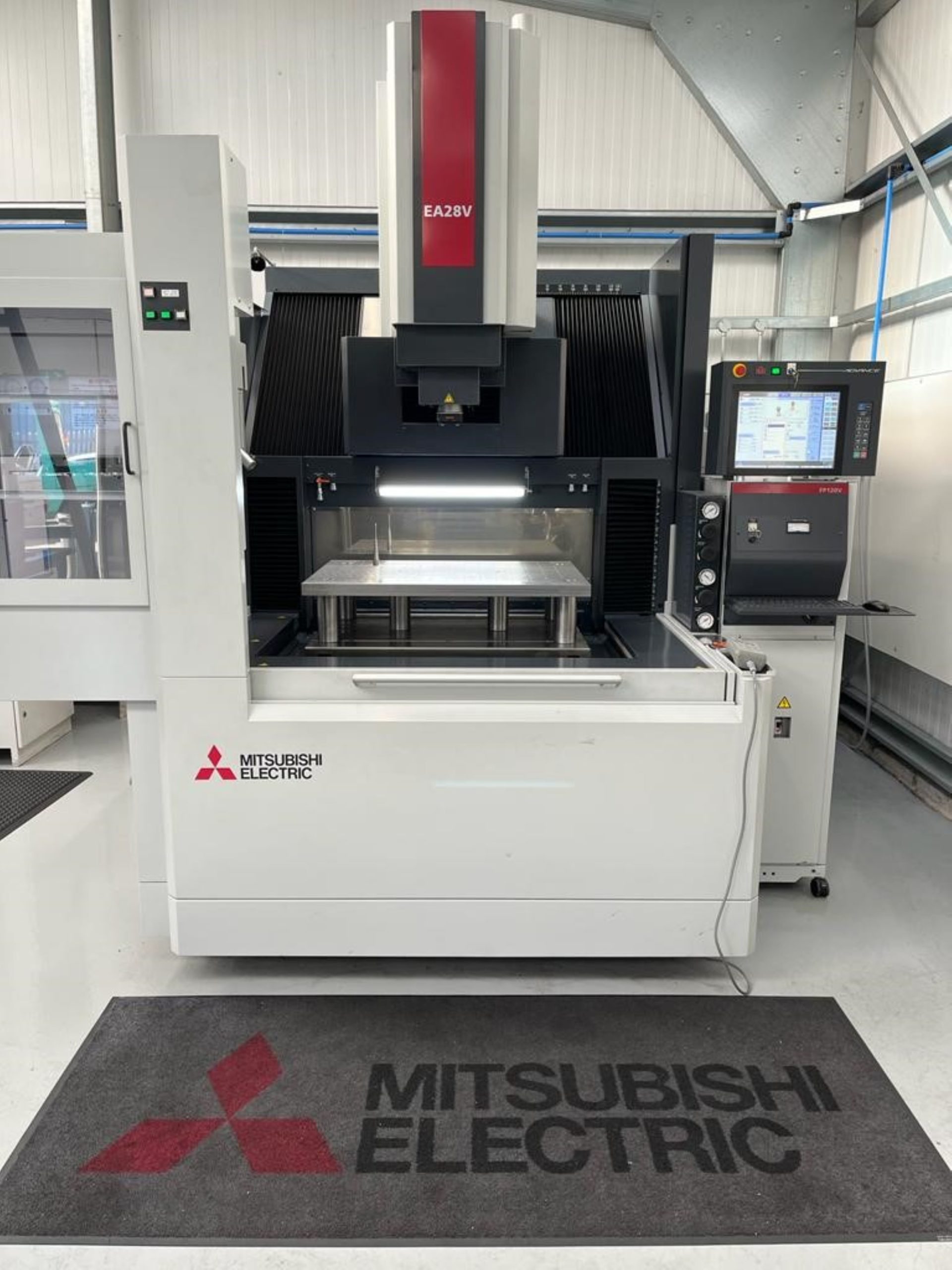

With customers in the high-end automotive and medical industries ramping-up production post-Covid, Denmark needed to invest in a larger capacity spark erosion machine. With three ageing spark erosion machines already on site, Denmark needed a machine with a larger bed and tank capacity for processing the increasingly larger dimensions of automotive interior trim parts and large white goods injection mould tools. Despite having spark erosion machines from several different vendors on-site, the service provided by ETG with the MV1200S was a major factor in why the company invested in a second Mitsubishi machine.
As Mark continues: “We did our due diligence and looked at spark erosion machines from a few leading suppliers. Once we identified our capacity needs, it was the technology, capability, reputation for quality and impeccable service levels from ETG that were the main factors in our decision to buy a Mitsubishi EA28V Advance spark erosion machine.”
The Mitsubishi EA28V Advance can accommodate maximum workpiece dimensions up to 1350 by 850 by 450mm in its 390 litre capacity tank that utilises an automatic elevation method. Capable of accommodating electrodes up to 200kg and workpieces up to 2000kg, the Mitsubishi EA28V is a powerful workhorse with technology that delivers finesse for the highly productive processing of components of unsurpassed precision and quality. Discussing this spacious work area, Mark adds: “We’ve been increasingly receiving requests for larger components that had to be externally produced, as our spark erosion machines were not big enough. This resulted in external subcontract costs that were a drain on our business and extended our lead times. With the arrival of the Mitsubishi EA28V, we have brought all of this work in-house – reducing both our costs and lead times.”
However, the Mitsubishi EA28V Advance has given Denmark so much more, as Mark continues: “The extra capacity not only allows us to process larger parts, it also enables us to put two or three different smaller jobs on the bed and run them consecutively. This means we can undertake lights-out machining, and in many instances, we can set the machine up on a Friday night to run all weekend unmanned. This is a huge saving for our business. The ability to run up to three different components on the machine consecutively is a credit to the 20 electrode tool change facility an intuitive programming technology on the Mitsubishi EA28V.”
“Our existing spark erosion machines only have single-electrode capacity, which means that we would continually change electrodes for every operation and part. With the Mitsubishi EA28V, we can set up to 20 electrodes, and program several parts – and the machine will run for a couple of days unmanned. This is a huge saving for our business. From a productivity perspective, the technology in the Mitsubishi EA28V means that we can adjust our settings to erode components at higher speeds and feeds or we can similarly slow the speeds to extend the life of electrodes or improve surface finishes. Regardless of the multitude of settings, the machine can process parts far faster and to a higher level of quality and precision than any of our other spark erosion machines,” says Mark.
This is reducing energy consumption and costs for Denmark whilst simultaneously reducing consumable costs. Another advantage for the small business is the reduction in hand polishing, as Mark adds: “Our existing spark erosion machines are typically generating a surface finish in the region of 24VDI (1.6Ra), which often requires considerable post-machining hand polishing. This is particularly the case for injection mould tools for interior vehicle trim components that are used in marque vehicle brands and medical mould tools for containers and spoons. With the new Mitsubishi EA28V, we are easily achieving surface finishes of 12VDI (0.4Ra), which has drastically reduced our hand finishing. On some parts such as ribs and cavities, the high level of surface quality has eliminated hand finishing, which is a necessity for sensitive features. Overall, bench finishing has massively reduced, freeing up hours for our machinists every week.”
