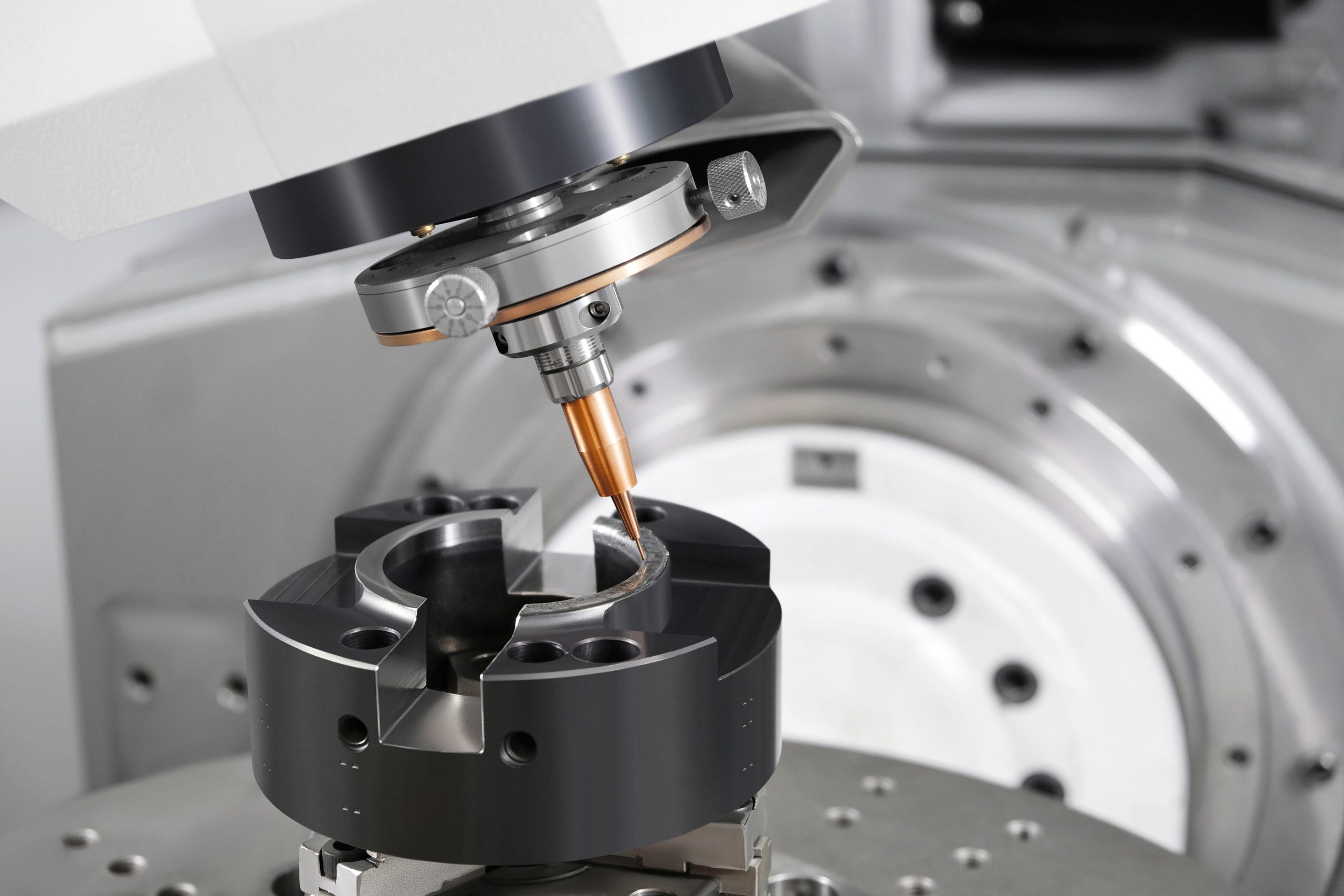

In terms of economic and ecological sustainability, the call to repair rather than produce new is correct and forward-looking. When it comes to repairing moulds and other components instead of producing new ones, laser metal deposition (LMD) is a proven key technology – with a growing potential for new areas of application. At the recent ‘reFORM’ workshop, which was part of the CHIRON Group’s 2022 Open House event – the automation of LMD repair processes took centre stage. This groundbreaking technology is now available in the UK from the Engineering Technology Group (ETG), and for manufacturers that implement it, they can save time, costs and act extremely sustainably.
It’s actually like machining, only LMD works the other way around. Instead of removing material, it is applied. Using powder or wire, or both in combination. What is feed and depth of cut for one is deposit rate and layer thickness for the other. Where one cools his workpiece, the other heats it. Either way, the component has to be produced with the required quality and cost-effectiveness with the additional criteria of being energy-efficient and resource-saving.

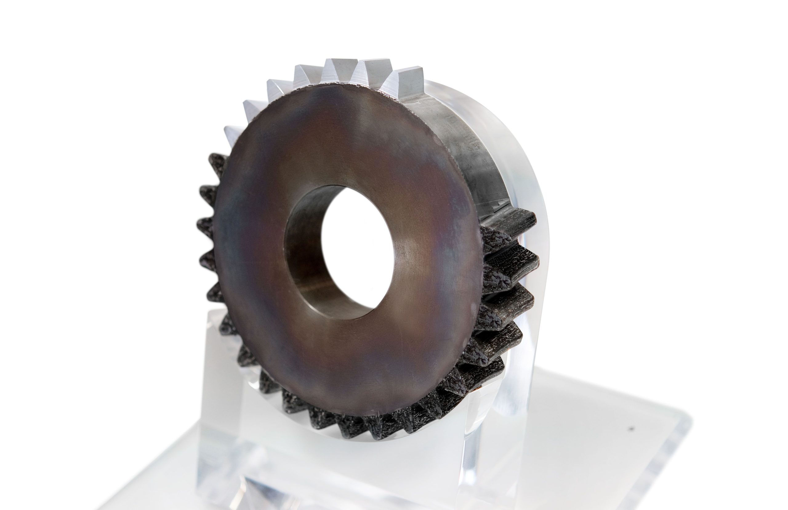

LMD was represented at the CHIRON Group’s ‘reFORM’ workshop in Tuttlingen where Cedric Bardenhagen, Key Account Manager at Siemens AG, gave a very clear picture of the motivation to face this challenge in his lecture. He discussed a newly produced gear wheel with a diameter of 500mm and a weight of 230kg that requires almost 2,000kW /h throughout its production chain. That’s 90% of the energy for steel production and forging the mould, and the remaining 10% for machining and post-processing.
In comparison, a gear wheel made from recycled steel uses ‘only’ 39% of the manufacturing energy. If you now repair such a wheel with an automated LMD process, you only need 17% of the energy of a new wheel, or 42% of a recycled one, to get a wind turbine running with these components. In short, repairing with additive manufacturing is highly positive for climate balance.

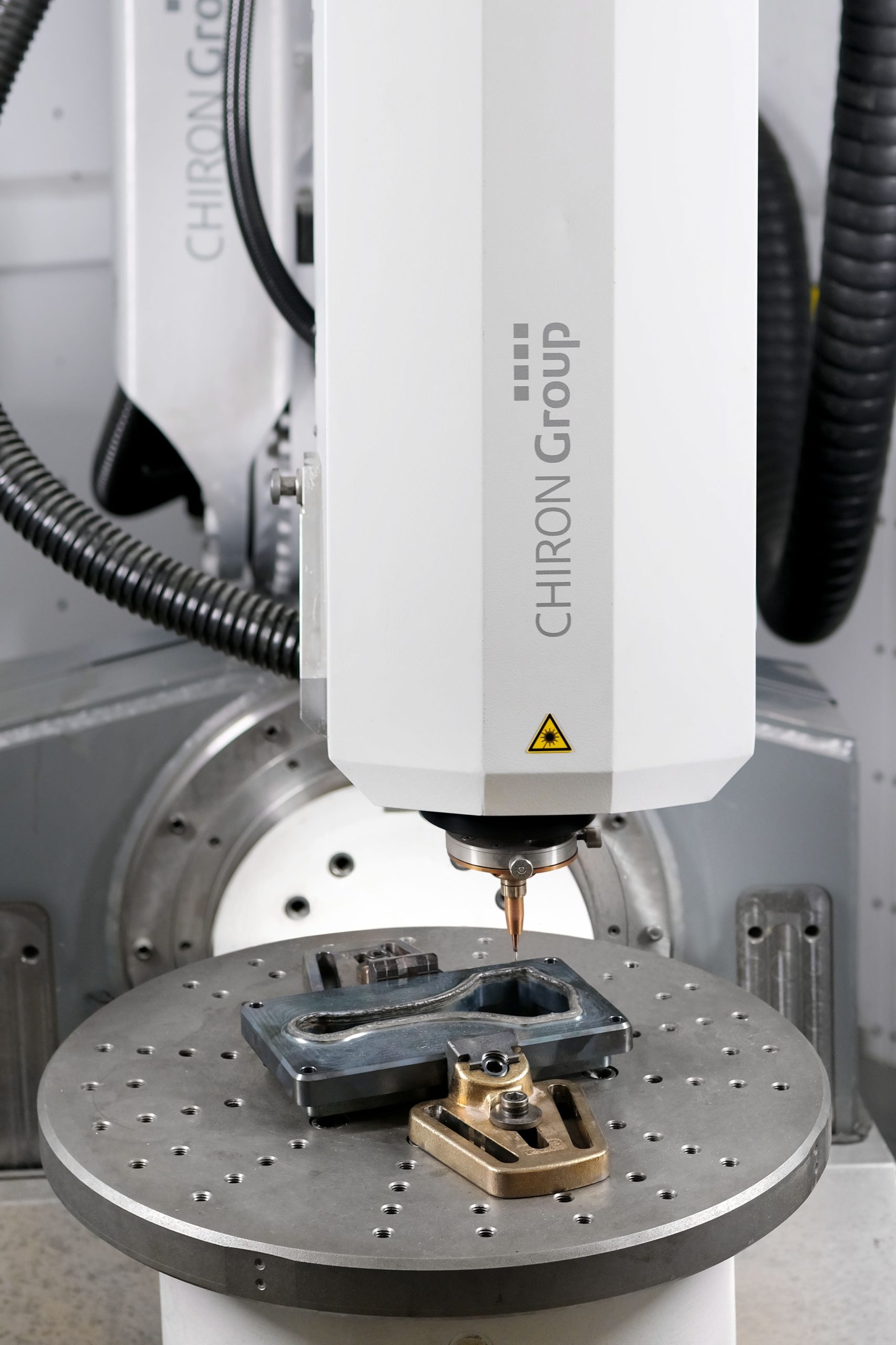

Multifunctional system for automated LMD process
The CHIRON Group Additive Manufacturing team used this highly specialist knowledge of material properties in welding processes to develop the AM Cube. With today’s very large variety of materials, the flexibility of the system is an important criterion for an automated LMD process. With so many shapes and contours and so many materials used in daily practice, it makes sense that the system can be changed easily and quickly. Powder is the preferred welding material on the one hand, and wire on the other – the user has all the options.

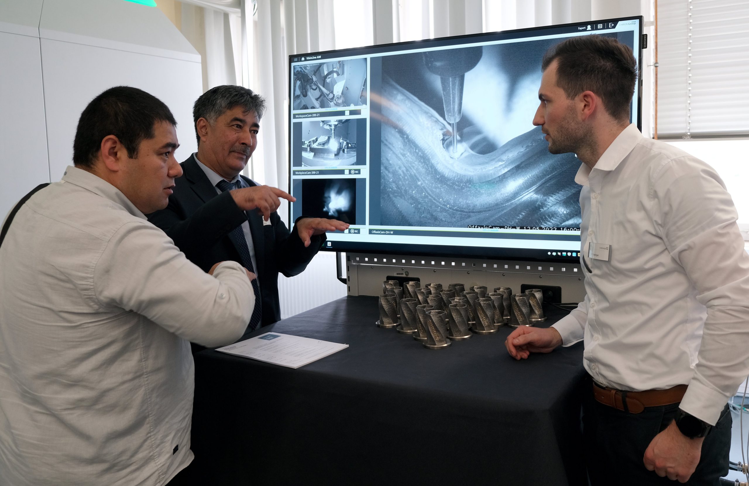

Data also plays an important role during machining. All relevant process data is recorded via two new digital systems from the CHIRON Group. The Via DataLine AM permits all relevant process data to be continuously displayed live, recorded and documented in a compact quality report. Product and process quality can thus be reliably assessed. The VisioLine AM system visualises and saves video files that are captured by multiple camera systems. Once parameters and tolerances have been entered, they serve as a reference and in the event of deviations, you can take immediate, targeted action.
