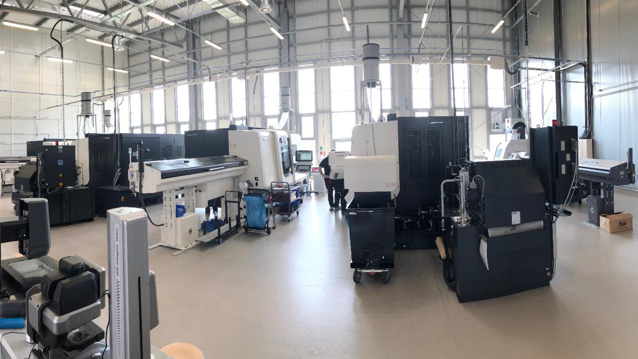

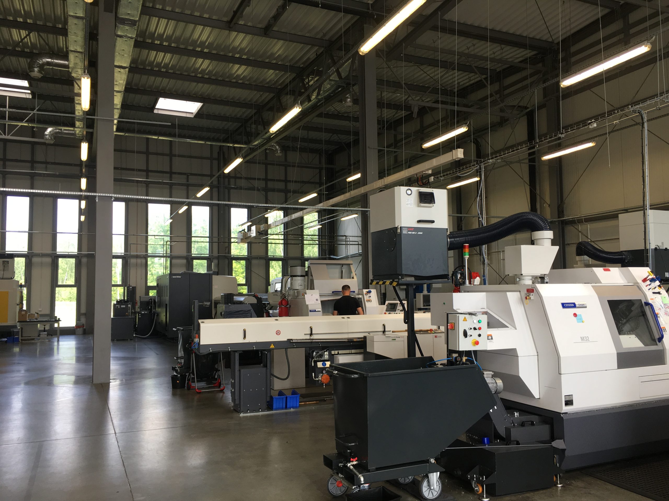

JPB Système works mainly on DMG Mori production turning centers. NZX1500/200, which, in addition to turning, enable advanced milling operations. The company’s machine park also includes lathes by Okuma and Nakamura-Tome, multi-axis longitudinal machines by Citizen, 3-axis milling centers, and a FANUC ROBODRILL 5-axis center.
JPB Système embodies the concept of Industry 4.0. Equipped with six DMG Mori centers, one of their production lines is fully automated and features an artificial intelligence system. The line is integrated with measurement systems after armament production is completely autonomous.

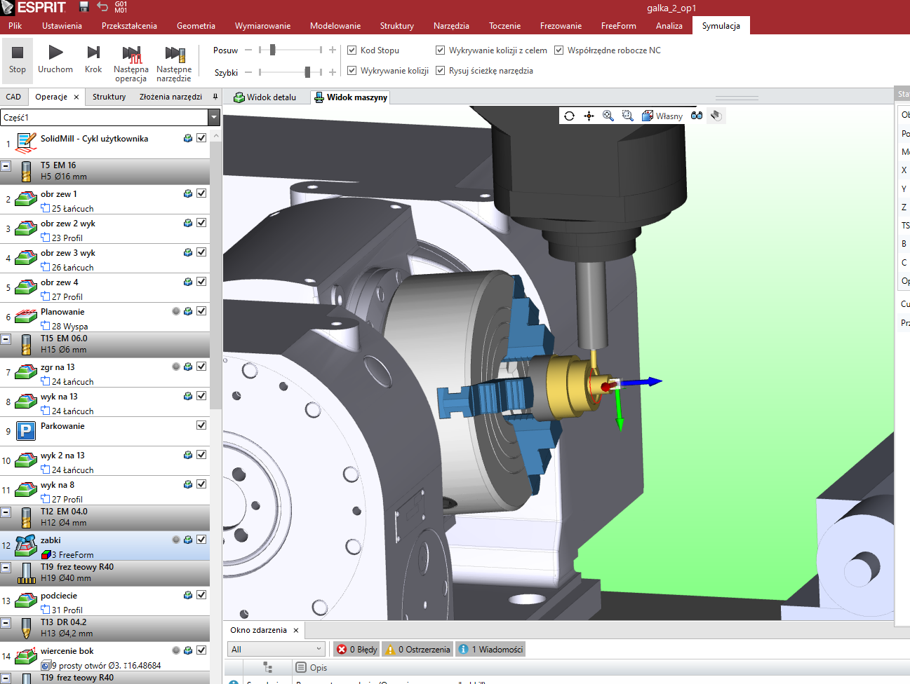

JPB Système’s French location has been using ESPRIT software to prepare turning and milling programs for many years. At the Polish location, the software was implemented in 2019 and allows users to comprehensively operate the entire machinery park.

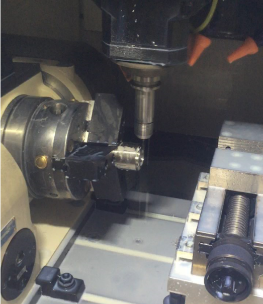

ESPRIT is primarily used for programming 3-, 4-, and 5-axis milling operations on the FANUC ROBODRILL machine in the R&D department. Most of the designs are prototypes of numerous new ideas and products. The complexity and variety of these designs is relatively large, and the degree of complexity is high—especially because these structures have not yet been optimized.
JPB Système places much emphasis on quality and standard of finish. Prototype parts, processed with ESPRIT, are presented to the client for their own internal tests.

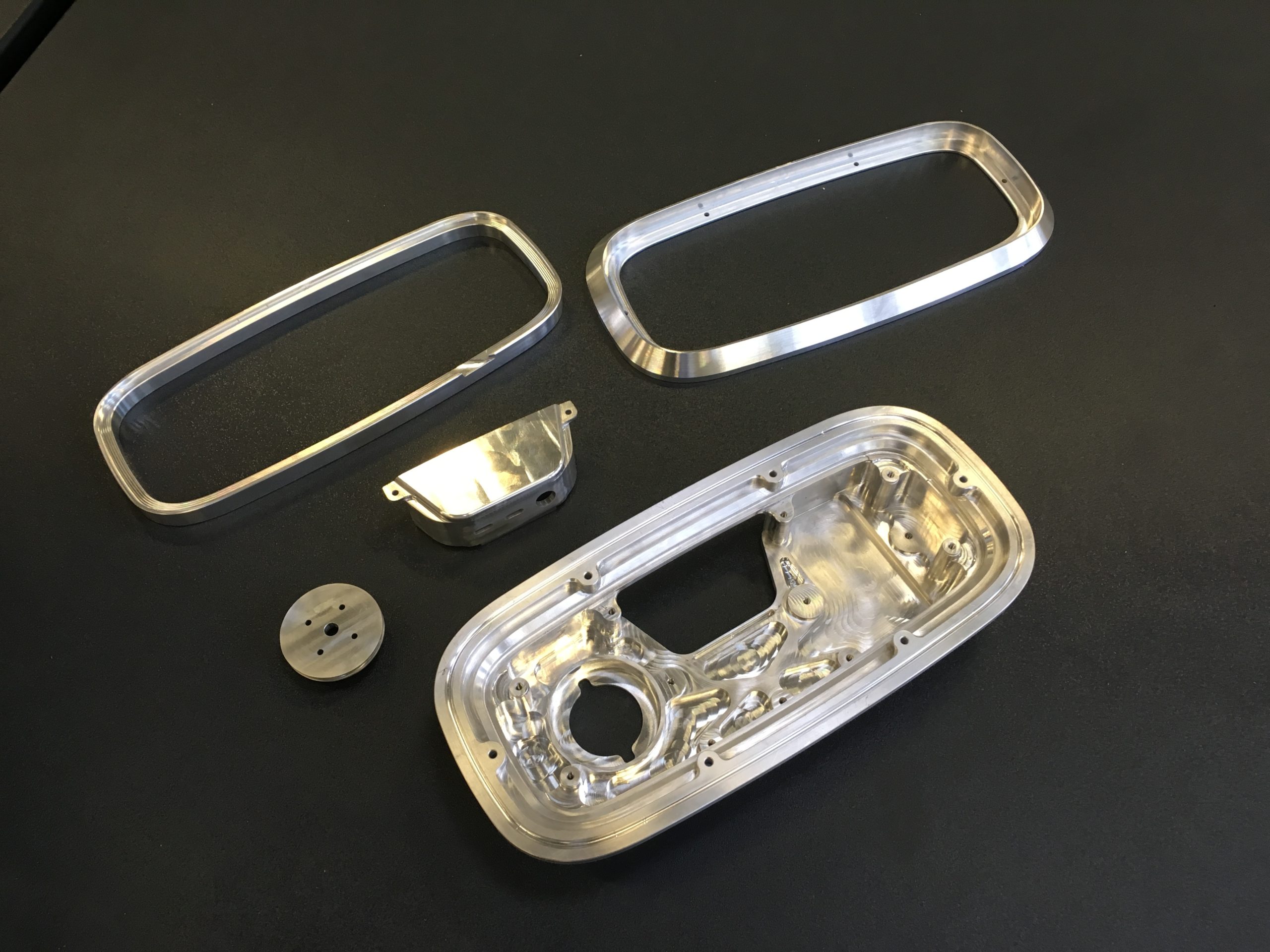

JPB Système uses various materials including stainless steel, aluminum, plastics, Inconel, brass, and carbon steel using the full catalog of tools (including T-cutters and torus, boring bars, and special tools).
One additional challenge is the need to mill axisymmetric elements, such as lathes, where relatively easy, smooth, and continuous contour turning sometimes requires the use of all tools and kinematic capabilities of a 5-axis milling machine.

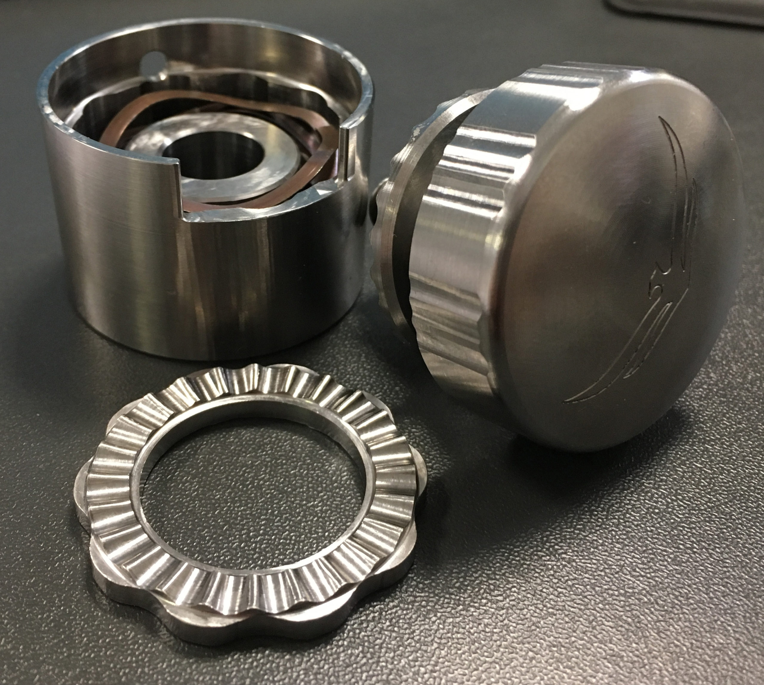

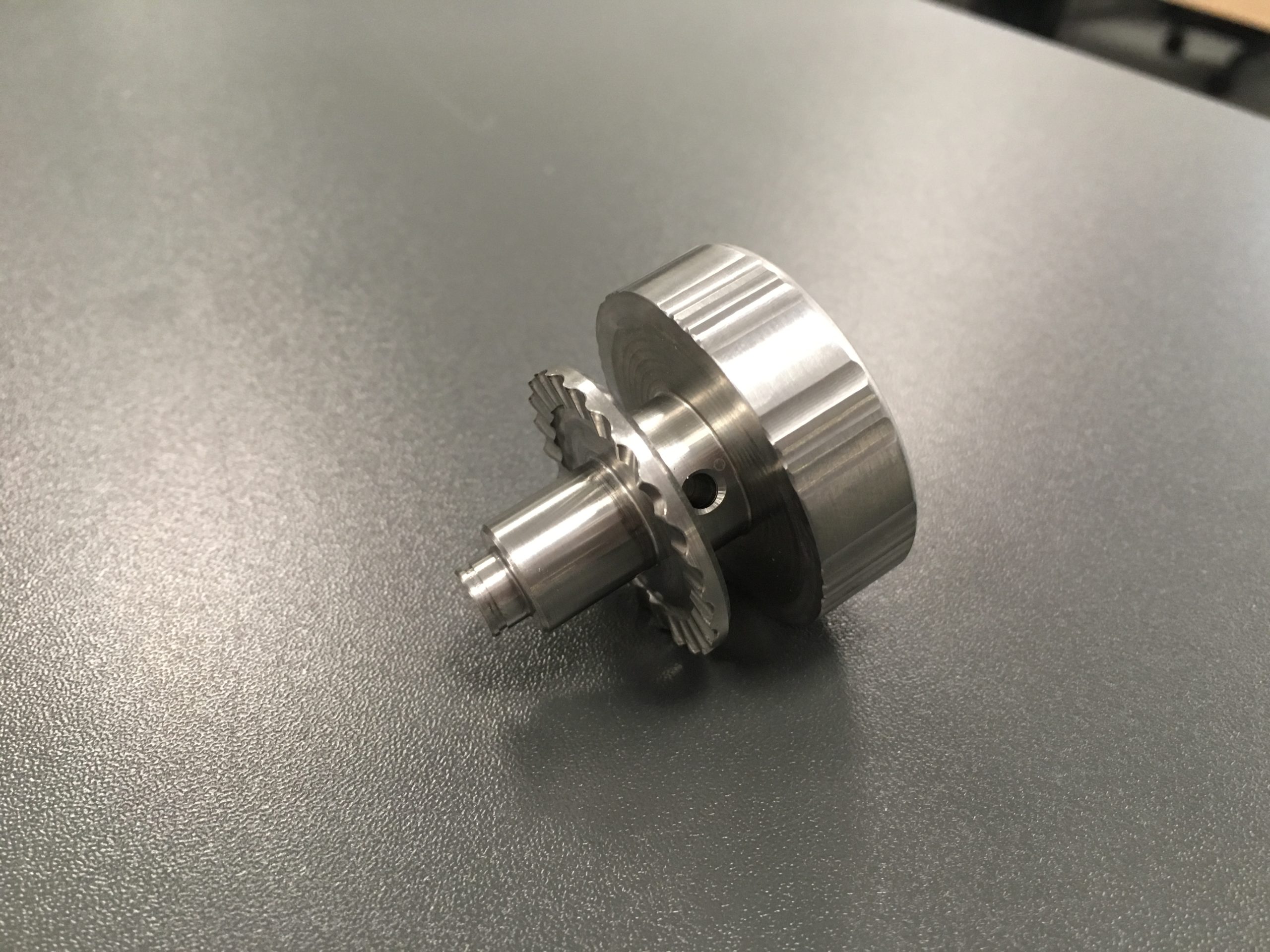

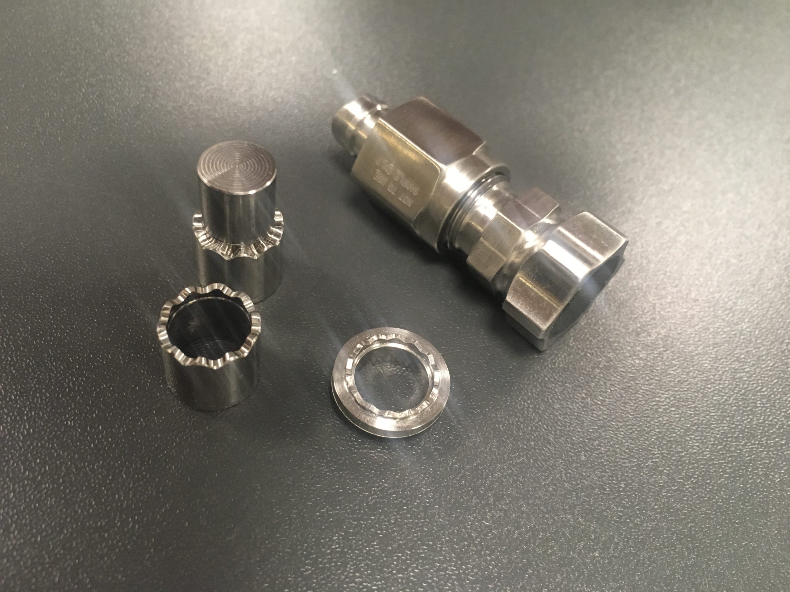

One of the last products, the machining of which was modeled in ESPRIT, is a special tensioner of the tendon, equipped with a self-locking mechanism. Although the details of this device are produced on turning centers, the first prototypes were modeled and made on a 5-axis milling machine, exceptionally milling surfaces that are normally turned.
In addition to basic milling operations, machining a detail required the use of a 5-axis swarf operation, global finishing, and multi-axis contouring.
The program enables the effective use of all possible machine tools, along with an accurate virtual simulation of the machine and its equipment: instrumentation, tools, and axis kinematics.
The generated code is optimized for the machine tool and does not require subsequent editing on the machine controller. Significantly, this reduces the risk of a collision and accelerates its work.
