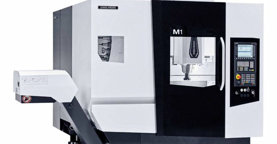

Global machine tool manufacturer DMG MORI has entered the vertical machining centre (VMC) market at the lower end of the price range with a new, nominally half-metre-cube model, the M1. Costing £54,000, it is the least expensive machine in the company’s portfolio and offers small job shops and subcontractors the opportunity to access equipment from this premium manufacturer. Built at the group’s factory in Poland, it is sold in the UK through Coventry subsidiary DMG MORI UK (https://uk.dmgmori.com)

As to the machine itself, there has been no compromise on build quality. Occupying only six square metres on a shop floor, it is constructed on a 2,400 kg, monolithic, thermally stable bed casting that allows high metal removal rates combined with supreme accuracy and surface quality of machined components.
Axis travels are 550 x 550 x 510 mm and at 850 mm, the length of the fixed table is much longer than the X-axis stroke to allow for considerable component overhang. Table width is also generous at 650 mm and maximum load is 600 kg.
BT40 (or SK40) tools are exchanged from a 24-station magazine by a twin-arm ATC into the direct-drive, 9 kW / 43 Nm spindle, which can have a maximum rotational speed of either 10,000 or 12,000 rpm. 20-bar through-spindle coolant is optional.
Control is by a SIEMENS 828D and programs are fully compatible with the 840D CNC system. NC cycles generated by a CAM system can be easily imported and a DXF reader is available, as is the Siemens ShopMill user interface. Cycle simulation, Advanced Surface and DMG MORI’s proprietary NETservice 4.0 (https://uk.dmgmori.com/service-and-training/customer-service/netservice) are all included.
