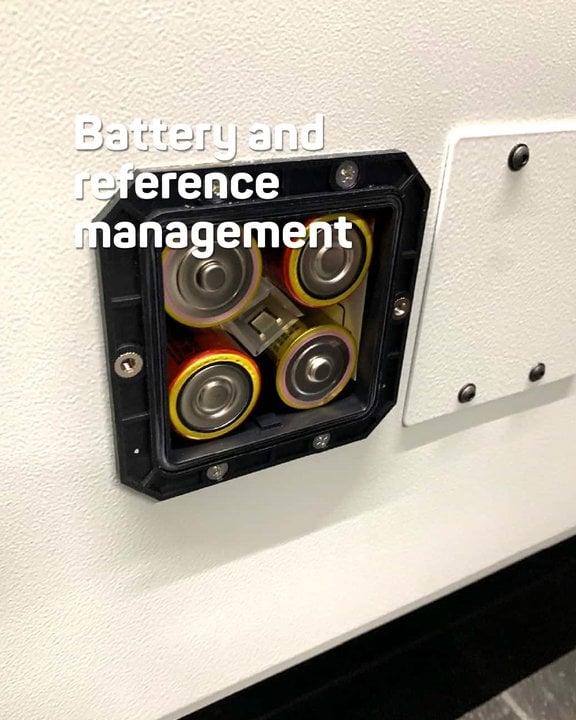

Firstly, CMZ advises on the importance of battery and reference management. Extended shutdowns can lead to battery depletion, resulting in the loss of machine references. This makes restarting the machinery post-holiday a complex task. By replacing batteries and setting axes in the reference position before stopping production, companies can prevent “loss of zero” errors and ensure a smooth start-up.

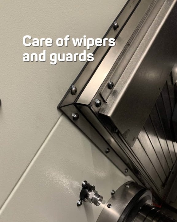

Secondly, the company recommends diligent care of wipers and guards. Fine swarf accumulation can damage crucial components like guideways and ball screws. Regular cleaning and maintenance of the telescopic covers, along with keeping wipers in perfect condition, act as a frontline defence against potential damage.

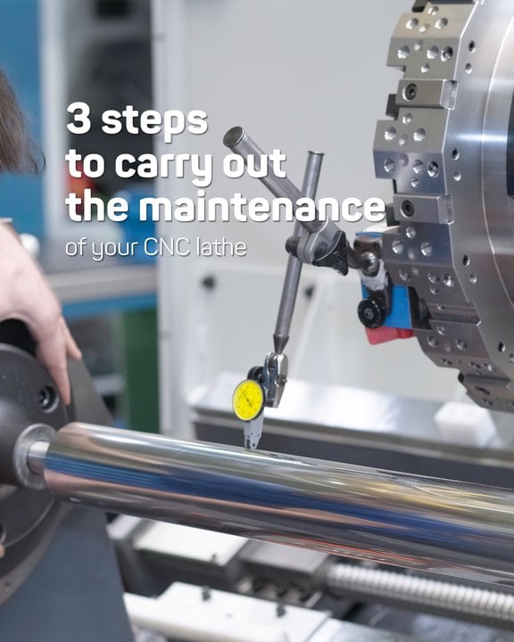

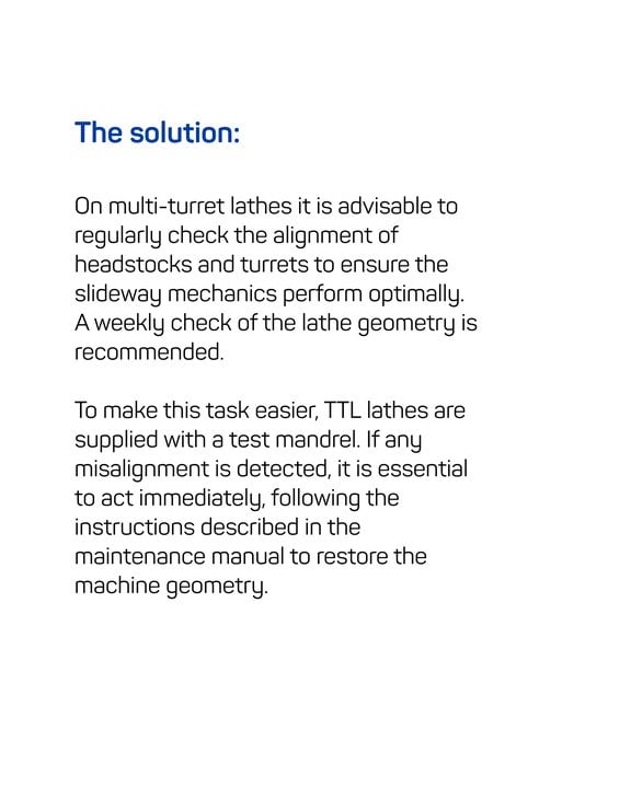

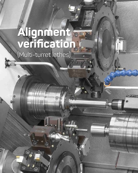

The third tip is the alignment verification for multi-turret lathes. Misalignments can result from collisions or extensive use, leading to stress on the X-axis ballscrew and bearings. CMZ recommends weekly checks of the machine’s geometry to avoid such pitfalls. For ease, TTL lathes come equipped with a test mandrel specifically for this purpose.
