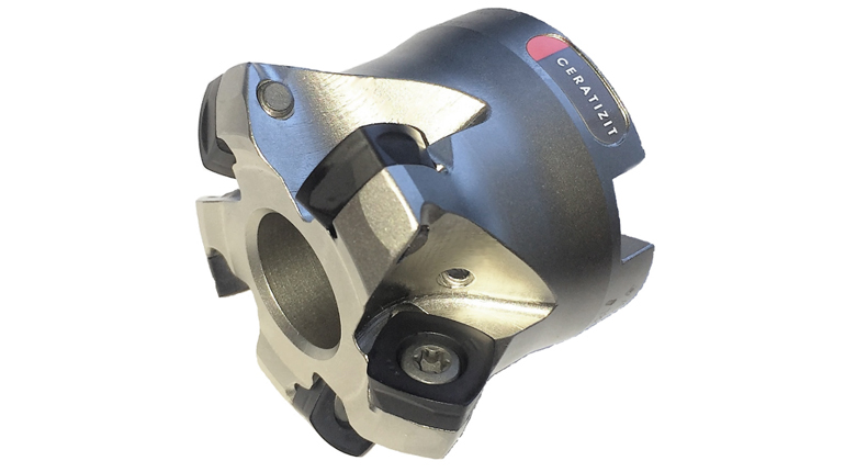

Traditionally button-style milling inserts have been the method of choice when it comes to rough machining turbine blades. Their one limiting factor has always been the achievable feed rates are relatively low for this style of insert. The development by Cutting Solutions by CERATIZIT, the competence brand for innovative tooling solutions at the CERATIZIT Group, of the MaxiMill HFC-TUR milling system has overcome this, achieving feed rates double those achieved with button inserts.
At the heart of the MaxiMill HFC-TUR is the insert itself, which comes in 09 and 12 mm sizes with four indexes per insert. With the larger of the inserts cutting depths up to 5 mm can be achieved and angled ramping of 2.6 degrees (2.3 for helical ramping) can be achieved. Process security is ensured by use of a larger than typical screw and, also the extensive mating faces in the insert pocket.
The insert design with its large effective radius makes it ideal for a variety of 3D machining applications and general face milling and its soft cutting action assists in the cutting of components with thin sections and large unsupported areas, such as turbine blades. A further advantage is that the MaxiMill HFC-TUR cutters can be used on lower powered machines, that would not be suitable for high-feed milling style cutters. The cutter bodies for the HFC-TUR series are available in sizes between 32 and 63 mm, with all dimensions matching the existing button insert cutters, ensuring that CAD programming is exactly the same. Cutter body life is extended by use of nickel plating and insert life is enhanced with through tool coolant on cutter bodies.

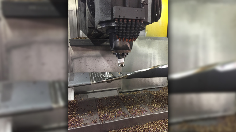

With depths of cut up to 5.0 mm and feedrates up to 1 mm/tooth the MaxiMill HFC-TUR cutters dramatically reduce cycle times, with Ceratizit’s M50 geometry enhancing these performance benefits. In a typical example, the machining of a forged turbine blade in Martensitic heat-resistant steel in unstable machining conditions (part clamped at both ends) using Ceratizit’s button-style cutters feed per tooth was 0.4mm, switching to the MaxiMill HFC-Tur system this was increased to 0.8 mm. In both cases the surface speed was 320 m/min and depth of cut 3 mm.
