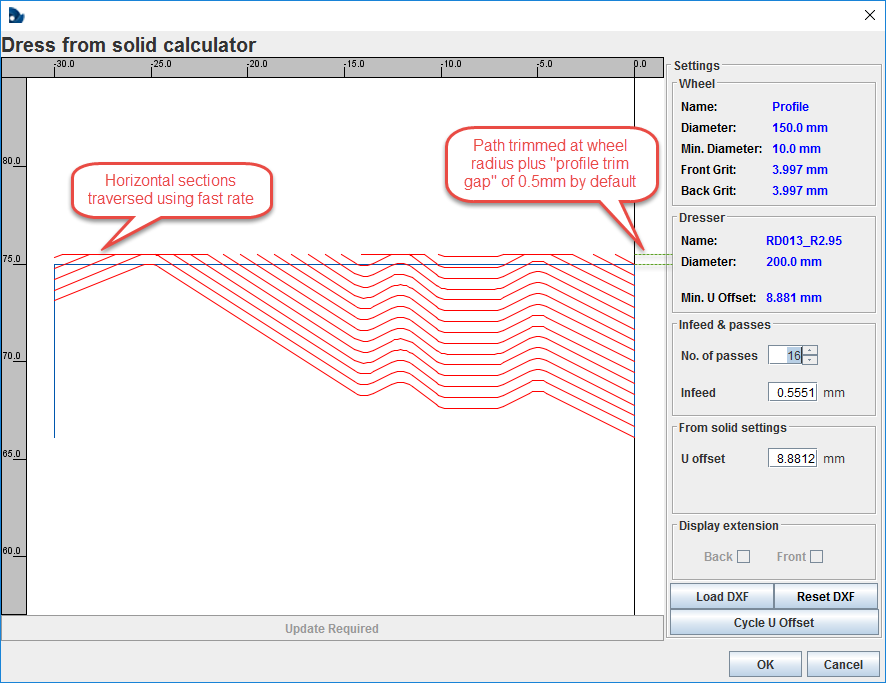

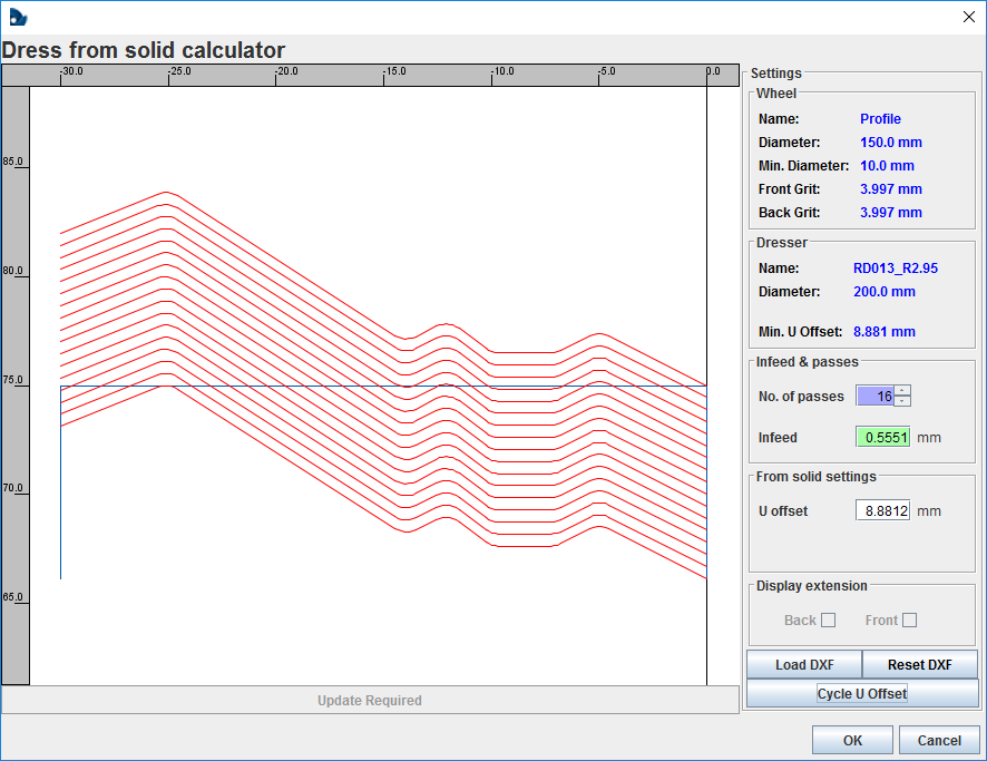

In the existing implementation of solid dressing, the final wheel profile is offset in the radial direction such that the first pass only dresses the wheel by the specified infeed per pass. This method results in a significant amount of dressing in air, where the dresser roll is not in contact with the grinding wheel as shown below. A particular customer request was to find a solution to reduce solid dressing cycle time.
The solution was implemented by trimming sections of the dressing path which lie above the wheel radius and increasing the feedrate of moves where the roll is not in contact with the grinding wheel as shown below.
This update is compatible with any machines with ToolRoom RN33.2 release onwards and has wheel dressing capability. This feature is available for all solid dressing surface types which includes form, periphery and segment dressing. Optimised dressing has replaced the existing implementation of dressing which will no longer be available due to the longer cycle times. Optimisations will automatically be calculated for dressing a profile onto a new or flat profile wheel and only air dressing beyond the wheel radius will be optimised.
The update with the above optimisations can be utilised in many applications specially taps, punches, and key hole punches.

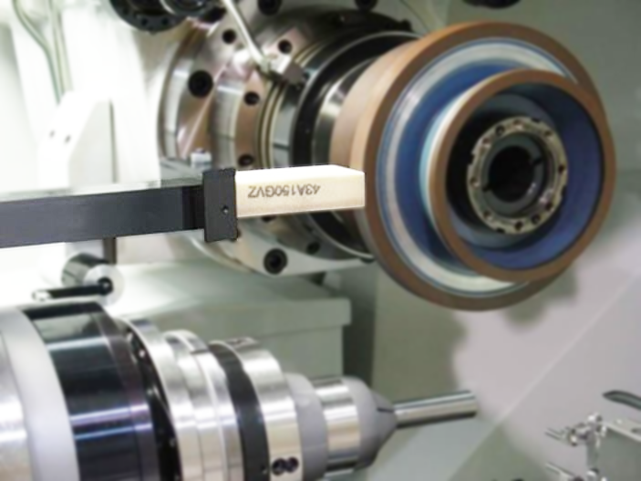

Flexible options for automatic white-sticking
Autostick software enables the automatic white-sticking option within the dresser software. This allows automatic sticking of grinding wheels. The sticking process is easily configured using the dressing software so that sticking can be performed as part of, or separately from a dressing operation.
This software requires a white-stick fixture to be present within the machine. This feature is supported on the FX, MX and TX range of ANCA Tool and Cutter Grinding Machines. Some machines even have the option to have up to four dressing sticks.
