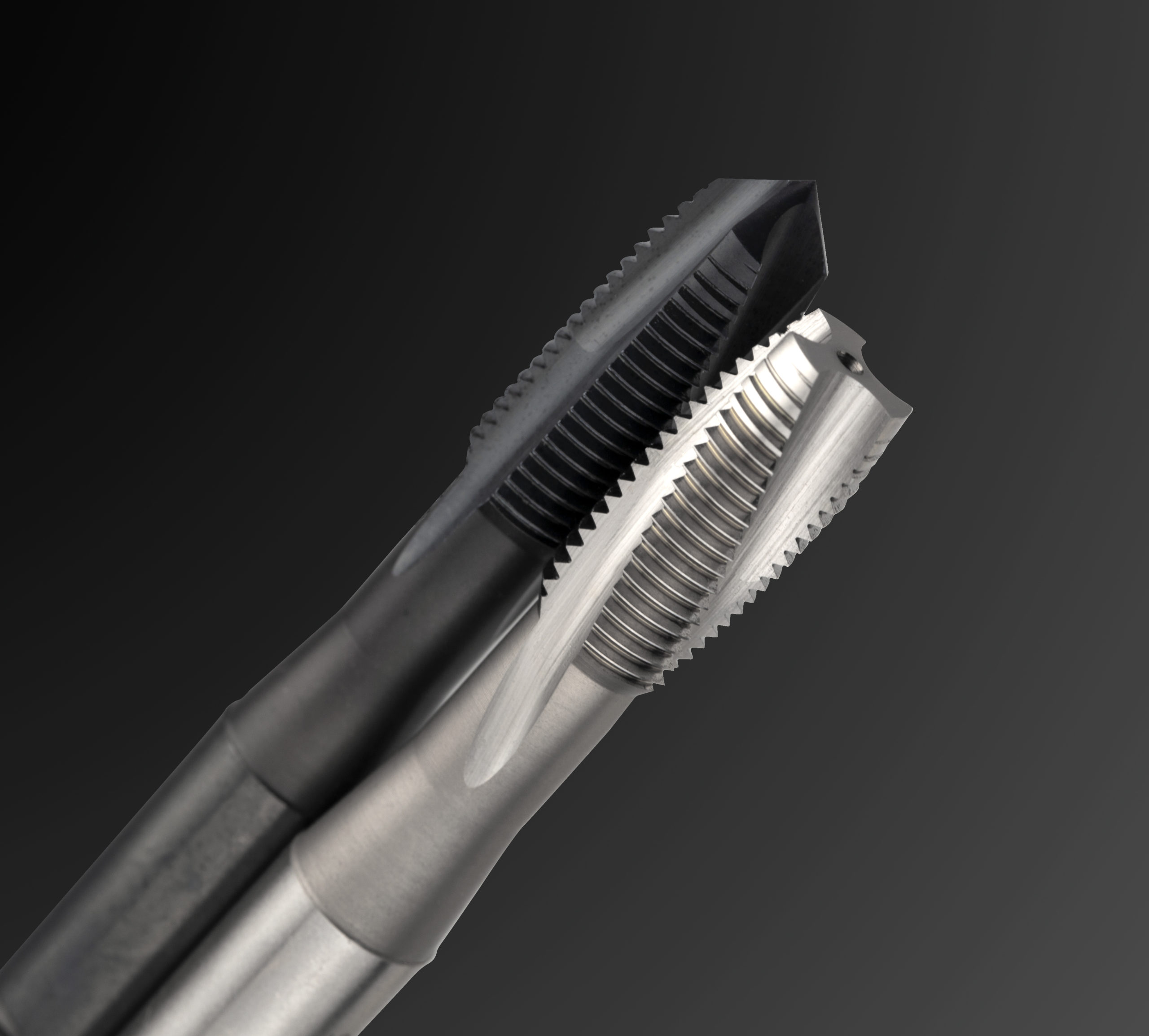

In stainless steel applications, galling is a common problem and one of the common causes can be related to thread roughness. This often impacts the nut and bolt coupling and occurs more frequently in the case of rough thread flanks. Bolt threads are primarily rolled to demonstrate smoother and stronger thread flanks than nut threads that are machined. The use of worn taps or a tapping process conducted incorrectly will lead to poor internal thread quality, a key factor in causing galling.
Aware of such problems, Yamawa has focused upon cutting-edge geometry and surface treatment. The result is the ZELX, a dedicated line of taps for the aerospace industry that overcomes the most common issues, including galling. The ZELX line of taps has been designed for heat resistant alloys and titanium alloys and the range comprises ZELX SS (UN/UNJ threading of stainless steels), ZELX NI (UN/UNJ threading of Ni-based alloys such as A286, Inconel, Hastelloy, Waspaloy), and the ZELX TI for titanium alloys.
ZELX SS taps for stainless steel are made of custom-blended vanadium high-speed steel that maximises wear resistance. The special design of the cutting edge and the surface treatment are enhanced to extend performance. The ZELX NI and TI taps are made of premium PM high-speed steel for maximum wear resistance and performance at higher temperatures. The optimum flute design promotes smooth chip evacuation while the surface treatment prevents welding and enhances wear resistance.
These features give the ZELX line constant performance in terms of thread quality and extend longer tap life in all working conditions, even at higher cutting parameters.
