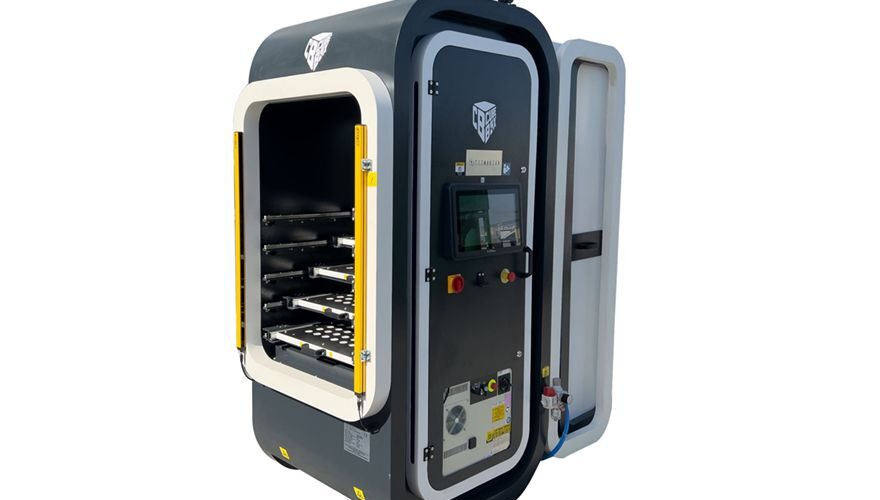

Tezmaksan, a leading European manufacturer of CNC automation systems, is set to exhibit its innovative CubeBOX Blues Space Cabinet at Global Industrie 2025, taking place from March 11 to 14 at the Eurexpo Lyon Exhibition Centre in Lyon, France. The CubeBOX Blues Space Cabinet is a compact and versatile robotic automation system designed to optimise CNC machine operations, and Tezmaksan’s French dealer, Mactech, will be demonstrating its capabilities at Stand 3A148.
The CubeBOX Blues Space Cabinet is engineered for efficiency and space optimisation, making it ideal for manufacturing facilities with limited floor space. With a compact footprint of just 2,150mm in width and 1,110mm in depth, the system integrates seamlessly into various production environments. Its automated drawer system, which includes three storage drawers, ensures continuous operation by enabling operators to load and unload parts without interrupting the production process.
Equipped with a six-axis robotic arm with a 7, 10, and 14kg payload capacity, the CubeBOX Blues Space Cabinet ensures precise and efficient loading and unloading of workpieces. The system is controlled by Tezmaksan’s RoboCAM+ software, which, in conjunction with an intuitive touch panel PC, enables easy setup and operation. Notably, no specialised programming skills are required, making it accessible for a wide range of operators.
The CubeBOX Blues Space Cabinet is designed for versatility, compatible with a variety of CNC machines, including lathes and vertical machining centres. Its adaptability allows it to support single-machine configurations, making it an ideal solution for a broad spectrum of manufacturing applications.
