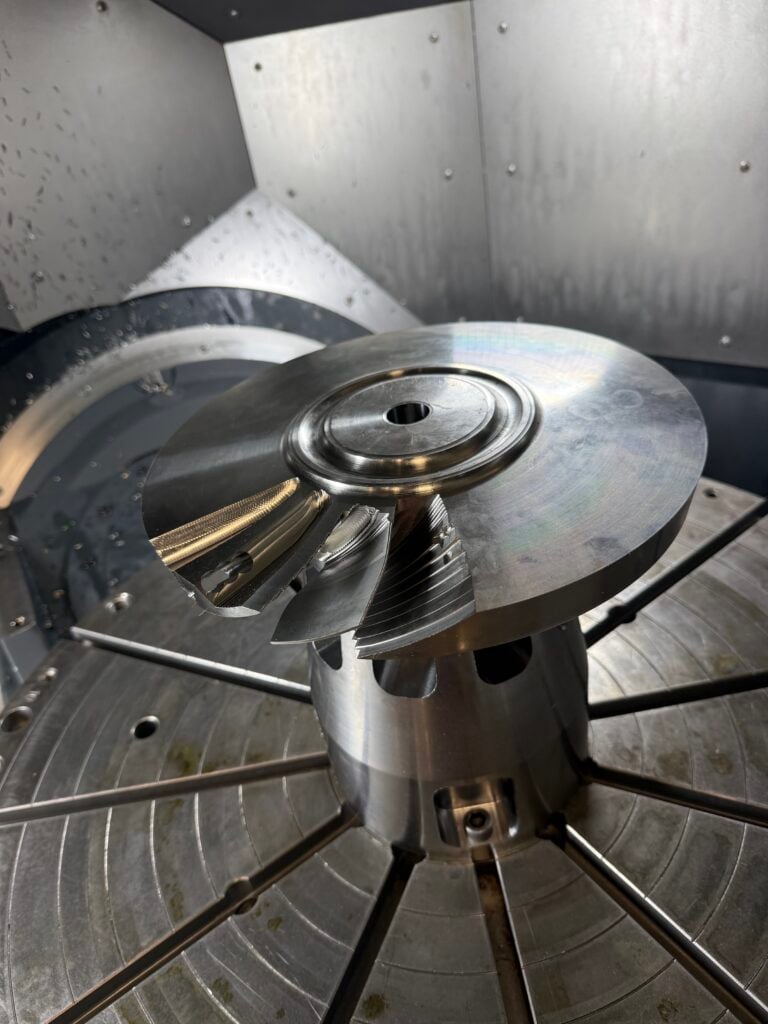

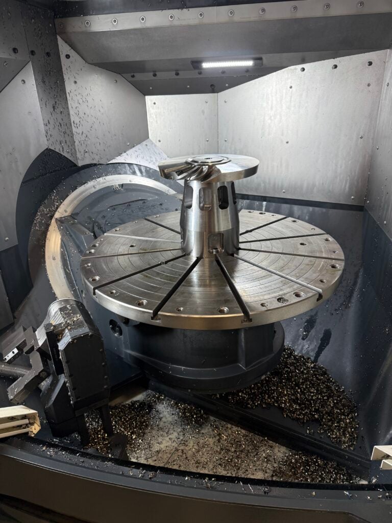

The demonstration centres around the machining of a highly complex aerospace blisk on a DMG MORI 5-axis machining centre. Components such as these demand absolute confidence in every stage of the programming and machining process, where even small improvements can deliver significant savings.

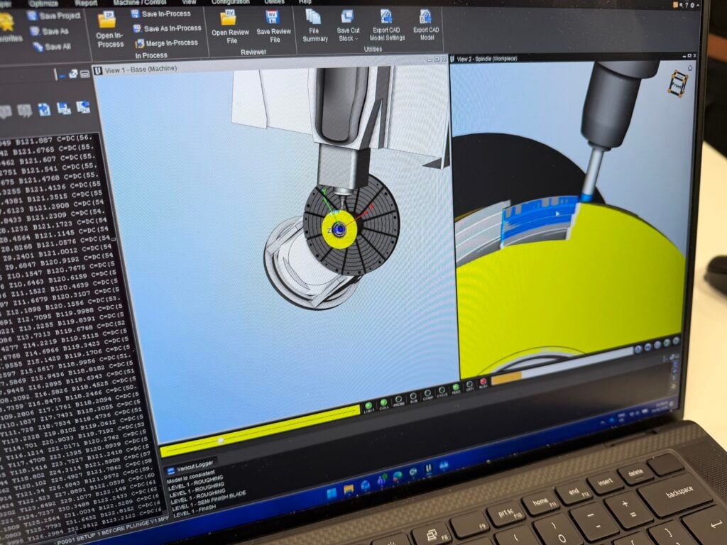

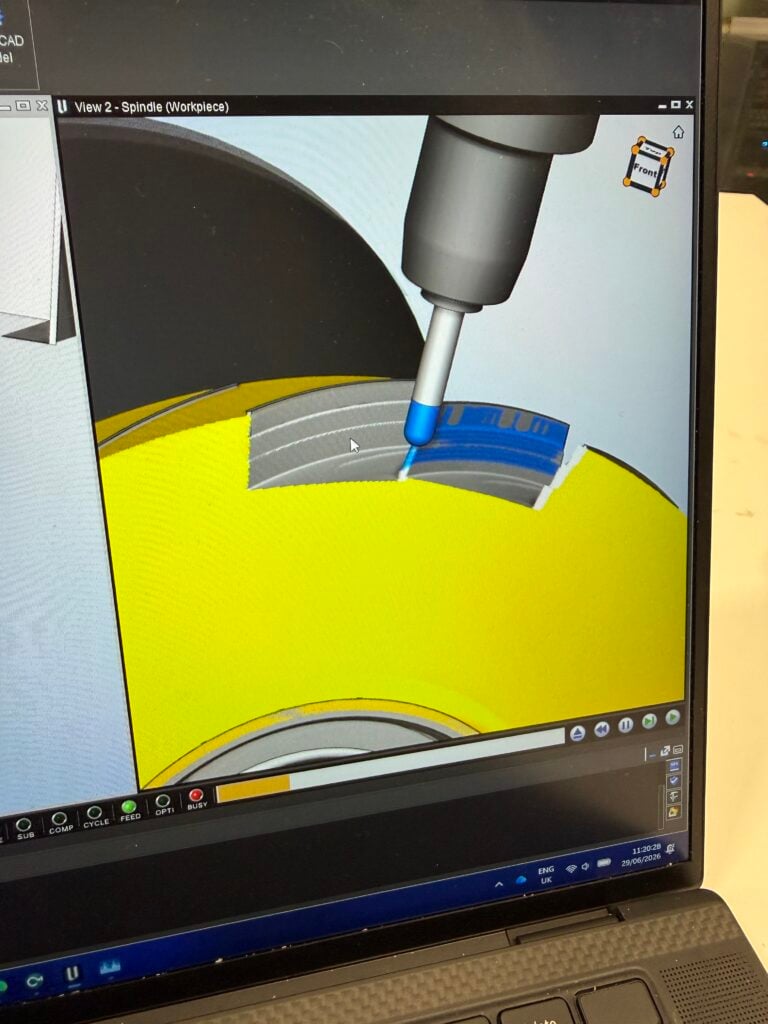

Once the NC program has been generated, the next challenge is ensuring it will run safely and accurately on the machine. This is where VERICUT comes into its own. Instead of spending valuable machine time proving out programs using single block and cautious first runs, VERICUT enables manufacturers to verify the complete machining process offline, giving programmers the confidence to release proven code directly to production.
The final stage is where the biggest productivity gains can often be achieved. VERICUT Optimizer intelligently analyses the machining process and adjusts feed rates to maintain optimum cutting conditions throughout the toolpath. The result is the potential for up to 20% faster cycle times on harder materials, while also improving tool life, reducing spindle load and lowering energy consumption.
