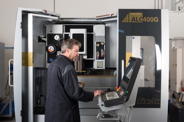

“We won an aerospace contract that in the first instance involved liasing with the customer to assist with the design-for-manufacture of stainless steel tooling that helps automate the coating of turbine blades,” explains Mr Fazekas. “From the outset it was clear that, due to the complexity of a key feature, wire EDM was the only way it could be made effectively and efficienty.”
Machining high-precision components and tools has been the mainstay for Promach 3D since the beginning. As the business has expanded so has the complexity of jobs, with the client list following suit. Promach 3D quotes on projects which other engineering companies tend to avoid, typically due to the challenging nature of the parts and materials to be machined.
The turbine blade root holder, as the part is known, is a case in point. An intricate fir-tree profile is the prominent feature of the tool, which is used to clamp the turbine blade into position at its root end, ready for coating.
As a company, Promach 3D has evolved over the years, from producing one-off jigs and fixtures, to small batch production and anything in between. This trend is predicted to continue, as evidenced by the root holders. The company is currently working its way through batches of 150-off, for three types of root holder, with more variants set to follow.
“We designed a fixture to EDM 20 root holders at a time on our new Sodick ALC 400G, typically running lights-out over a 12-hour cycle time,” says Mr Fazekas. “The AWT [automatic wire threading] technology of the Sodick machine is excellent, which means we can leave it to run assured of its reliability. If we need to run the machine over a longer unattended period, we can use the Sodick Jumbo wire feeder for a full weekend’s worth. To be honest, once set up and programmed, the machine just looks after itself, working quietly in the background. Also worth a mention is that the cutting speed of our new Sodick is faster than our six-year-old wire EDM, probably by at least 10%.”
Promach 3D, which is accredited to ISO 9001:2015, employs a one-cut strategy on the root holders, as the quality of the Sodick ALC 400G means a single cut is more than sufficient to meet the tool’s requirements for tolerance and form.
