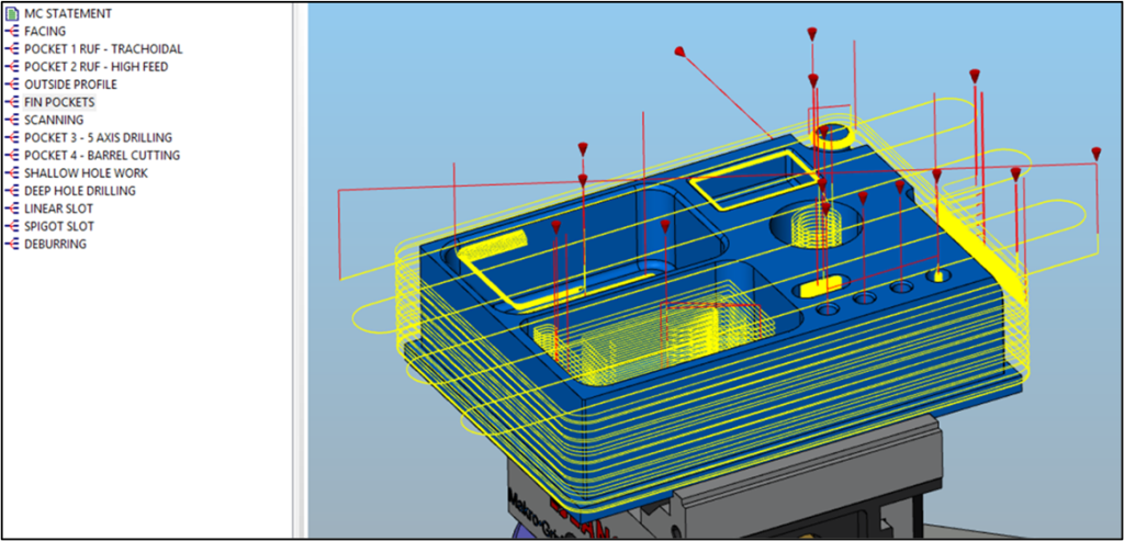

Just as significant for a shop running 18kW spindles on its Hermle C400 was hyperMILL’s trochoidal roughing strategy. “Instead of applying the force in one direction, as you would do a full-slot roughing in a straight line, by doing small circles, like a swirling vortex tool path, you’re distributing that load evenly around the spindle bearings,” Tom says. “You could see the load on the spindle was much lower, much calmer. We could either ramp up material removal rates at the same spindle load or reduce spindle and bearing stress. hyperMILL effectively bought Stoneswood spindle longevity at no productivity cost.“

“Automation finds the envelope size of the component, and then, using the ceiling functions I built in Excel for our matrix plates, it works out the optimal billet size to minimise wastage,” Tom explains. “It calculates the number of pockets and features, counts the drilled holes, calculates the material removal rate, looks at the relative size of the component using the data from our time study, then layers in complexity modifiers and material type. It builds the cycle time automatically with one button push.”

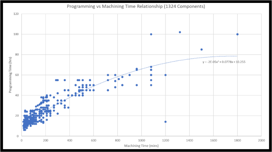

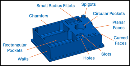

The methodology was underpinned by serious data work. More than sixty historical components were analysed for cycle-time and MRR behaviour, and a separate dataset of over 1,300 programming records was used to build a bespoke polynomial function that predicts CAM programming time from machining time. Validation took place on a Hermle C400 against a purpose-designed aluminium test part incorporating ribs, bosses, pockets, slots, chamfers and small radius fillets, the geometric vocabulary that statistical analysis had identified as the most common across Stoneswood’s quote pipeline. Stopwatch timing, CAM comparison and empirical cycle measurement confirmed the model held its ±10% accuracy target.
