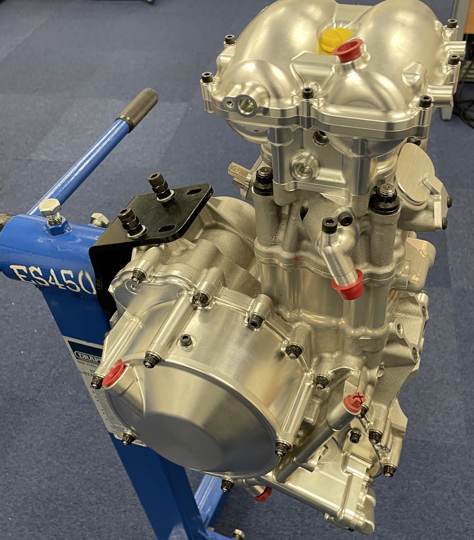

However, the bulk of the output focuses on high-end engine and gearbox components such as the head, block, bearing caps, inlet manifolds, covers and cases for a naturally aspirated niche V12 engine for supercars such as the Ferrari GTO. Nestled in the heart of the ‘motorsport valley’, the Northampton manufacturer has also designed, developed and manufactured a 250cc 4-stroke single-cylinder motorbike engine that conforms to the MOTO 3 rules and can compete in the MOTO GP Series.
Commenting upon the engine, Garry Edwards says: “We wanted to prove our capability by designing and manufacturing a MOTO3 engine, from the ground up. The 52 horsepower unit was trialled and tested on the track against Honda, national series specification and KTM previous year GP unit; the two leading powertrain suppliers in the class that had evolved their designs over years of development. Our very first engine without re-development work was faster than one manufacturer and slightly slower than the other – a great testament to our engineering expertise. Sadly, to bring a race engine to production requires huge financial support beyond the realms of a subcontract manufacturing business.”
