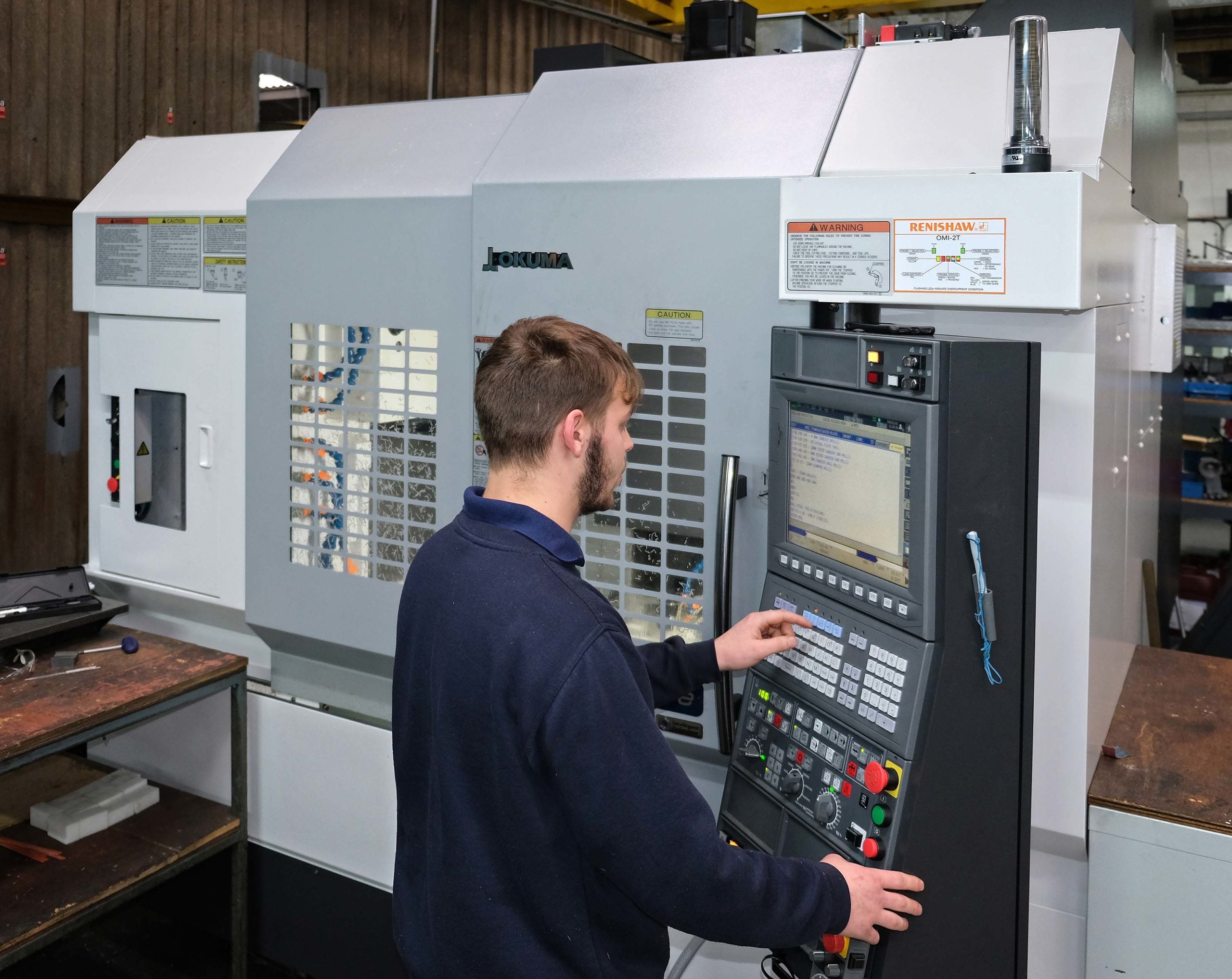

Mr Baines also commented that, despite being marketed as entry-level machines, Genos lathes and mills are impressively constructed and easily hold tolerances down to 12 microns. They are normally programmed conversationally on the shop floor at the proprietary Okuma OSP control using the manufacturer’s Advanced One-Touch IGF software. Complex routines are prepared off-line, if necessary, and the blocks inserted into the conversationally written program.

Favourable features of the Genos L300-MYW CNC lathe were listed as the 15 kW / 570 Nm spindle with three-year warranty, hand-scraped box ways, Y-axis travel of the turret and the provision of 12 driven tool stations, permitting one-hit production of complex components to reduce production cost and lead-times. A Hydrafeed bar magazine from elsewhere in the Oldham factory was retrofitted so that the machine is able to run unattended for long periods, including overnight.
