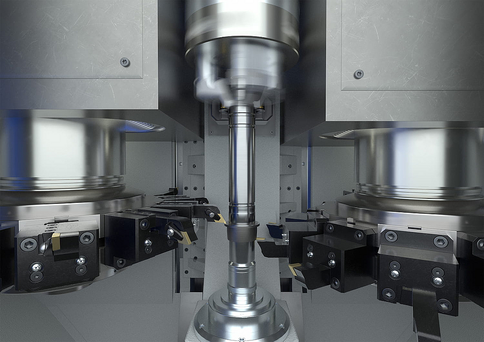

However, this is not the end of EMAG’s major e-mobility project for this customer, because the machine builders have also designed a solution for high-precision overturning of the rotor-sheet package using the VTC 200 machine. The so-called scroll-free turning process is used: here, a rolling motion of the tool takes place on the workpiece – an obliquely set CBN cutting edge moves over the rotating workpiece. The cutting edge engagement point moves on continuously. The whole process is around five to six times faster than conventional hard turning and up to three times faster than grinding. Despite this, the result is excellent quality without twist. In other words, surfaces that previously had to be ground can thus be peel turned in the future. This is an ideal solution for the stack of sheets surrounding the shaft.
