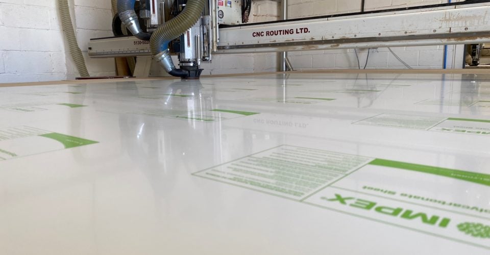

From a production perspective, the company has one AXYZ router with bed dimensions of 4880mm by 2635mm, and two further machines having a slightly smaller bed. This allows CNC Routing to place four 8 by 4’ sheets on the machine bed at any one time. “The large machine beds allow us to set up four parts at a time. Additionally, each machine incorporates a twin cutting head, which we can set at different widths. For the ‘sneeze sheets’, we have spaced the cutting heads at a distance of 1230mm apart, so we can cut two sheets simultaneously. With three twin-spindle routers running 24 hours a day, the performance and reliability of the ITC solid carbide routing tools is essential.”
ITC – Performance You Can Trust
Initially, CNC Routing Ltd placed an order for sixty 180-2362-10-E 6mm Clearcut Series single flute routers from ITC. Commenting upon the tools, Chris continues: “From experience, we know that these tools perform really well, have exceptional tool life and with the upward spiral flute geometry they are perfect for machining thin sheets without lifting from the vacuum bed. This confidence in the 180 Clearcut Series has been confirmed, as we have run the tools at 24,000rpm up to the full 6mm depth of cut at cutting speeds of 7m/min. These machining parameters are beyond the recommended cutting conditions, but extraordinary times call for extraordinary measures. Luckily, the quality of the ITC Clearcut Series can handle the increased speeds and feeds with ease.”
“Despite running at significantly increased machining parameters, the 6mm diameter tools can comfortably process more than 50 sheets before we have to change the tool. After cutting 50 sheets, the cutting performance and edge finishes are as good as they are on the very first sheet that we cut with a new tool. The only reason we change the tools after machining 50 sheets is because the protective film over the acrylic, PETG and polycarbonate ‘sneeze screen’ sheets begins to fray slightly and ‘fluff up’.
