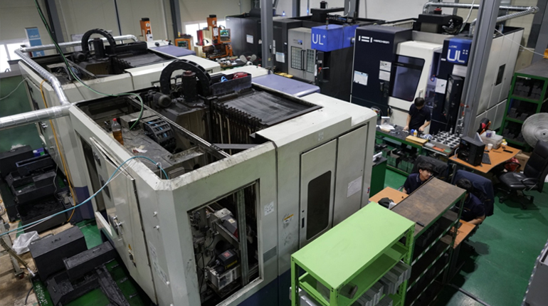

Since Polyhitech was established in 2007 the company has always looked to develop leading technology, and has invested in 19 machine tools covering the entire manufacturing process – mills for cutting the moulds, high-speed mills for machining electrodes and cores, EDMs, and injection moulding machines.
